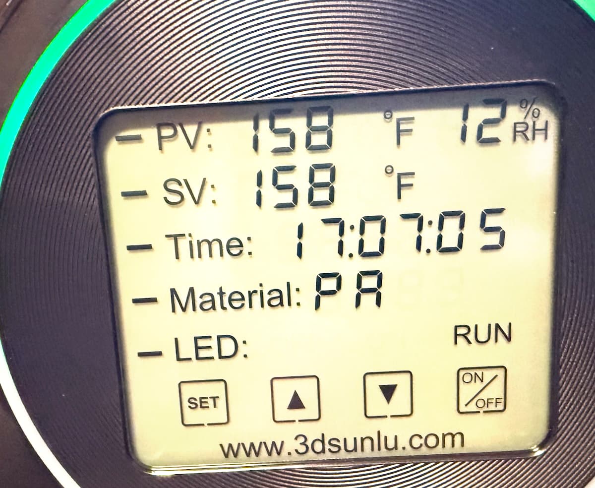

Is your S2 bottoming out the RH by now? I mean what is it reading?

The S2 humidity was pretty much bottomed out yesterday. It was 13 last night. Now it’s 12 though, so maybe there’s a little ways left to go.

12%RH is perfect, you should be able to print without artifacts. Just keep the spool inside the active SUNLU S2 while printing (don’t use the AMS).
Now, fully calibrate the Flow Rate and Flow Dynamics with the fresh 12%RH filament.
PA6-CF just isn’t an “easy” material, it requires full attention and commitment…
