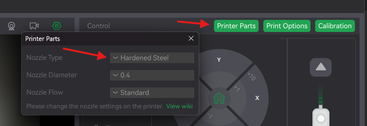

I don’t own an A1, so that things may be different. Can you confirm that your printer nozzle (if the option exists for A1) in Bambu Studio is correct?
Bambu Studio—> Device Tab → Printer Parts?

I am pasting screen captures to show you the warning I get. Though, it makes no sense in the fact that I selected properly the hotend type in the printer settings.
In this picture, it says in french: hardened steel 0,4 mm.
As you can see, the printer parts in bambu studio is greyed out and says hardened steel.
Now, when I try and print, I get the following:
And finally, I see the final warning.
The first warning says no AMS Lite, I know. Too brittle and could break.
The second says, that this is not the correct nozzle type. Now this, is an issue I think.

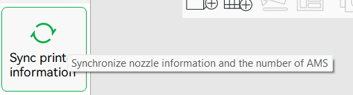

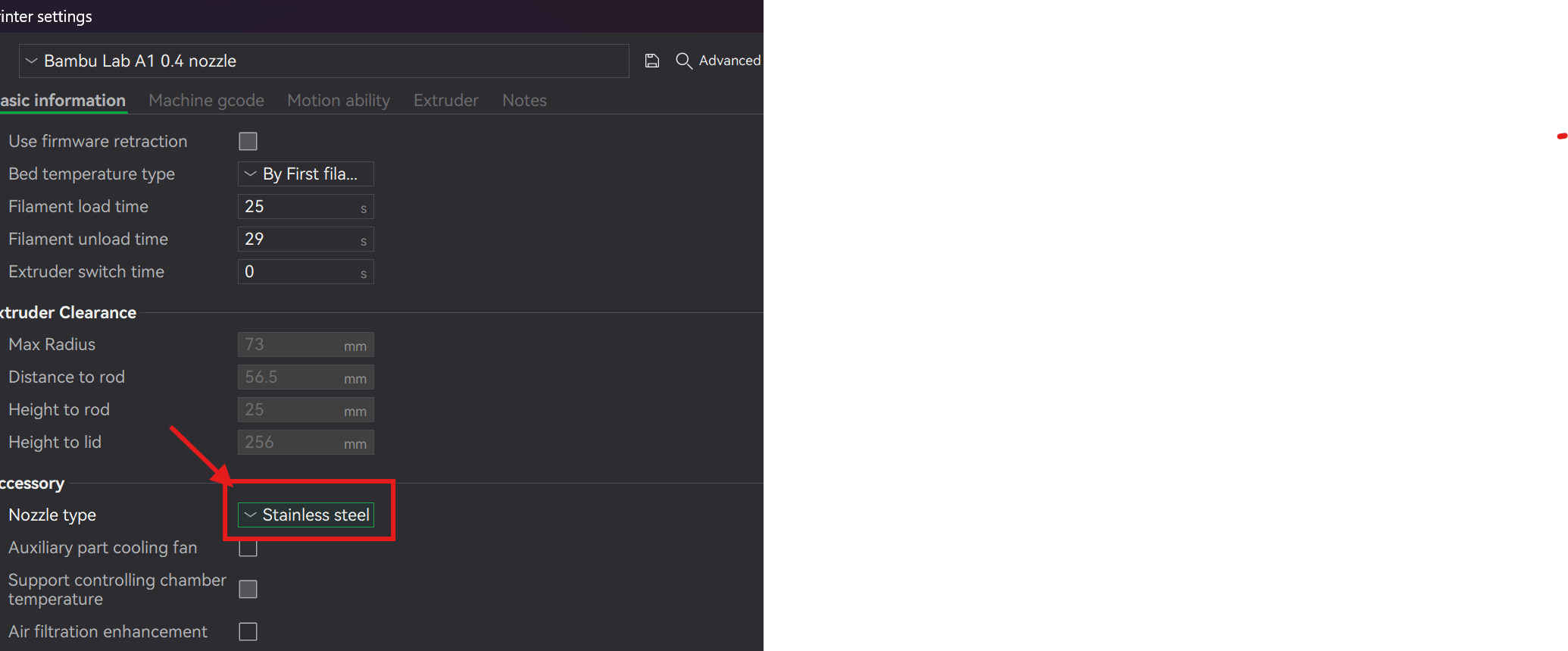

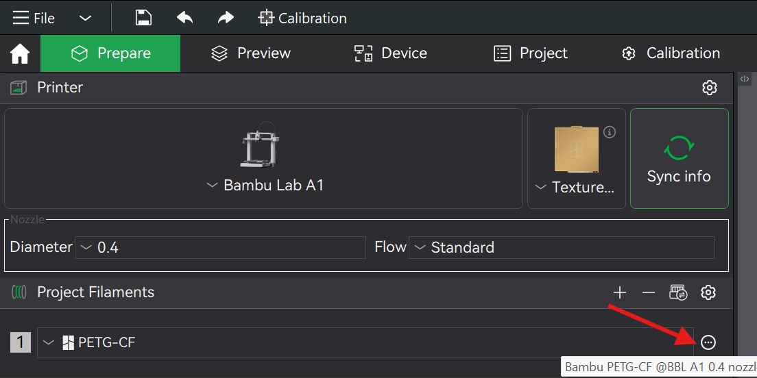

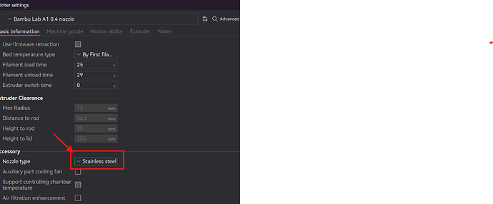

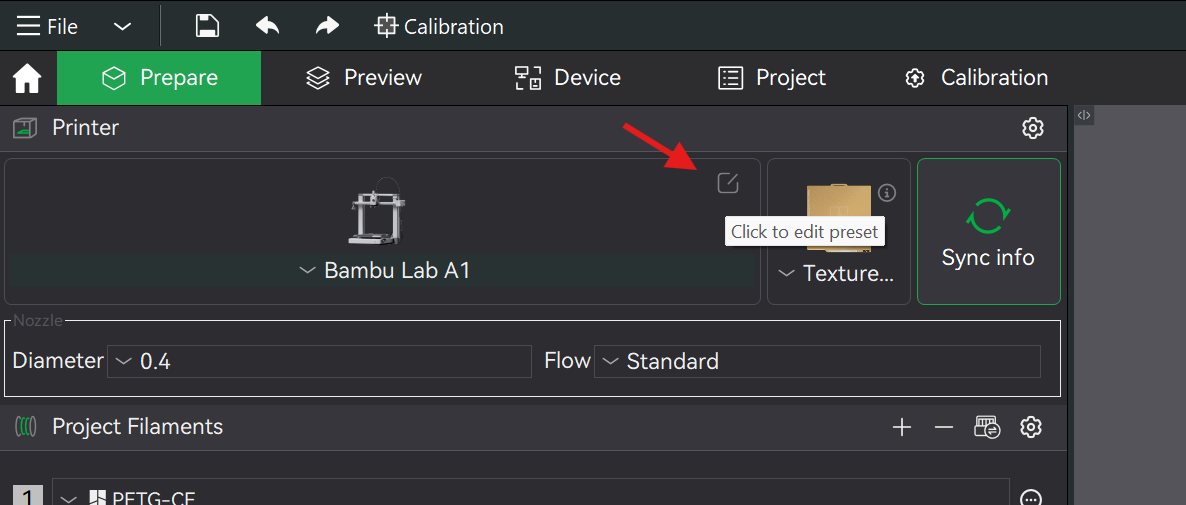

The only thing that I can remember, not checked, is the printer preset:
Press the right top corner of the printer box:
Then confirm if the printer preset has the correct nozzle setting, and if not, change it:

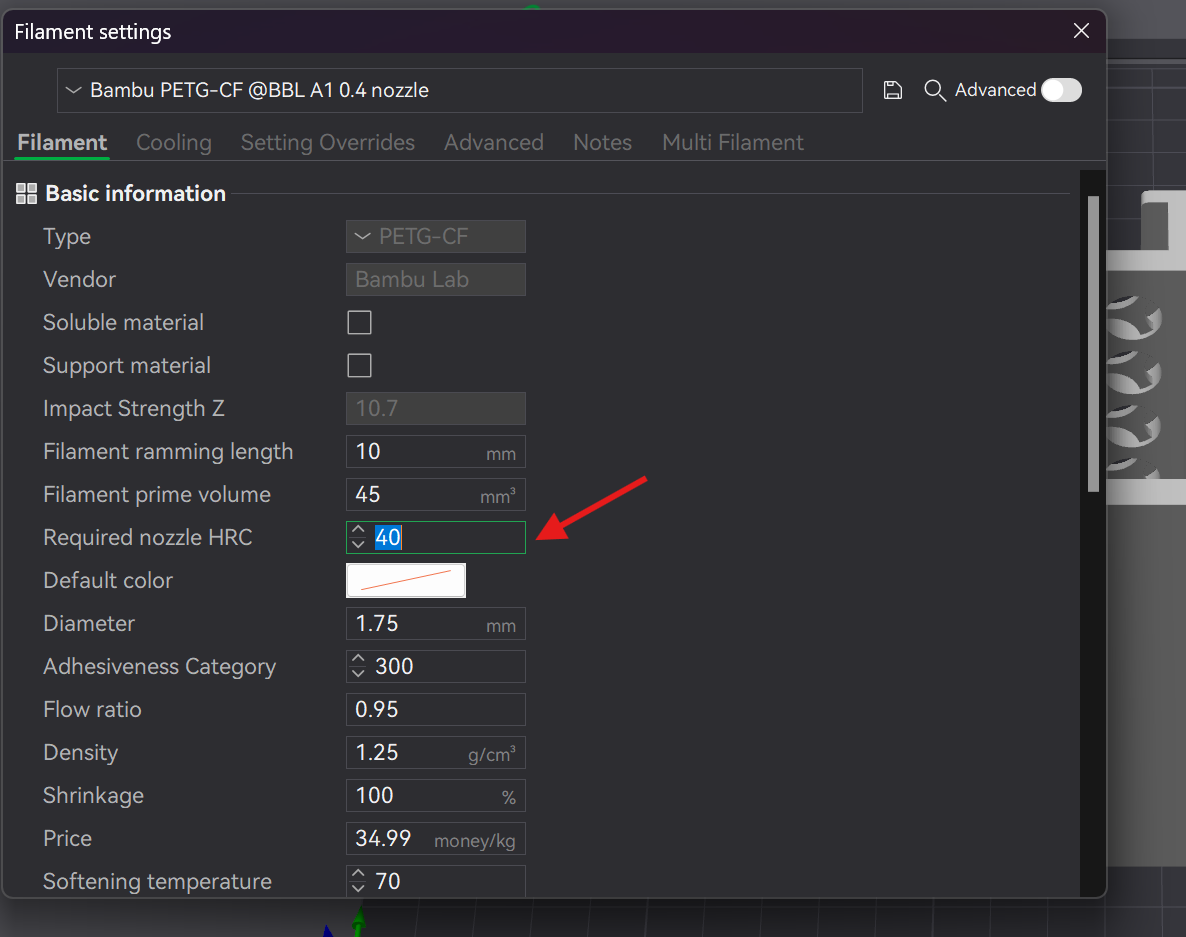

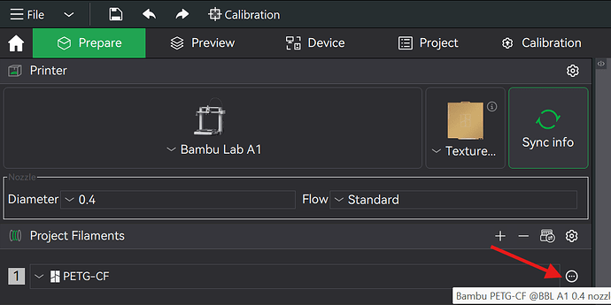

If it doesn’t work, you can try changing the filament nozzle requirements:
i.e. reduce the required nozzle HRC:

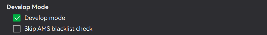

I am using the latest beta version, but those settings have been available for a long time.
I guess you may need to enable development mode in the slicer, which also leads to the conclusion that this, even if it works, isn’t a solution, but a band-aid.
