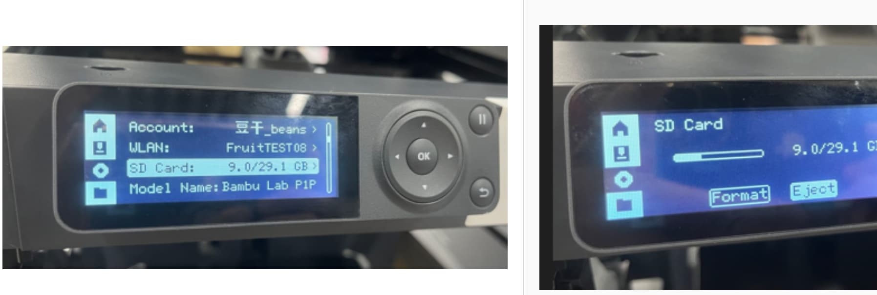

Start by reformatting your existing card inside the printer. This ensures it uses FAT32, which the printer requires. Formatting on a PC is possible but less foolproof—desktop OSes may apply incompatible formats like NTFS or exFAT.

  2. Option 2 is to is reformat the card. Go into the menu on the printer panel and navigate to through the printer settings. FAQ for Printing from micro SD Card | Bambu Lab Wiki
