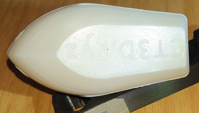

Is it possible to hide the visible lines in the first layer?
I previously had an Ender 3 S1 with a textured plate and there I did not notice any lines in the first layer.
What have I already done:
  • I have reduced the line width to 0.4mm.
  • I increased the flow until I had significant over extrusion in the upper layers. `
  • plate cleaned with iso.
  • plate cleaned with dish soap and water (just in case)
Unfortunately, both helped only very little.
I was thinking about changing the Z offset in the start gcode to squeeze the nozzle a bit more on the plate.
Or would it help to just use a textured plate?
Thanks for any help

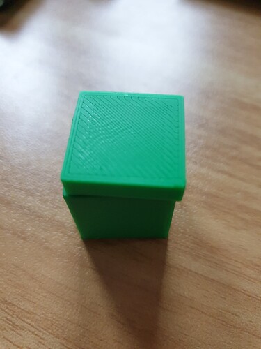

Thank you for your help. I have tested everything except the CF-filled filament so far (but I want to have a look at that too, I have some here).
Some suggestions have hidden the lines better, others have made them more visible:
For example, by increasing the first layer line width, the lines were more visible than before. Which is what I expected, because in my experience the gaps tend to get bigger rather than smaller when the line width is increased.
Everything else helped to hide the lines at least a little better.
Anyway, I ended up ordering the textured plate as it is available again in the EU. It gave me the best results with my printer before, which meant non-visible lines in the first layer.
But thank you very much for your help. I love the bambu community.

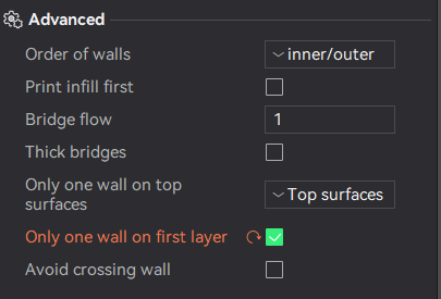

This wont fix you issue, but this will definitely help hide it further. Enable “Only one wall on first layer”.
Also if you enable developer mode in Preferences, it will enable a setting for “Initial Layer Flow Ratio” which I would recommend increasing a tad.
