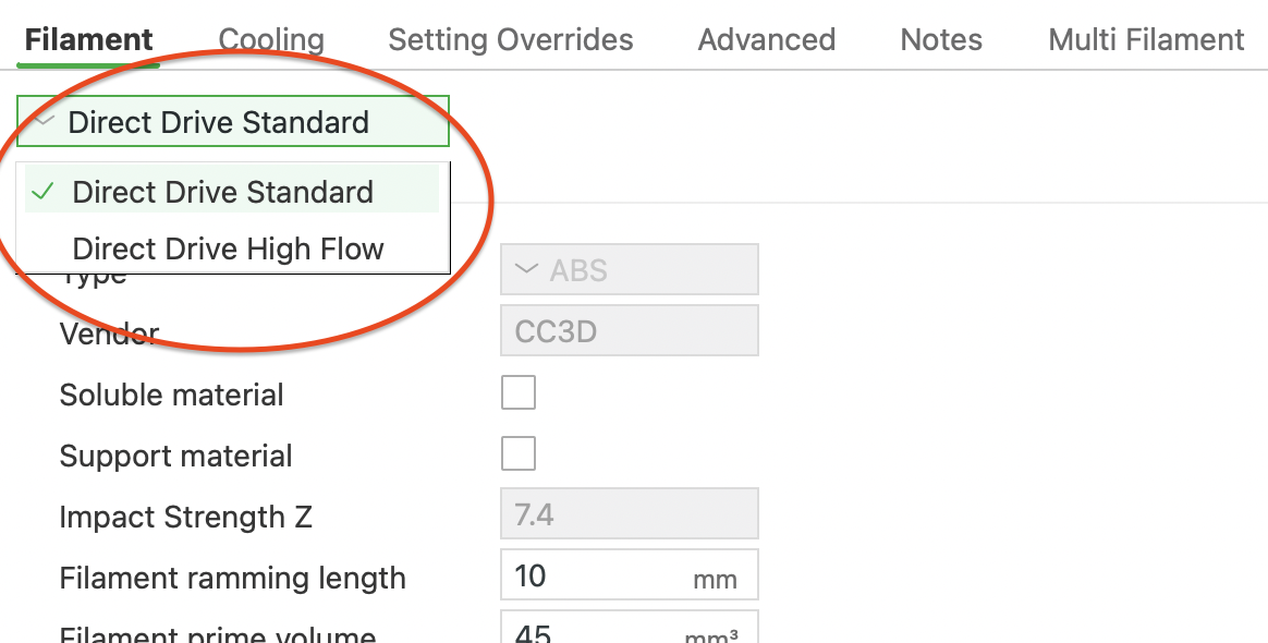

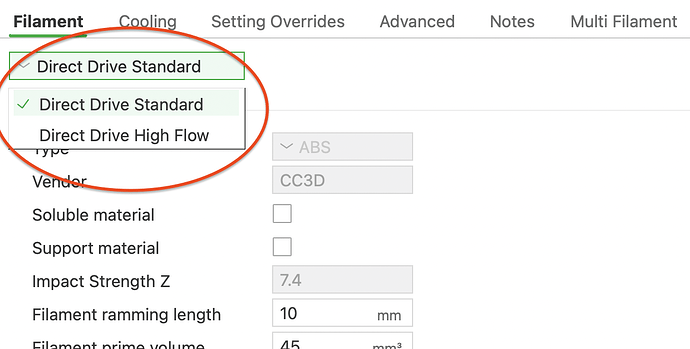

Have you adjusted the MVS and print speed? Without doing that, you won’t notice any difference. As a side note, the Direct Drive High Flow setting is applied automatically when an HF nozzle is installed. There’s no need to select it manually, but you do need to update the MVS and speed in the profile you plan to use.
The main speed increase is by increasing your max volumetric speed in individual filament profiles. I typically increase it by 60% or more over the standard nozzles. If you just plug the nozzle in and print you aren’t going to save any time on most filaments. Some Bambu filaments already have a higher HF nozzle max Volumetric speed, but generics/other brands don’t and will use standard nozzle settings. I find the HF nozzles to do exactly what they’ve said it will when they’re used properly

As others have said just installing the nozzles and then selecting them in Bambu Studio isn’t enough, you have to adjust the filament profiles to take advantage of the higher flow.

You could probably safely update to 18-25 Max Volumetric Flow but MAKE SURE you do it in the High Flow profile, it does not do anything in the regular filament profile. To take advantage of the extra flow you need to print wide and thick. If you are printing at 0.12mm layer height, then you will likely never see a reduction. If you are using 0.6mm line widths, and 0.24mm layer height you can see a pretty drastic drop in print time. When I did my flow test on PLA I was able to go from 27mm3/sec to 38 for max flow and it only stopped due to a extruder motor overload. I could have probably gotten more with extra heat. My test was with a knockoff HF though so I suggest testing it with your own filament, and don’t go up against the limit or you will see weaker prints.
This is where I made the mistake. I set a higher volumetric rate on the standard nozzle settings instead of the High Flow settings.
If you create your own profiles for filament and you use the HF nozzles, make sure to set all settings on the ‘Direct Drive High Flow’ part of the profile. Otherwise you will find the printer using unexpected values.
