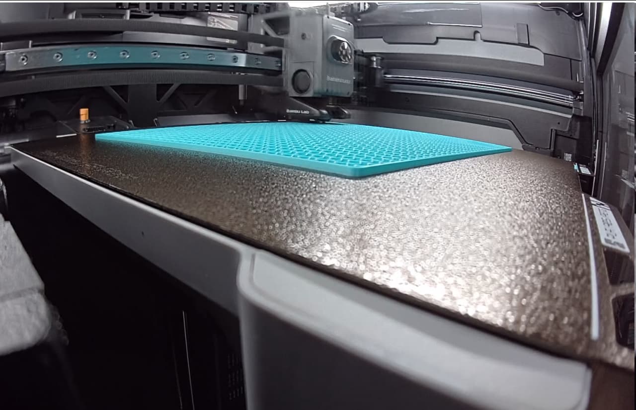

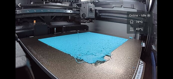

I haven’t been able to print with the HF nozzle at all. Initially, I suspected it was due to third-party filament I tried first, but this happened using the 0.4 HF nozzle with Bambu Basic PLA on H2S.
The proper nozzle was selected both on the printer and in Bambu Studio.
The standard 0.4 nozzle prints this same model just fine.
Any ideas?
