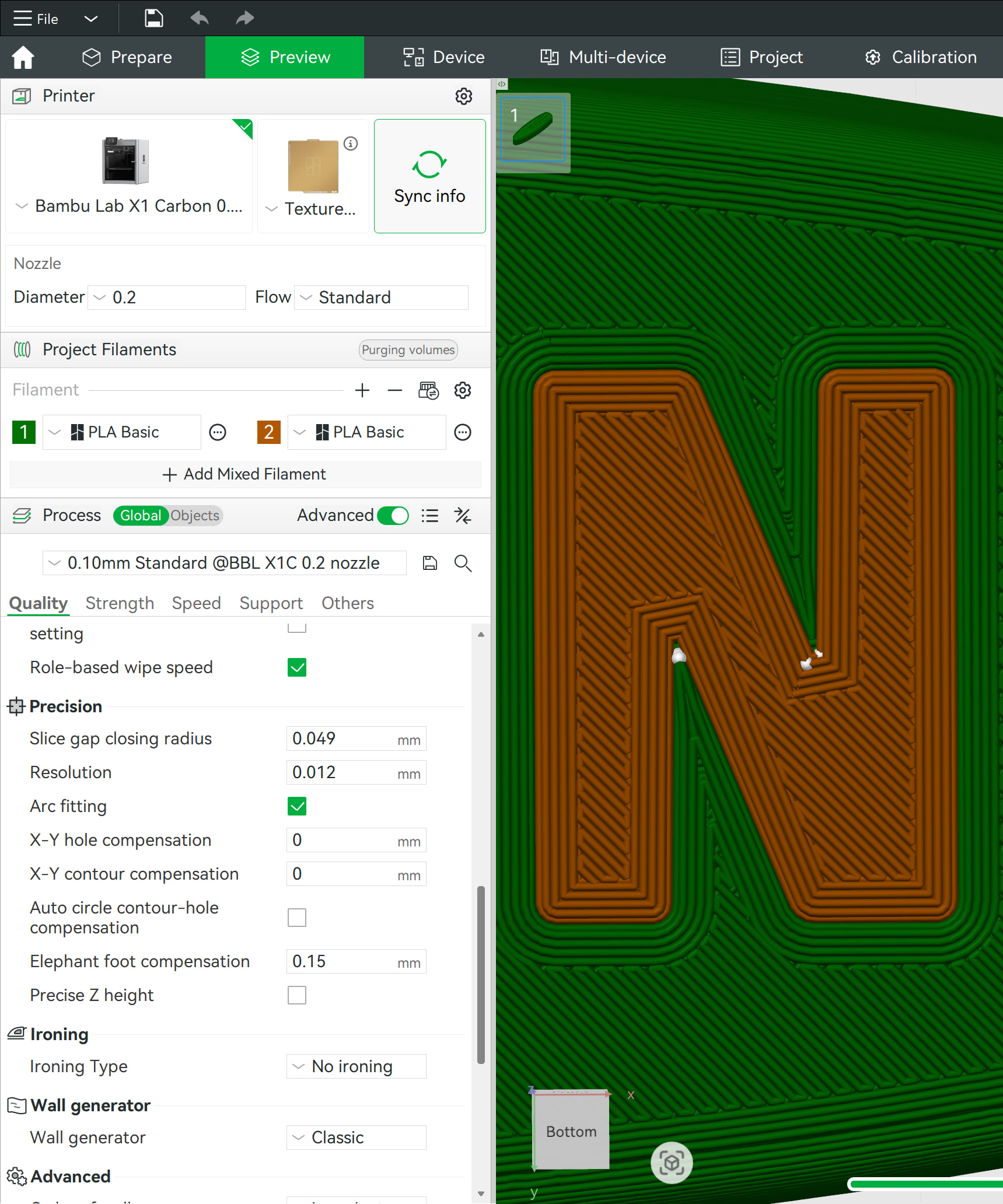

Note inside “points” of the N, where the green and gold should touch. With HC disabled, a 0.4mm extruder actually gets much closer. The 0.2mm extruder takes twice as long, but with that, and HC disabled, the points actually touch.

Without Hole Compensation and a 0.2mm extruder:
The main thing is, with HC enabled on 0.4mm extruder, which is my ideal use-case, I lose fidelity in corners with logos. But with HC disabled, my properly-modeled holes (connection points) end up being too tight.
