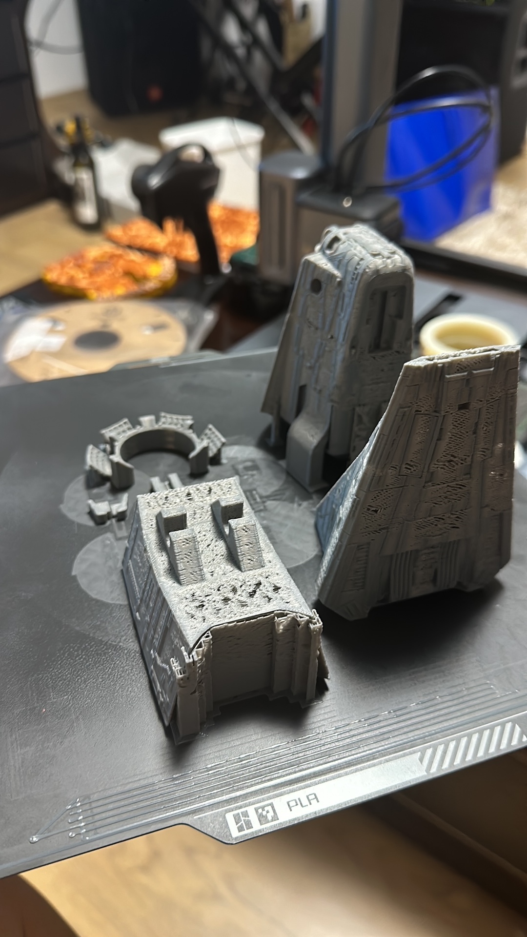

Horribe quality top layers
How is the first layer looking? Has it changed from the past? Did this problem start after a firmware update ?
Is the print bed flat and not warped @ 60c ?
What black pla filament is this you are printing with on this test ?
  • Brand ?
  • Type Basic ?
  • Matte or Gloss or ?
  • What is your flow rate & pa value settings @
  • What infill pattern are you using & %
  • You said nozzle was @ 220c
When I know more information but use these settings also.
  • Set top surface speed @ 100 mm/s
  • Set the line width top surface to 0.35
  • Top shell layers 6
  • This will give a nice looking top surface on most filaments
I first suspected the settings. The problem with the nozzle was not mentioned anywhere in the problem description. You wrote that it looks like the nozzle is touching the top, but not that you can really hear it.
If the nozzle is actually touching the surface you can try to reduce the flow rate.
And i think there was a firmware Update 4 weeks ago or so. If you haven´t had any troubles before maybe this caused the issue.
Bambu is still trying to improve the Firm- and Software daily wise.
Its definetly software related so there could be an issue with the bambulab software as well :wink:

With the settings you and HaiFred provided, there is a significant change in quality already.
Many thanks for that !

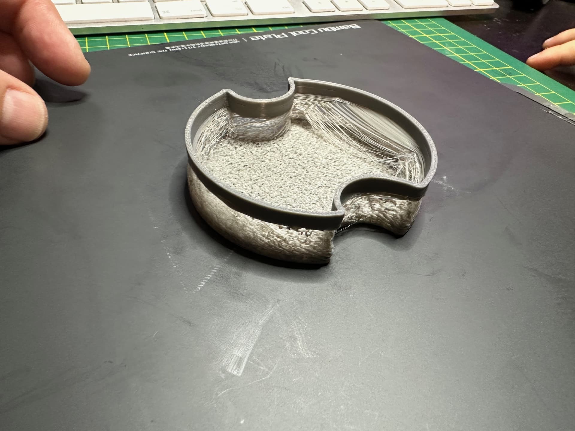

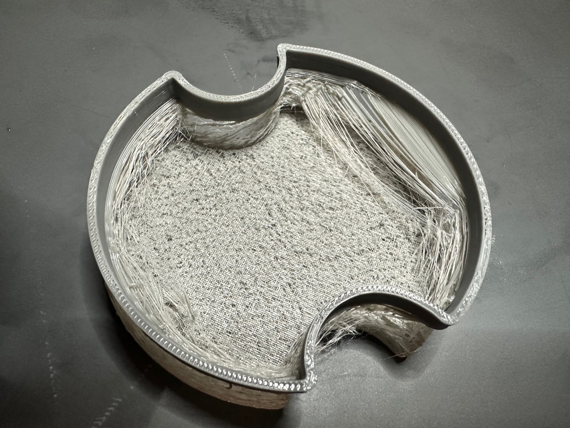

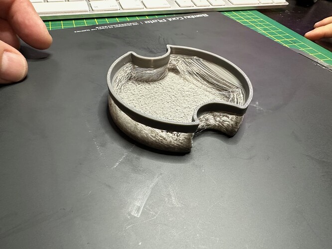

Hello, I got the X1 model with
AMS in December and first prints were amazing good.
Suddenly I cannot print anything with any type of filament ( I used PLA). There is a serious underflow and the parts are looking like in the attachment.
I took out the AMS and printed directly from the spool. Same quality.
I checked the hot end and all tubes for blockage or friction. All good.
What shall I try ?
Thank you
Did you install a firmware update for your printer recently ?
Yep you have under extrusion going on.
Have you maybe selected the wrong printer nozzle size in the slicer?

The extruder gears are full of filament or worn out or gears are bad you will need to inspect them.
Extruder Clog
The extruder motor might be failing intermittently.
Extruder Motor
Keep us updated on what you find out
You may try a cold pull. I had an issue like that after printing some carbon fiber, I did a few cold pulls and the problem was solved.
What shall I try ?
( I think he has already cleaned the nozzle out or replaced it but it don’t hurt to double check )

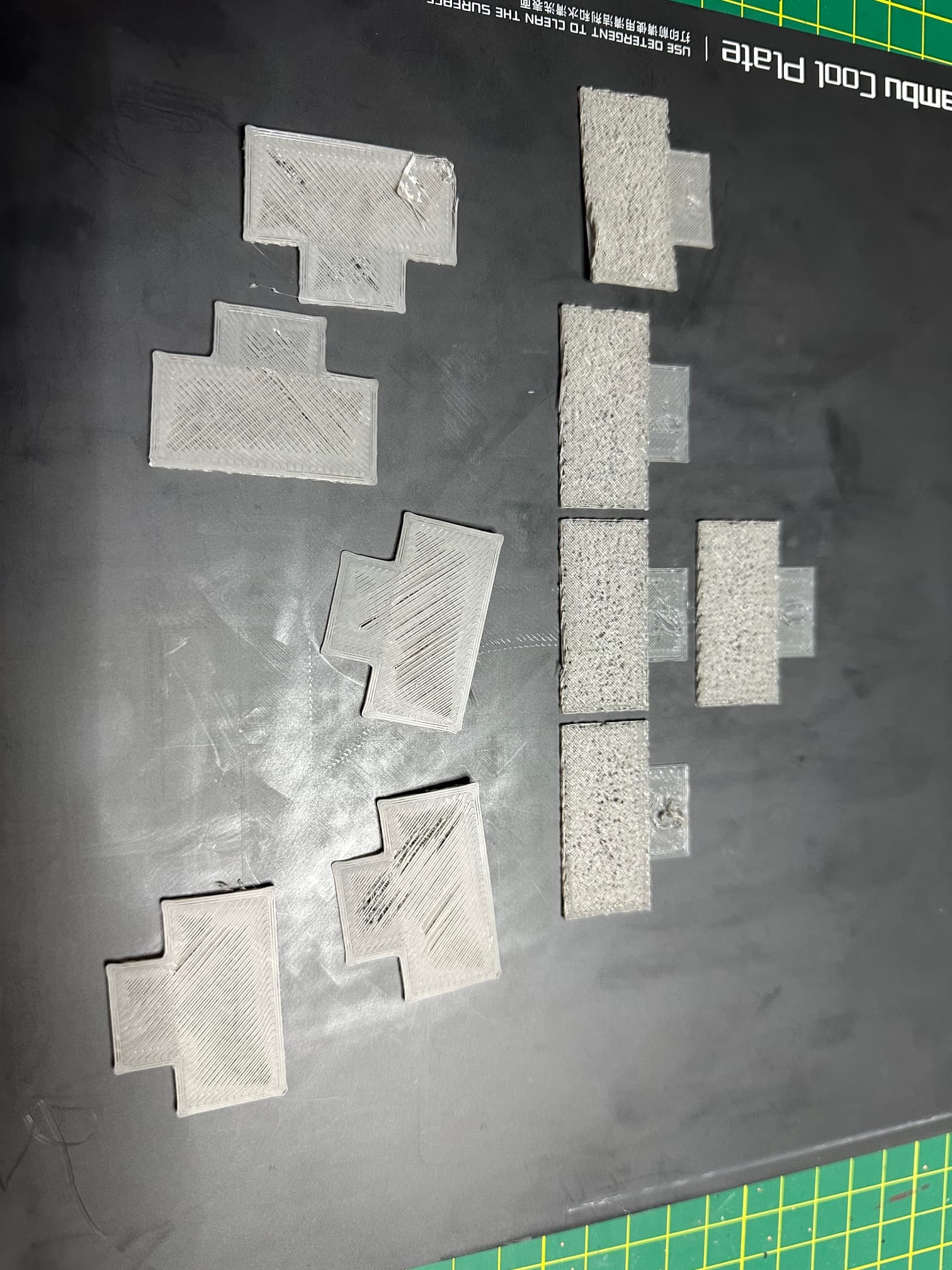

Yes. I did install but after printer update still I think it was running ok. In one of the pictures you can see bottom is roughly ok, middle is underexteuded and top is good
