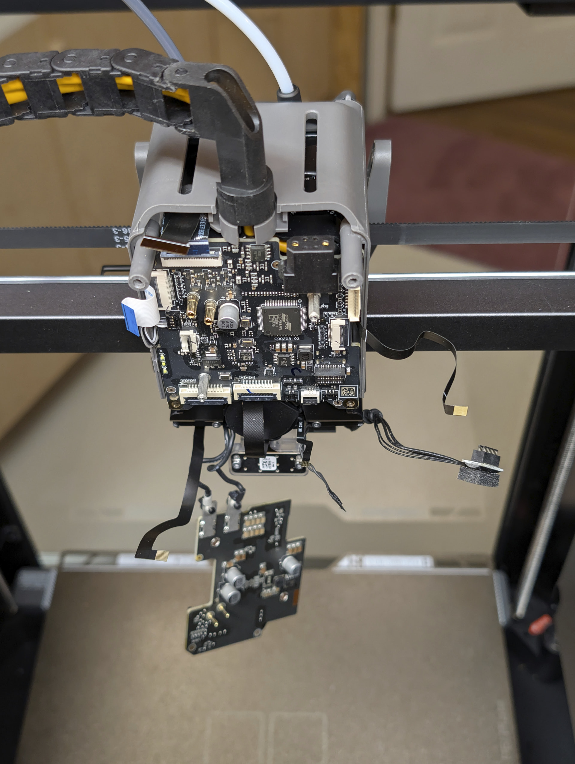

I keep getting this message when I start a print, the fan is slow or stopped. I followed the troubleshooting guide, the fan rotates freely and the electrical connection is good. Curious thing is, if I set the nozzle temp to heat (200 C), it seems to work, but I always get the error when I start a print.
The bambu wiki shows how to verify that the fan is blowing with a piece of tissue paper positioned between the two heatsinks. Very gentle air flow in my opinion.
I had that exact error in my H2C and just replaced that fan this last weekend. It’s not at all a trivial repair, about 20 really small connectors and since you have to disassemble the toolhead from the back you have to do it from above and behind the printer.
Yeah, trying to mentally prep for it. Moved it to a low table. I mistakenly confused the part cooling fan for the hot end fan. When it failed, did you get an error message when just heating the nozzle from the touch screen? I am not, but always get it starting a print
Face down on a soft towel with the display hanging past the end of the table.
I did it today, so I think I can do brain surgery now…. But I made a mod so I only have to do surgery once…
I did the first half standing on a stepladder with the printer on a cabinet, but towards the end got smarter and moved it to a hydraulic lift cart so I could move it up and down to a comfortable height with me standing on the floor. I should have done that WAY earlier. No desire to do brain surgery now.
Sadly, this fan is extremely fragile and underdimensioned. I have replaced at least six of them on my barely one-year-old H2D.
Prepare yourself for many enjoyable hours dealing with fragile connectors…
