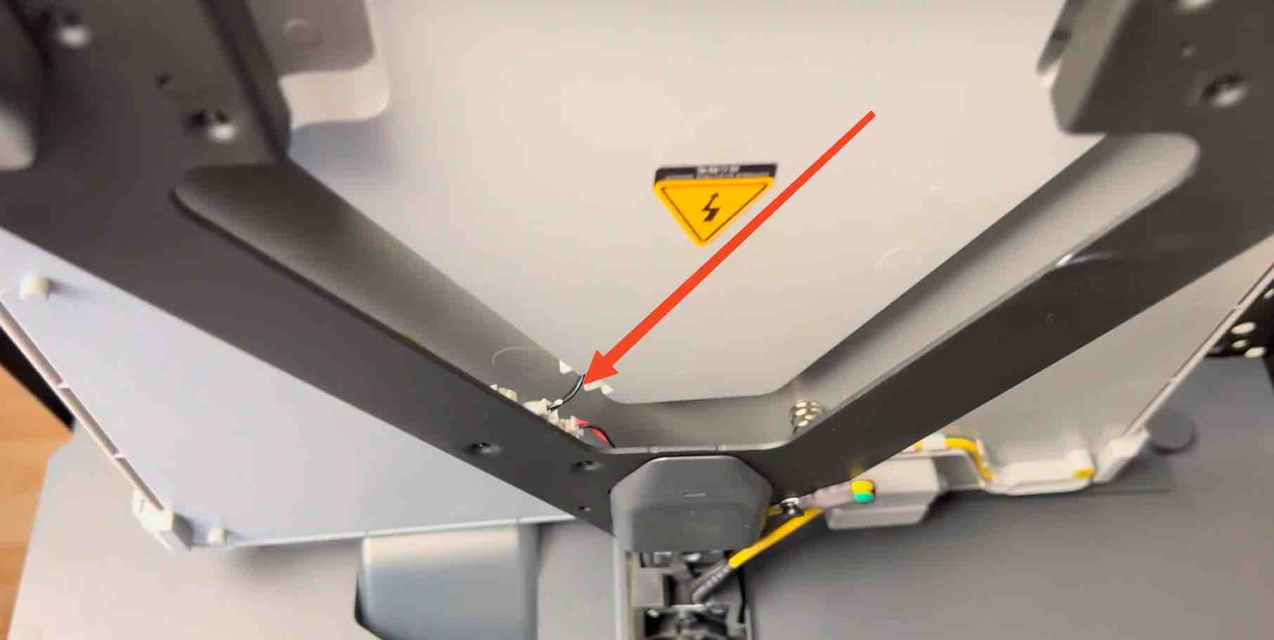

Hello, last friday my hotbead suddenly showd an error…
In the upper third heatbead positon the temperatures goes to 0.
I’ve already checked the wiki and did the shown steps. The connectors are alright. I presume it’s the cable itself. If the bed is in a position where the error occurs, i can bring the cable in a differt position by my own to get the right values… So, pretty sure it’s the cable. I don’t know, if I can repair it on my own without a spare part.
Support ist not responding so far…
Any one any idea?
UPDATE: Now even the obove mentioned “Cabletrick” doesn’t work… Temp is always “0”, no matter what I do.
In our case we have resolved this issue by attaching the plug at the heatbed. Maybe this helps.
Andreas
All connectors are ok…
Any update in that case? Same with my X1C, seems like a open wire in the sensor cable at the Z-axis bearing housing?!?!?!?!
BR
Olli
Jep, broken sensor cable. The support send me a spare one within a week.
