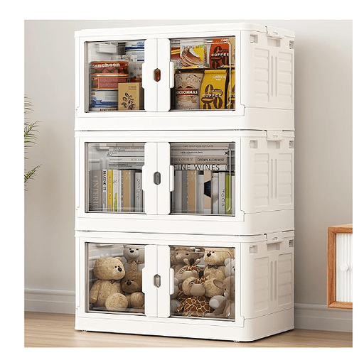

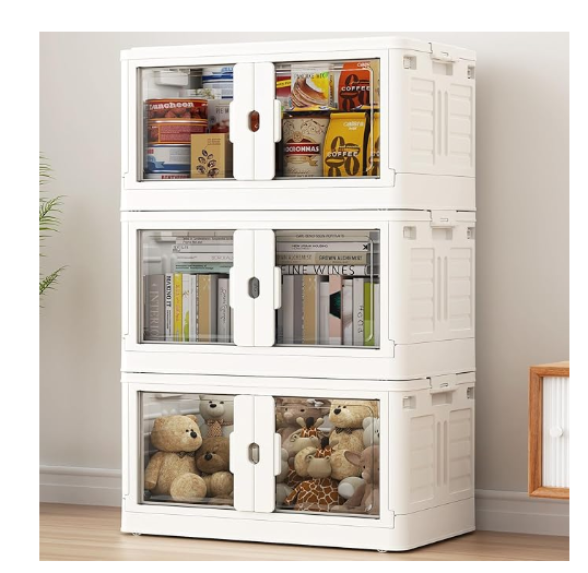

I haven’t seen storage containers with front access like this before:
but if there were a version that was airtight, it would seem like an almost ideal way to store filament. Everybody seems to be using containers with lid-only access, so if they’re stacked on top of each other you have to reshuffle them to get to the bin that you want. With these it would be direct access. With these front access bins, you wouldn’t even need shelving. It effectively becomes its own kind of modular shelving that you can easily add-on to.

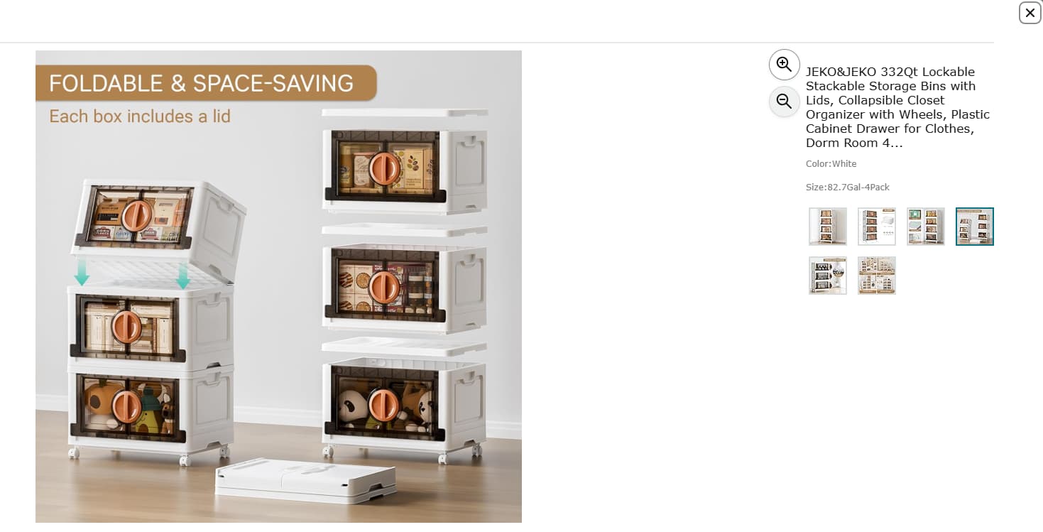

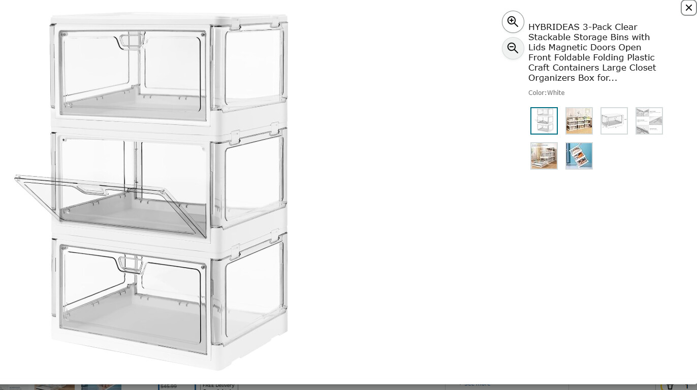

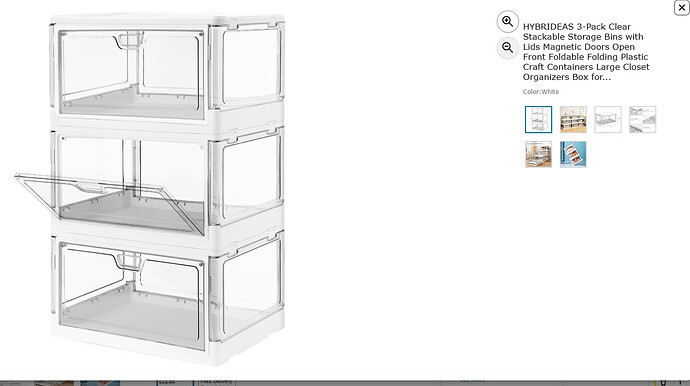

I had never seen this category of container before, but now that I’ve spotted it, there are probably hundreds of variants along the same theme:
so maybe there’s hope for finding an airtight version?

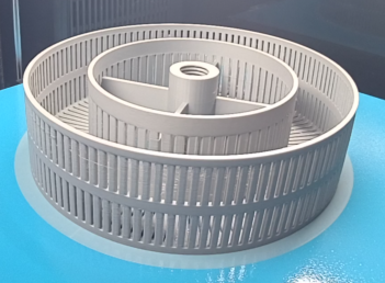

AMS 2 Pro is still noticeably ā€œleakyā€ with respect to moisture ingress over time. Although the popular little desiccant containers like:
and their many variants that you can wedge in help soak up the ingress, and are useful in that regard, they’re still underpowered. If you have one or more unused slots, though, you can easily pack in a lot more desiccant into those spaces, with things like:

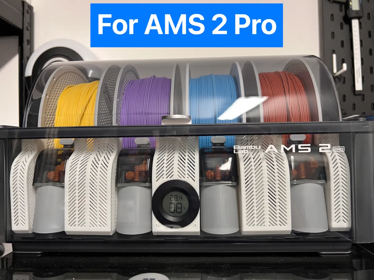

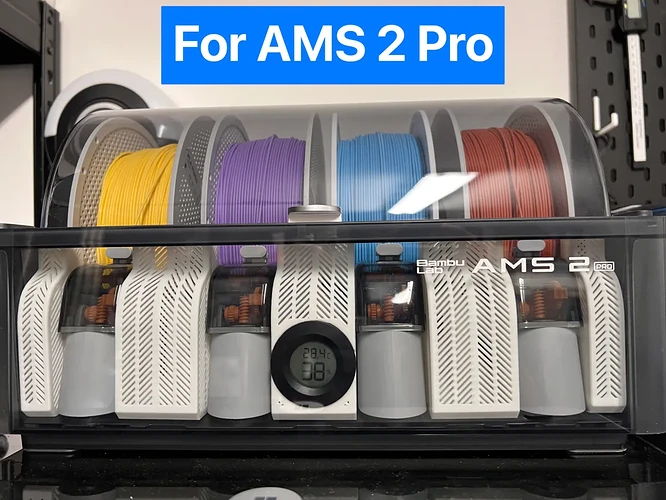

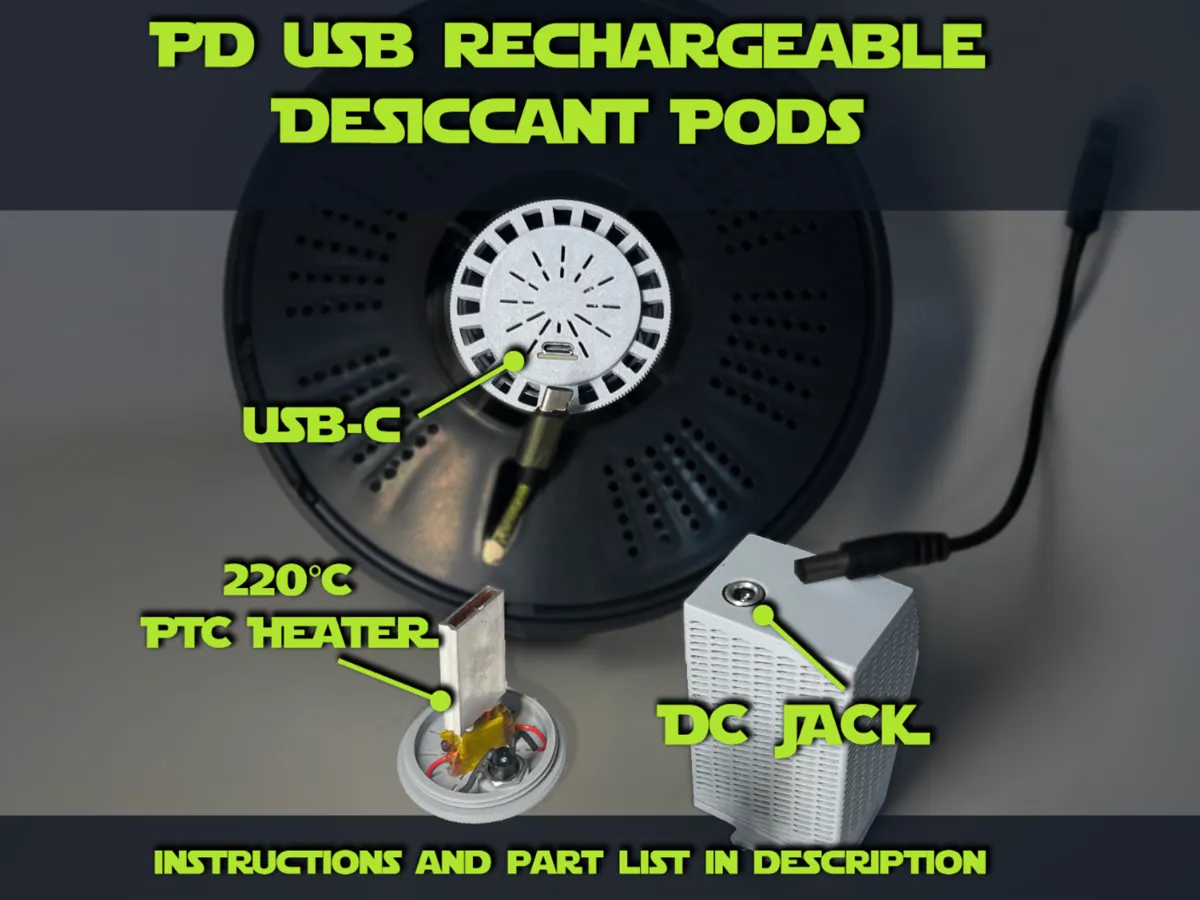

I got super tired of drying desiccant in filament dryer, so I made these PD USB Rechargeable Desiccant AMS / Spool Dry Pods - print 4 for the spools and 3 for the AMS. Remove and plug in to recharge.
@3Z3D Nice find!
I do wonder though: it says the PTC heats to 220C, so….Is that accurate? It seems perilously close to the print temperature for the ASA/ABS they recommend using, and obviously well above their ~100C glass transition temperature. I’ve also read anything above 150C risks damaging silica desiccant.
Aha, I think I see now. It probably would get that hot if powered at 12v, but it uses 9v instead. That might still be too hot theoretically, but evidently your success with it must mean it’s not an issue in practice, at least with the particular PTC the author recommends? I hate to be ā€œthat guyā€ who brings this up, but I’m just wondering aloud as to how hot it might get. Have you done any measurements, or, if not, noticed any plastic deformation?
I’m sure there is a temperature where it would be fine, as evidenced by bigger desiccant holders that one can just plug-in to recharge, but maybe those have some kind of closed-loop circuitry and/or cut-off temperature, whereas this seems to rely on 9v alone. Is that the case, or am I overlooking something?
If it were me, I’d feel more comfortable using a PTC that’s rated to max out at a much lower temperature. AFAIK, that’s the whole point of using a PTC in the first place. That, and maybe it’s just me, I’d include at least one temperature cut-off switch, as ā€œjust in case something goes wrongā€ cheap insurance. However, I’m not claiming any expertise in this area, so maybe I’m just fundamentally misunderstanding.
I’m sympathetic to the objective though: making it more convenient to recharge your desiccant. Therefore, regardless of anything I’ve said here, thanks for your post. It’s a worthy objective.
Anyone else have any thoughts on this?
I use an S4 or just put the filaments in a drybag with silica
It’s probably fine but the heater deep in the beads will need slow and gentle heat to keep from overheating the beads next to the heater while beads at the edges may not get warm enough? The way he shows regenerating the beads with a fan would keep the outer beads from getting as warm so they may hold onto more moisture.
But there is also intended use. They are probably fine for helping the AMS and if that easy to regenerate, should make for more dry AMS units I guess.
