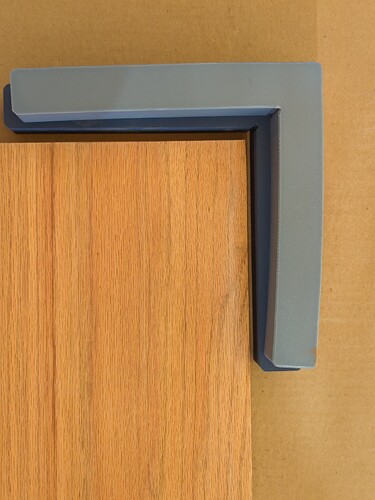

BTW, since @KanneKaffe mentioned PLA… a while ago I printed some very simple right angle brackets in PLA Basic and PLA-CF. This morning I had them laying on my work table outside in the sun. Air temp 80F/27C. It’s October, not July/August and it was still just morning sun. Yet:
The crooked bracket in blue-grey that is on top is in Basic PLA. Below it is a blue/black one in PLA-CF that was laying on the same table but didn’t deform (even though it has basically the same softening temp). This is why I don’t use PLA… (Which doesn’t mean others aren’t successful with it!!!)
Have fun & report back!!!
Bambu Basic PLA?
I have never seen PLA that warps in direct sunlight. I think it’s a special feature of high-speed PLAs. That’s why I recently sent 4kg back to Amaz… the other day. It warped much earlier at higher temperatures.
But it looks very strange to me in the picture. As if it had shrunk a lot afterwards.

Interesting. So maybe my dislike of PLA is due to the Bambu Basic PLA…
