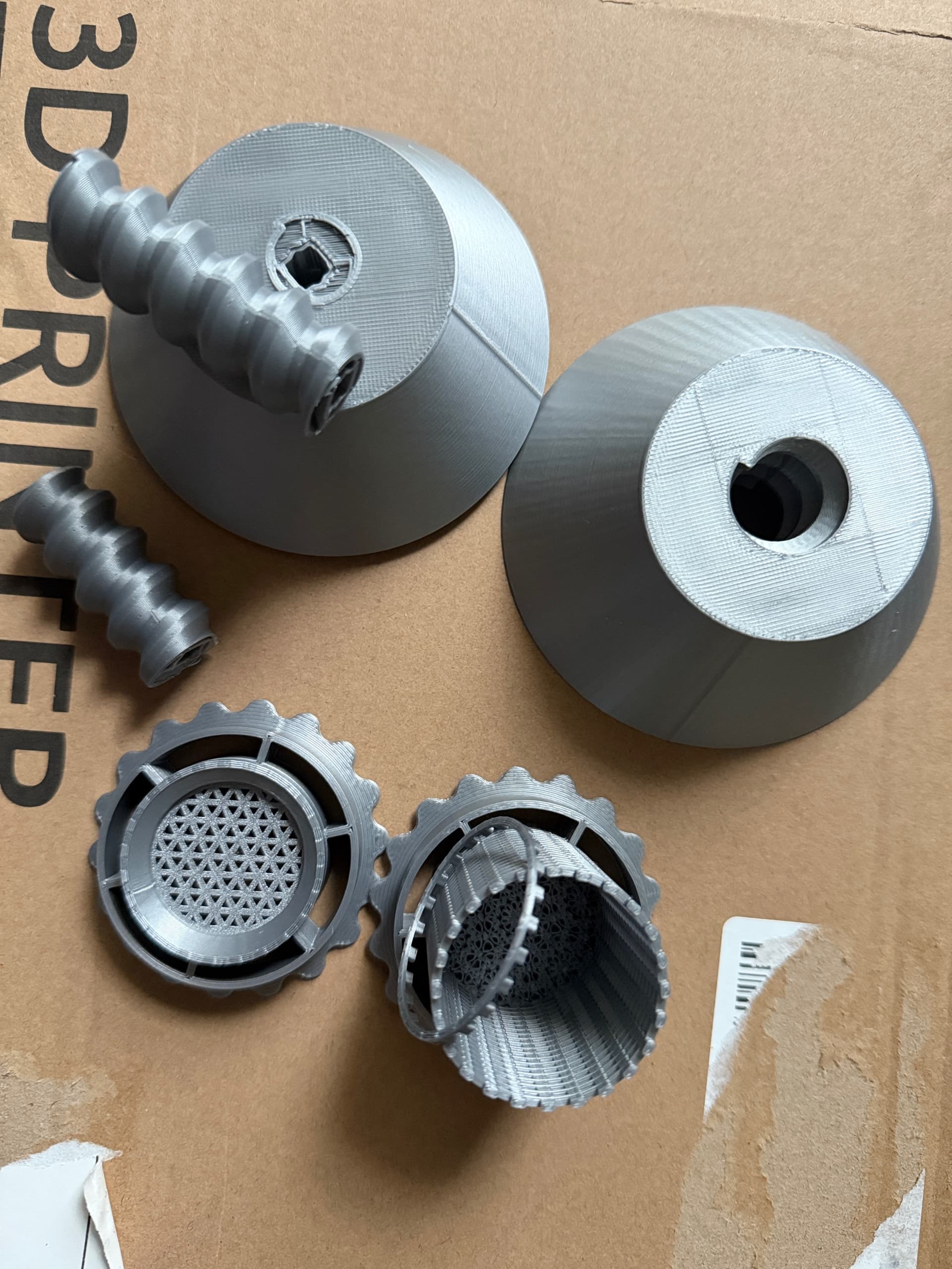

I’m having the exact same problem with the same Bambu Silver ABS, and my spool is only two weeks old, so it’s brand new, not a stale one. I followed the manufacturer’s drying recommendations using my AMS pro 2 and store it in a dry box at 10% humidity. Despite printing on an enclosed P1S with a popular 5 star model, the result was so brittle it shattered immediately when I tried to put it together. I tried a different model and the result was the same.
It’s alarming that your experience from a year ago is identical to what I’m seeing with a fresh spool now. @RobH2 did you ever find a solution or identify the cause? Knowing if it’s a chronic issue with this specific color or something else would be a huge help.Thanks!
Once printed the filament shouldn’t be “brittle” as the moisture has been removed. You might double check that you are using the right filament profile. Can you link to the model that you printed and have issues with?
From your picture you are probably running into more of an issue of the threads being too tight and binding. It also seems like both your wall count and infill seem low. Threads will put a lot of pressure on the weakest part of the print which is the adhesion between layers. This is generally where you will see parts fail regardless of filament type. It is a limitation of current FDM technology.
I appreciate your insight about thread binding and layer adhesion, that makes perfect sense.
Here’s what’s puzzling me: I used exact profiles to print the same models in Generic PLA+ with perfect, strong results. That success is why I moved to ABS. In fact, as shown in the picture, the structural rod on the ABS version is so weak I can snap it with my fingers like a pretzel, while the PLA+ version is impossible to break.
Given that the model and settings are proven to work, what ABS-specific adjustments would you recommend to overcome this brittleness?
I would start with more walls and higher infill number.
That said, your part shouldn’t be that brittle. Are you pausing the print at all or printing a bunch of parts at the same time? The reason I ask is if the part has time to cool without new plastic added (while the head is off printing the top layer of another part) it can shrink (as ABS does) and there will be a larger gap (and a weakness) when the next layer is applied.
Suggest printing each part one at a time.
