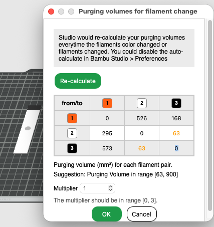

How can I purge more than 900?
Hi friends, I have been having bleeding problems trying to print this duck where the filament color changes from black to yellow.
I have set the filament change purge volume to 900, set inner walls and infill to print first but yet I am still seeing banding. It looks like I just need to purge more to get rid of the black. Does anyone know how I can increase the purging? Thanks in advance!

Thank for the reply, I think the multipliers multiply the calculated amount of purge required, but to a maximum of 900, according to the flushing volumes window

This is a somewhat recent change to bambu studio. a few months ago I was able to set a higher flushing volume as I would generally use more than 900 for PETG-with-PLA-supports printing. Today the software overrides what I type with 900.

bug-report See post above:
  • flushing is limited to only 900,
  • in some specific cases not enough
  • instead of fixed “cut” should stay a suggestion, maybe with a more intense warning that you exceeded the “suggestion”
  • Multiplier takes no effect, does not multiply values above 900

Has this been addressed yet? I can’t seem to change the purge volume more than 900 and can’t change the purge tower to print more filament.

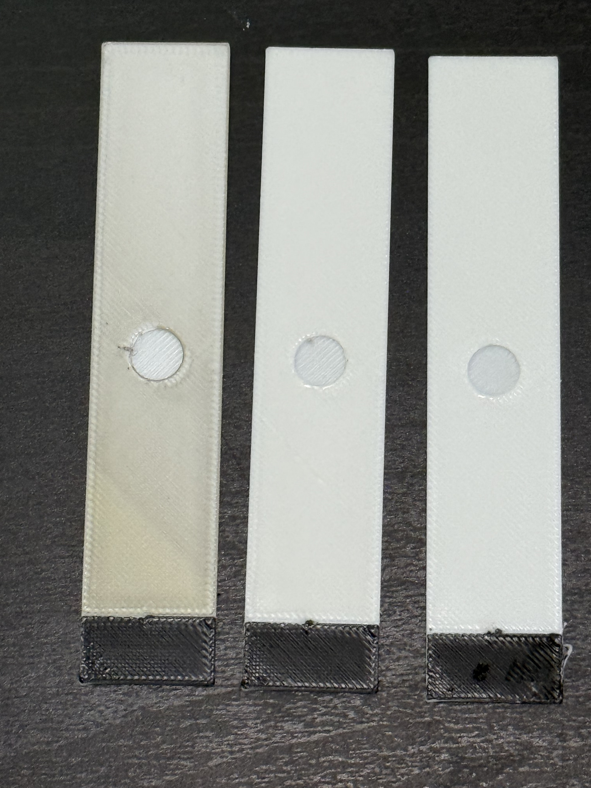

I do not make statements without backing them up, so here are test models with all data to show you.
900 to purge from black to white is mental, more is not realistic.
Granted, I am working from my own experience, but this is what I see.
Three tests:
  1. Dumb - Lowest black to white and reverse values possible.

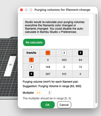

  2. Reasonable - Half recommended B2W and reverse (manually and using multiplier)
    • B2W = 312 & W2B = 72
    • Result is excellent

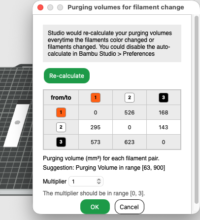

  3. Recommended - Actual recommended B2W and reverse (using the re-calculate button)
    • B2W = 623 & W2B = 143
    • Result is excellent, as expected
Photo:
A = Left, B = Centre & C = Right
Test model:
  • 20mm wide
  • 100mm tall
  • 1.2 thick
  • Solid model due to 3 bottom and 5 top layers
  • 1 wall to focus visuals on the flat surfaces
  • Model oriented so the white immediately begins in the same location as the black portion ends.
  • Black portion is 20mm x 10mm at one end.
  • An 8mm circle cut into the top layer of the solid white 1mm (5 layers) by 0.2mm and another 0.2mm in the top test layer
  • Filament order forced to print black first to demonstrate the transition (if any)
  • BL PLA Basic Black & White Used
  • Test area is a single layer so any issues are clearly seen
The test model creates a solid 1mm thick white block before printing the black portion and the final white portion (a single layer) to show any discolouration.
The test hole provides a means to see a solid and clean white portion in contrast to the test 0.2mm single layer.
A = Benchmark
C = Recommendations
B = What only using 50% of those recommendations gives you - visually identical to C.
My test B is essentially 1/3rd of the number you wish to exceed, yet, I get the identical white as if I used the recommendations which are roughly 2/3rd of what you wish to exceed.
