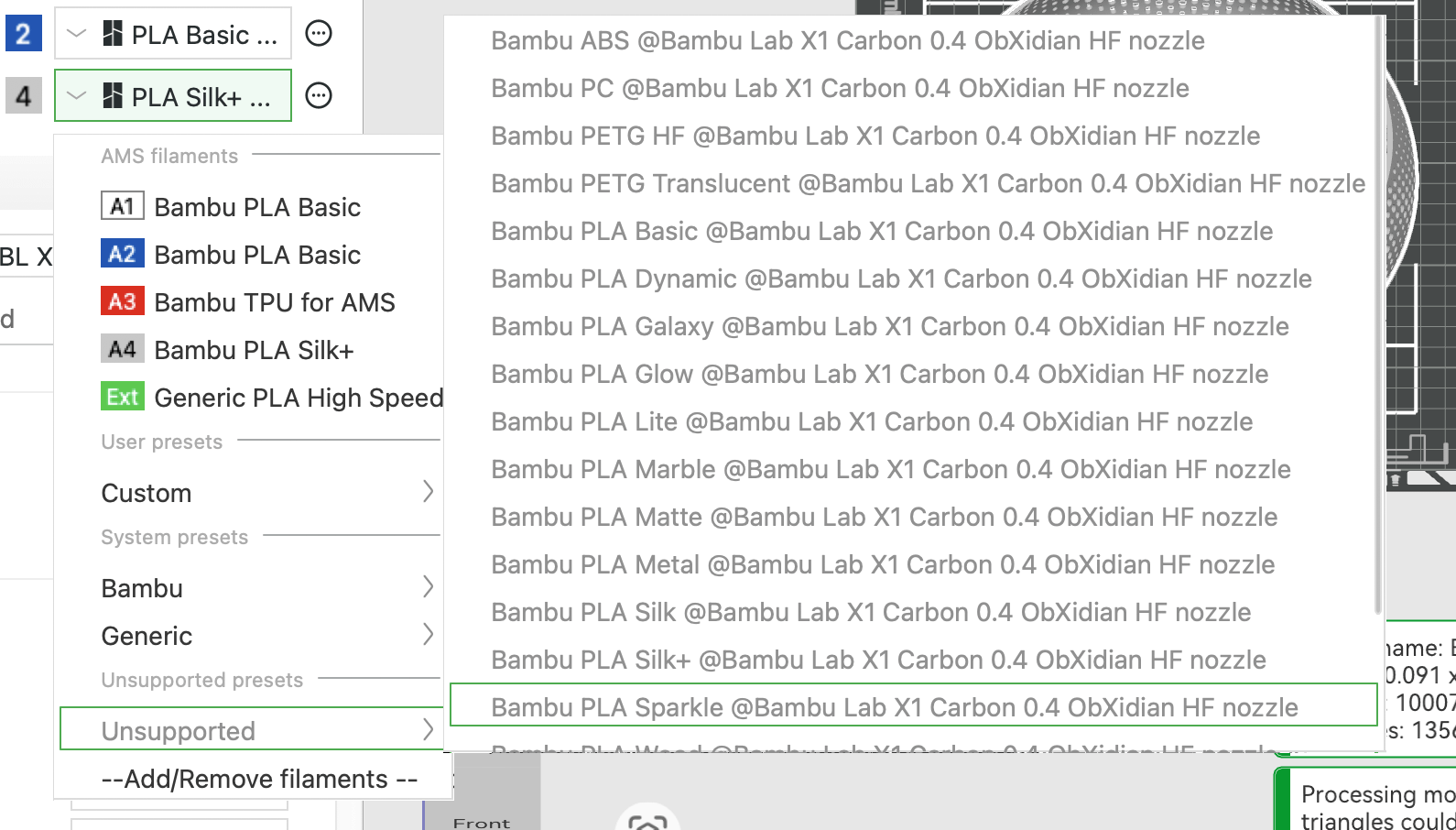

Here is a brief excerpt from the link at E3d for the Bambu Lab High Flow ObXidian HotEnd 0.40 mm: This excerpt demonstrates how to obtain the configuration file for this hot end. Upon installation, you will notice the availability of numerous new presets when selecting a new filament.
However, these presets are currently listed in the “Unsupported” dropdown menu, rendering their use challenging or impossible. I append a screenshot of the way it looks after this E3D excerpt from this link

I have the same issue. Can’t access them in the menu.
I wonder :thinking:? Purely out of curiosity :wink:. How to read the data in the interim before Bambu Lab unlocks or removes the unsupported tag in the Config file.

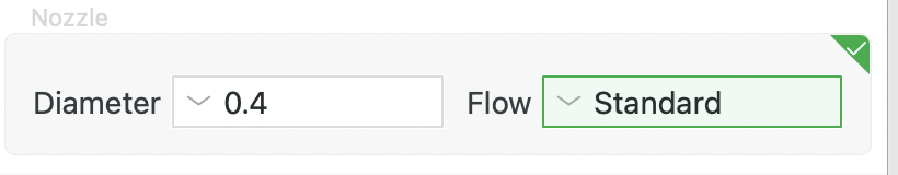

make sure under the printer you have the high flow nozzle selected it adds it into the slicer and app etc
there is no high flow option only standard as far as I can see
also I want the Bambu studio to default to the ObXidian X1 C if that is what I set I tire of having to do it for every file.
New Bambu Studio added flow setting “High Flow”. Trying to print such job asks me to set matching nozzle setting in printer. Nozzle settings in X1C screen doesn’t have flow option. Bambu Studio has it on printer settings, but they are read only.

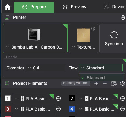

Previously there was no way to officially tell the printer you had a high flow nozzle. You could still use them, you would just have to create a print profile for it. After this firmware you can mark it as high flow on the printer and choose it in Bambu Studio… I haven’t poked around yet to see if setting it ups the flow and whatnot. I’m really hoping it does.
I downgraded back to 1.10.00.00 firmware. Some of my prints failed badly (looks like flow problem?), some were fine. And it doesn’t recognize Supertack build plate. I can disable the detection, or simply press Resume, so this one is not that bad. Print failures is fatal.
1.10 with custom profile works fine.
I’m having an issue where it won’t let me print in standard speeds. Because my high flow is selected. So now I can only use high flow speeds for all filament. I even tried to customize some of the filament settings and lower the flow rate. But still turning out like trash.
Me too, the dropdown only has seems to standard instead of highflow, and my printer keeps complaning that I have the wrong nozzle
