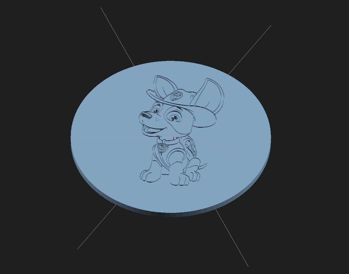

I wish to add a 3-colour image to a coaster, can anyone offer any advice as to how this can be achieved most easily, please?
You can use the free application OpenSCAD, and do this in code:

My part is a round drink coaster 105mm round and 3,5mm thick and my graphic is round also, I need to scale it up to fit the coaster STL though
How do I change the cube in the code to a circle?
Is it as simple as replacing cube with circle?

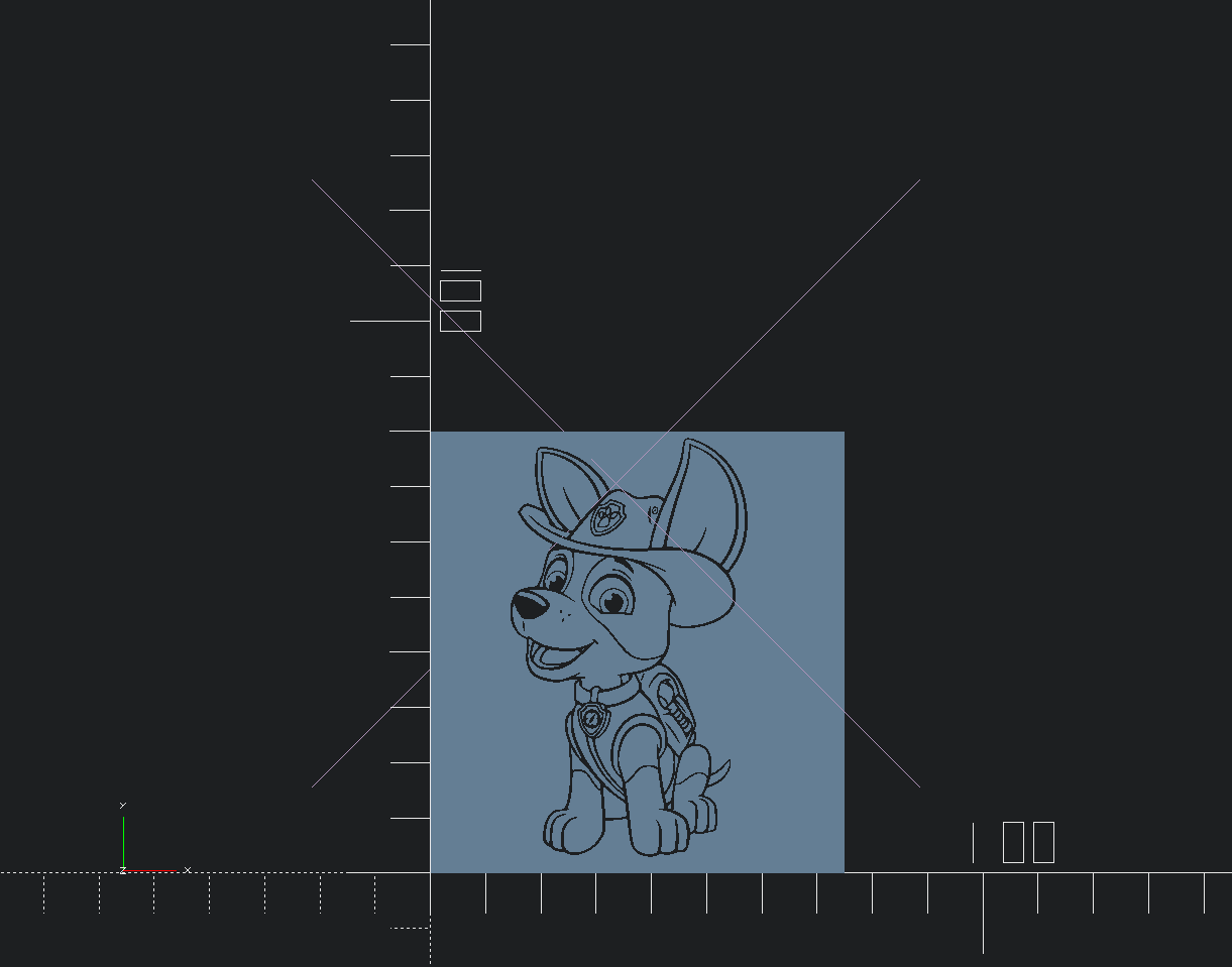

How do I import my graphic? and would I have to change it to black lines like in the image and then colour it in Bambu Studio?
I am not very competent with Open Scad, I have only used it to run a random crystal generator, I print them in natural PLA and place them on top of an LED/RGB light puck

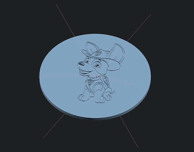

difference() {
cylinder(h=3.5, r1=105/2, r2=105/2, center=true);
translate([-20,-35,-1]){
logo(20);

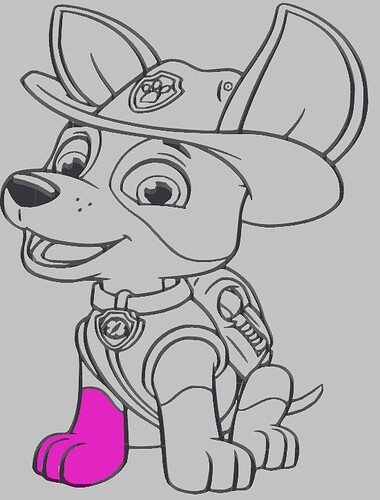

Just export to STL file, and color in Bambu studio. (just click on the images parts)
put the *.SGV file in same directory where your project will be saved.

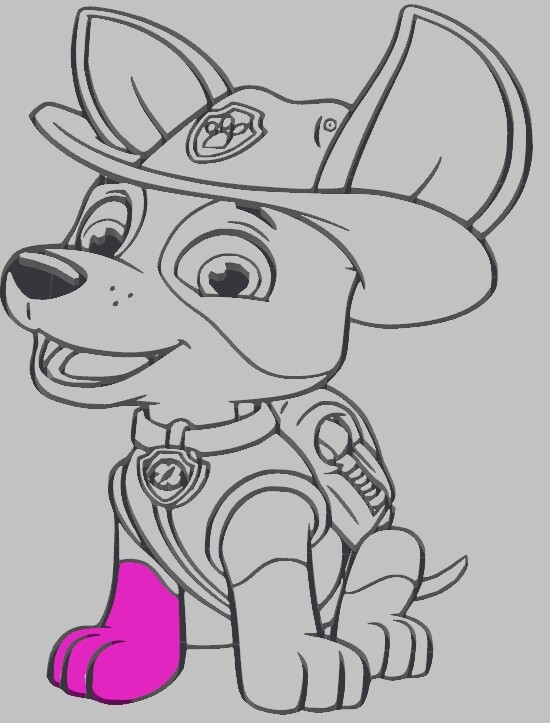

I think you can use the paint feature in Studio. Iām new to all this too.
