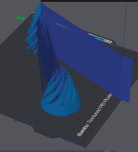

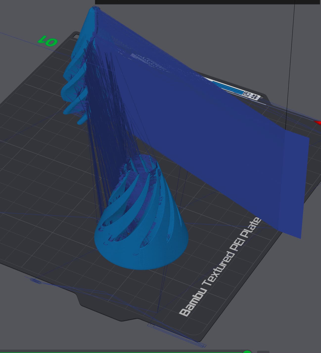

Hello, I am trying to print something but I stumbled upon this
Screenshot 2025-07-31 at 10.32.05 PM
As you can see, there’s some extra time for the timelapse, even if I have it deactivated.
This also causes some unnecessary travel.
Looking forward to the responses.

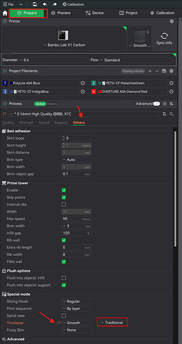

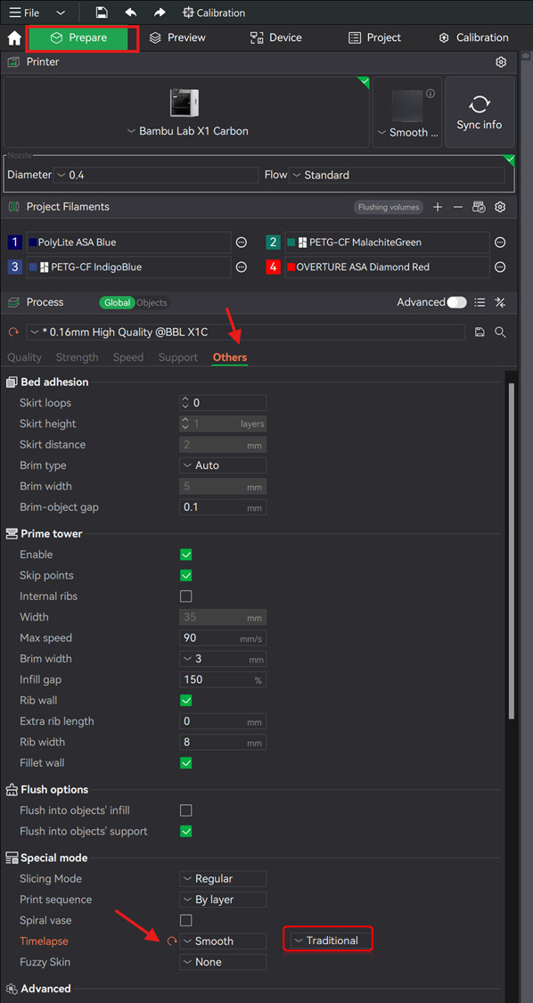

Hi
  1. In the prepare menu,
  2. Select the “Others” tab
  3. Switch from the timelapse “smooth” option to “traditional” in the special mode group.
Nope
Still nothing for some reason…
