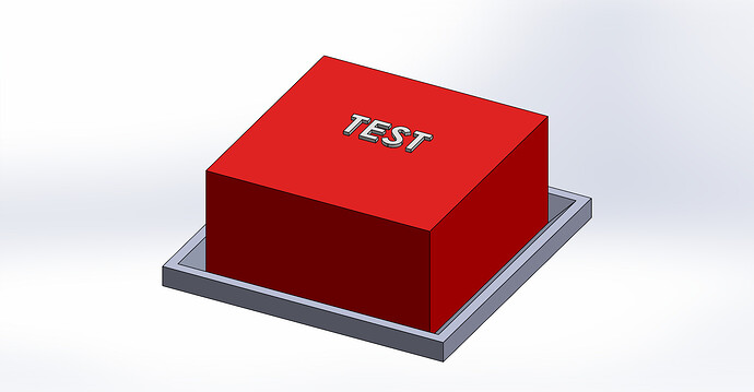

How do I print onto an already existing part?
I would like to print a larger shelled part that would not require supports if printed with the top facing down. After it is printed, I want to flip it over and print raised letters on top of it in a different filament color. Doing it this way will eliminate the need for multiple color changes and the need for supports.
I plan to print an alignment jig on the printing table that stays on while removing the object that needs to flip over to ensure the part goes back into the correct location.
A sample model of what I’m trying to do is in the image below.
Can someone some me the way?? :slight_smile:

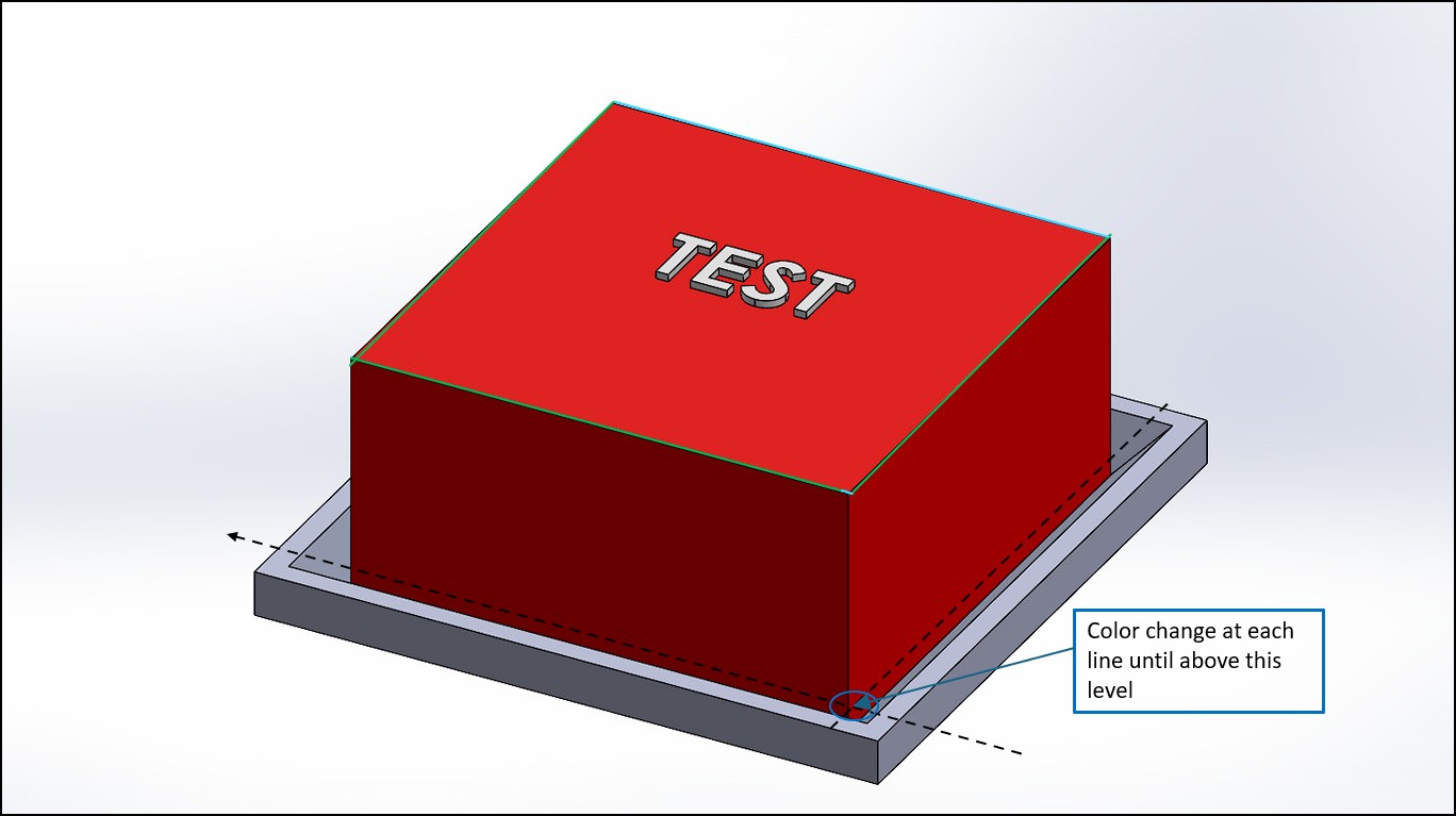

The problem is that the printer can only print a single line level on the Z-Axis at a time. one level is completed, the bed drops one line level on the Z-axis. Any Z-axis containing multiple colors gets a color swap and filament purge until, in your case, you clear the two color line zone. That is why flipping it over won’t help. You still have multiple line levels that are two color. You can count how many color changes there are by scrolling from line 1 up through line X in the Preview tab in Studio.
@Wsquared58 A shelled part is a hollow part. In this case, it would be a hollow cube with 5 sides. Like a box with no lid. If I printed the cube in the orientation as shown, I would need a whole lot of support structures (more material/more print time). Imagine printing the cube shell upside down so no support was needed, then pause the print, flip the cube upside down, and then the final couple of layers would be the white letters on top. Only one material swap required and no support structures. The grey fixture in the picture can be made of the same material of the box. Its the jig that stays on the table when I flip the part to make sure the cube goes back into the exact location as before.

The grey part is the alignment jig and would be made out of the same material as the cube and printed simultaneously. There is a .5mm gap between it and the cube. It’s chamfered on the inside to allow me to rock the cube out of place with out disturbing the jig, then it serves as a centering mechanism when the cube is flipped and placed back on the table.

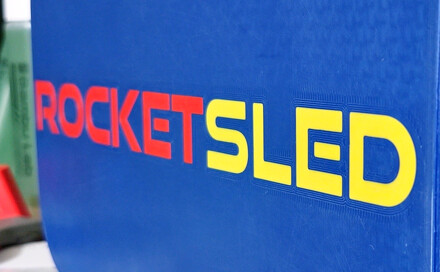

You say you want a relief, I would recommend to make 2 copies of the text: One that you position on your larger part, that is a NEGATIVE part, and is sitting as a 0.4mm (or however much you like) deep cutout. Position this like you see the Benchy text on it’s underside. Then you can print the text seperately, at whatever appropriate height, and epoxy it into it’s cutout home.
Not something I have every tried and am not really experienced in 3D printing inovation but could you print the text seperatly and then attach it (super glue maybe)? edit (maybe make a recess of the test in the shell that the text would fit in but still be higher then surounding shell surface when in place?

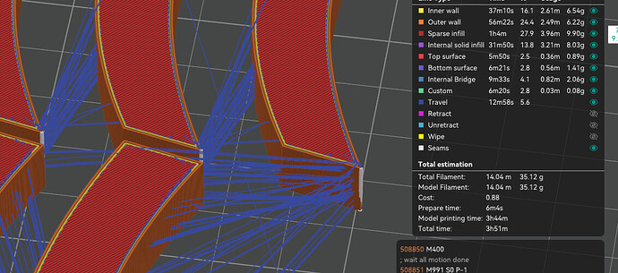

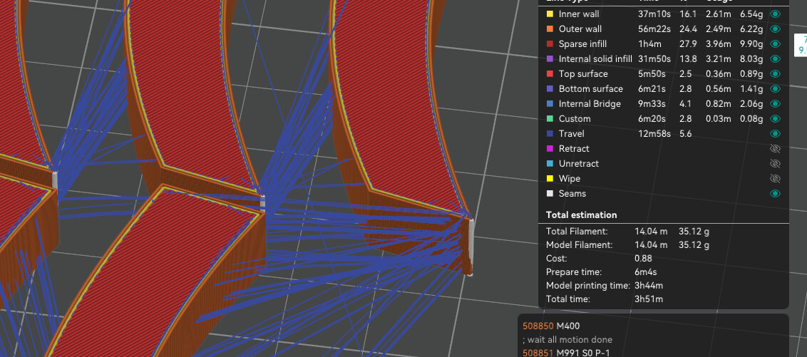

Is there a 3D printer emulation out there that I can simulate the G-Code to make sure everything works correctly before I try it in real life?
Your preview pane does exactly that. Use the sliders on the bottom and the right.
Definitely select “Travel” in line type, to highlight and analyze travel movements.
Okay so that is better visualized.

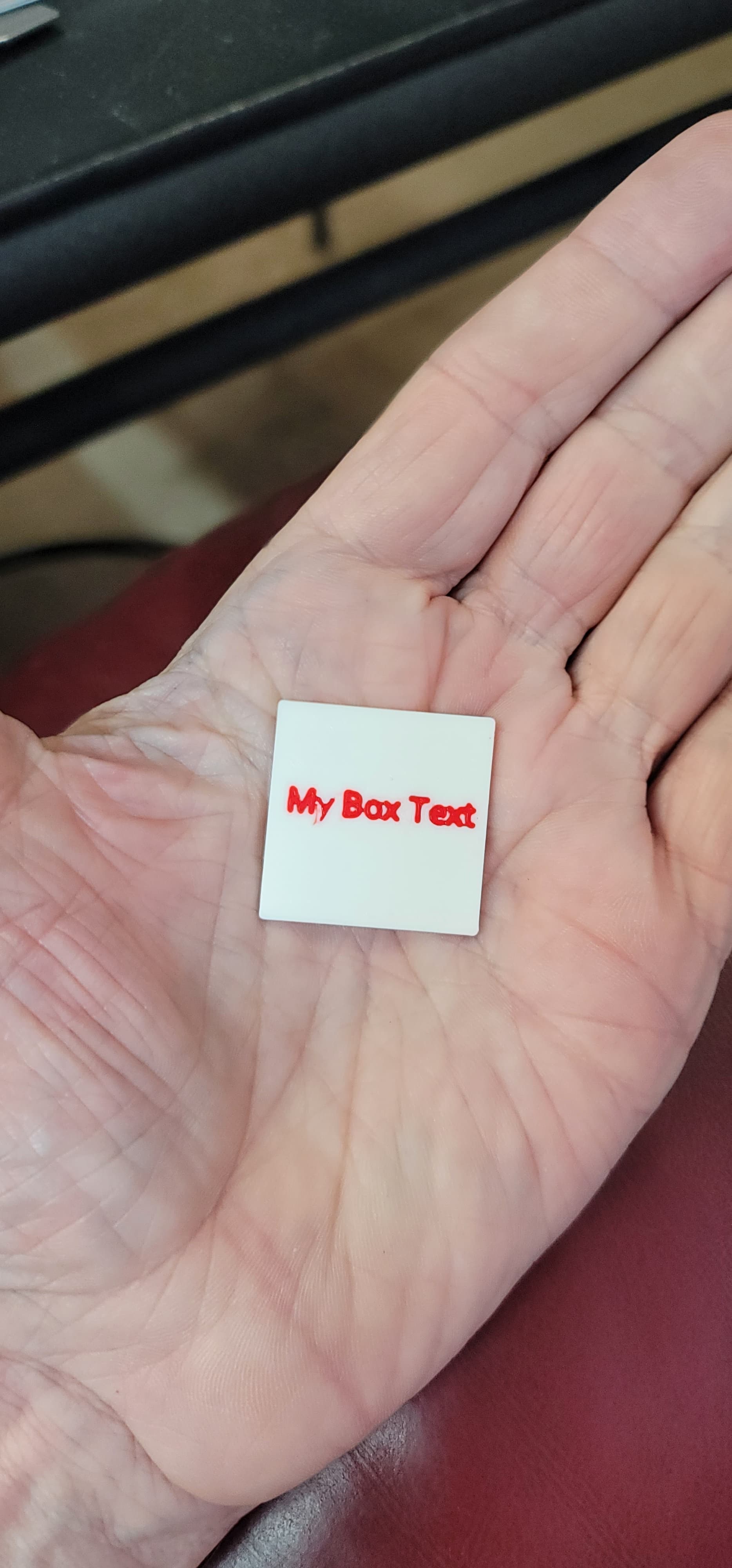

I am printing a test with text facing the build plate right now. I have a project I want to do that I need to learn this process for, but using .svg’s
Here is my first pass using Bambu Studio’s “Add Primative” and “Add Text” options. I learned a few things and certainly can improve but in regards to your question it would save you a lot of work to do the text flush. That was with the text reversed/mirrored and against the build plate.
