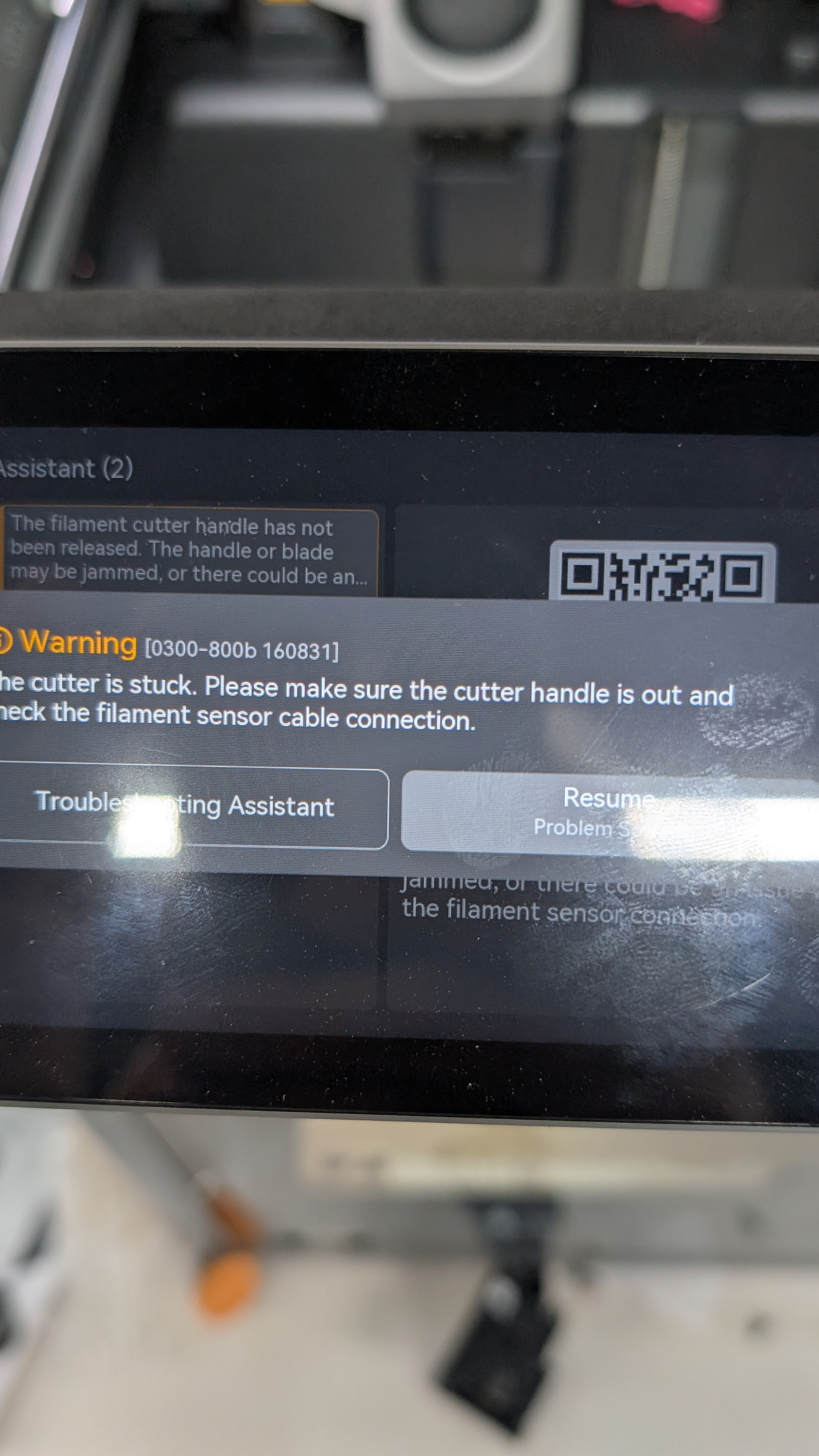

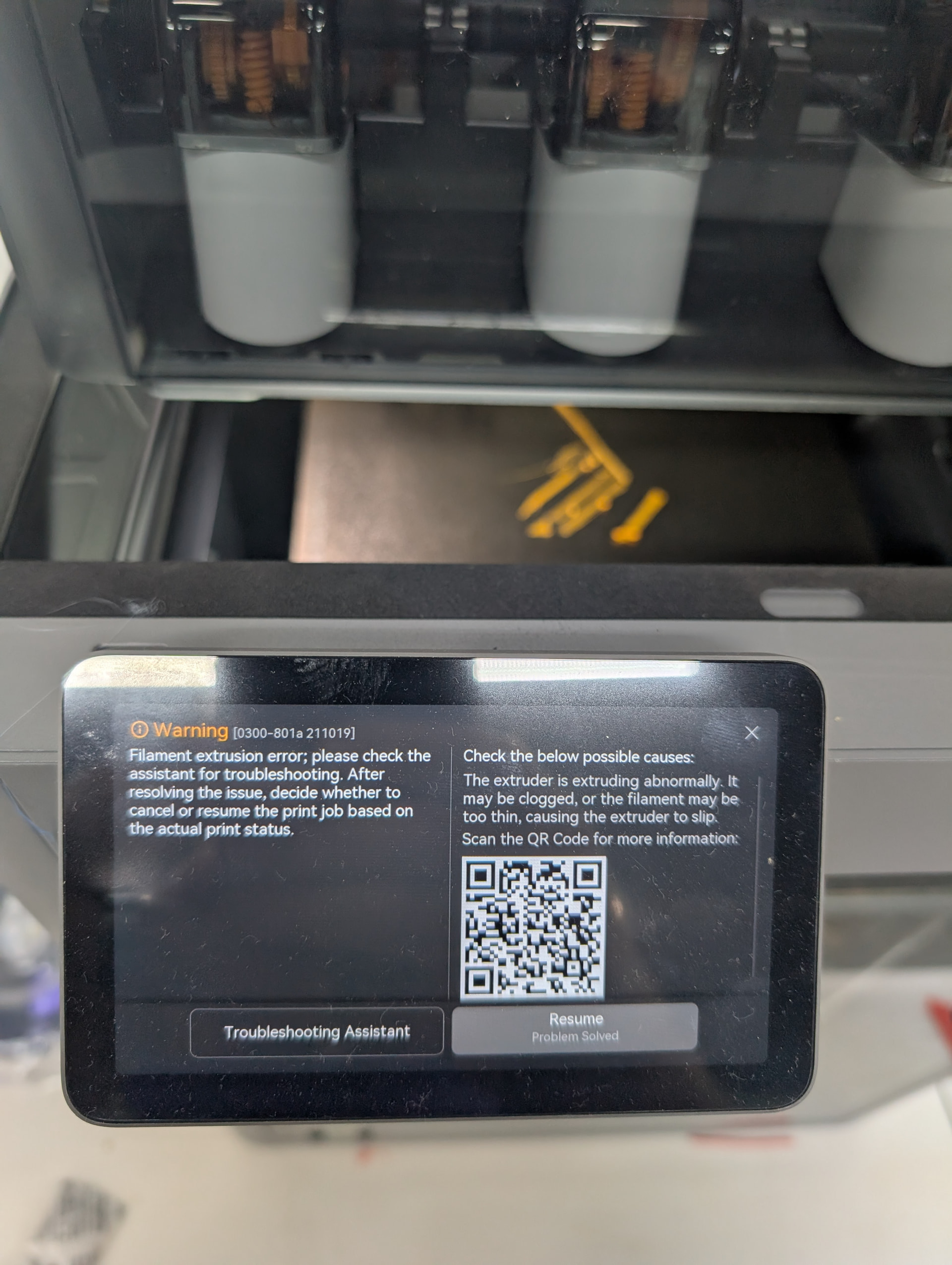

I got my P2S brand new on July 3 and it has been mostly inoperable with extruder problems and cutter errors, despite having now replaced most parts. How do I go about having it replaced or my money refunded?

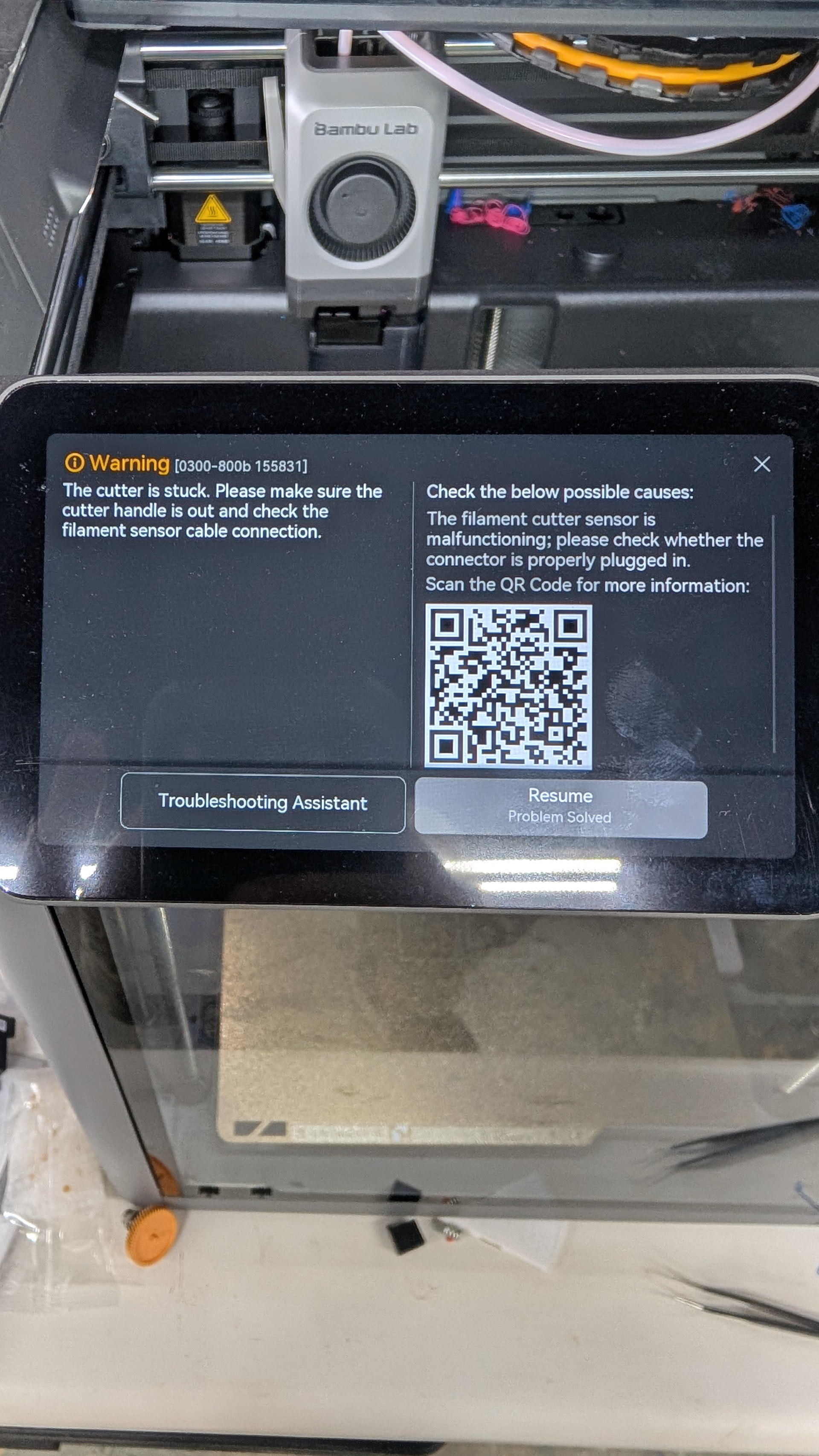

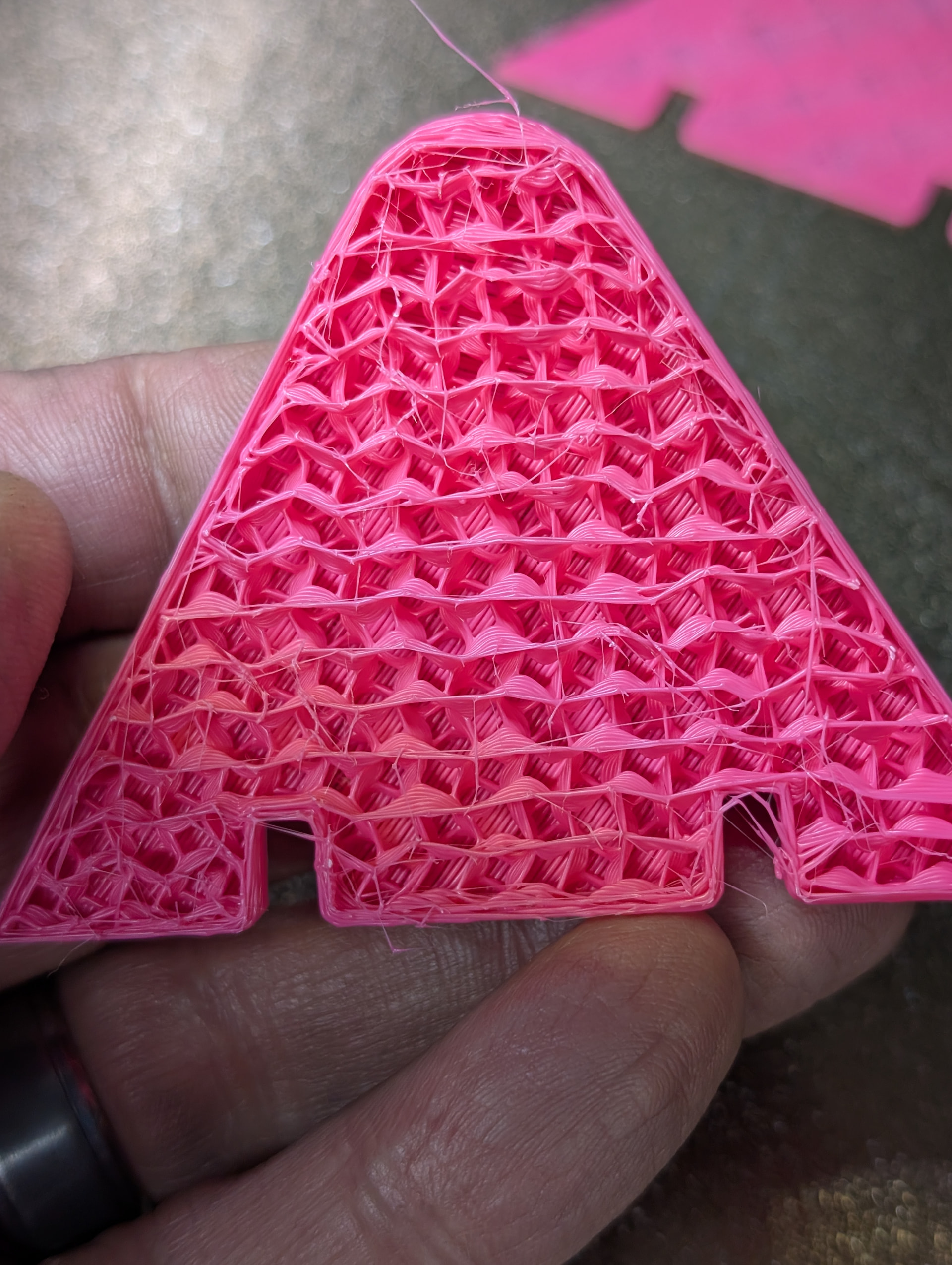

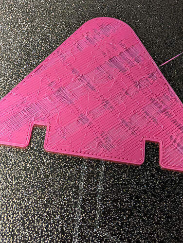

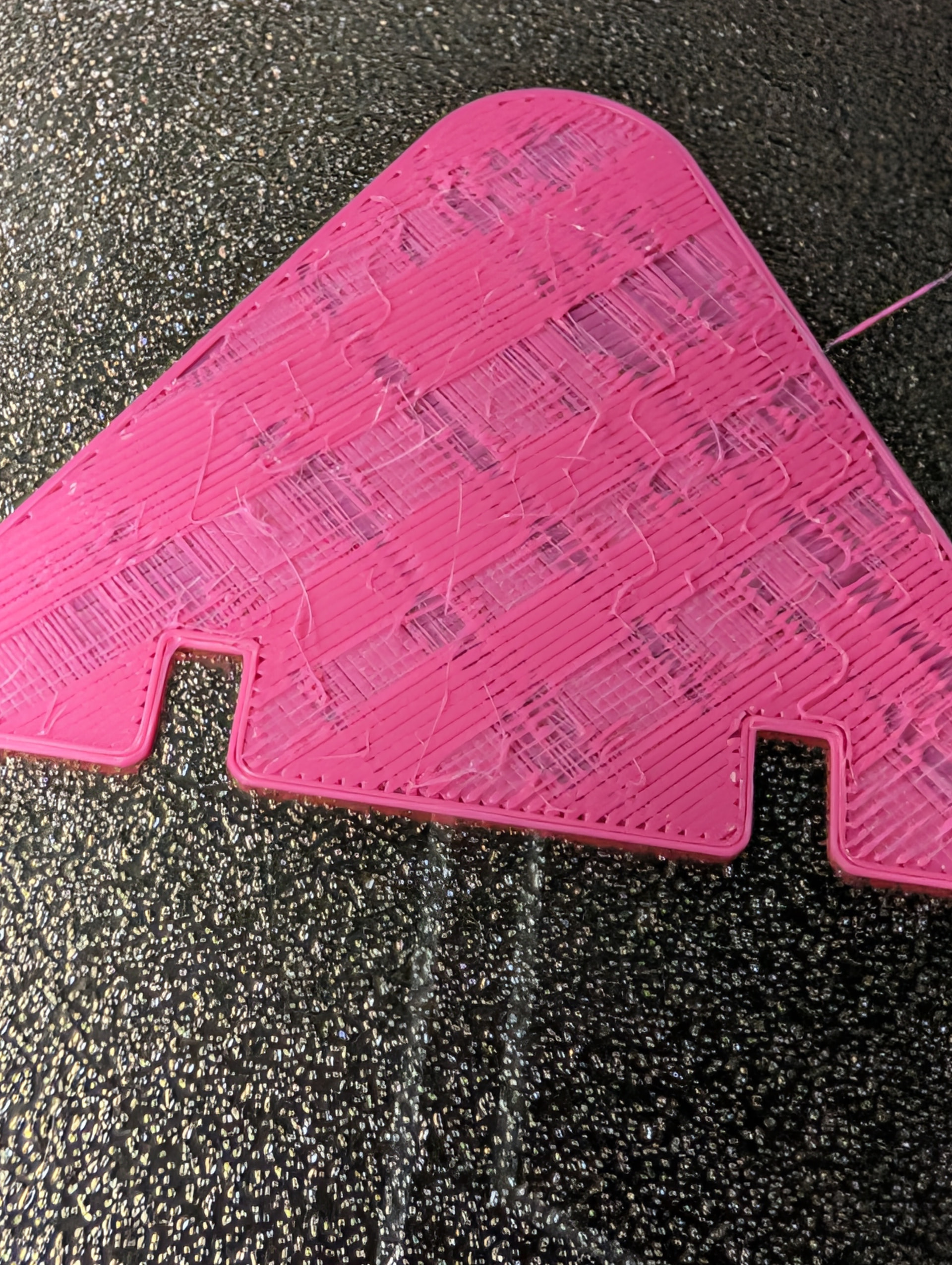

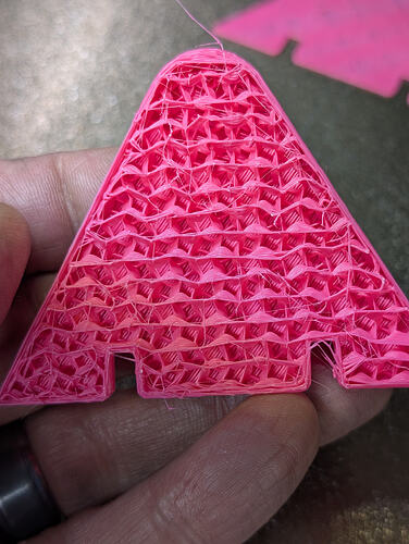

Ha! I do love pizza. It started with extruder abnormal behavior errors, cutter errors, etc. Good print quality for the first few prints and then quality got increasingly worse. Now it won’t print at all because I can’t get past the cutter errors. I have replaced every part in the tool head…nozzle, gears, extruder filament, bearings, front cover, etc.
North Carolina and your prints started ok and got worse. Not a lot to go on but sure points to wet filament.
Drying would likely help. Have you dried your filament?
If you want to know if it’s wet filament, put a spool of filament in a ziplock bag with a hygrometer, seal it, and read the number when it stops changing (about 30 minutes or so).
If above 25% RH at room temperature, you might need to sort drying.

Thank you. I did dry the filaments down to 2
5%.
Can you take off the front cover and take a picture?
I just want to see if everything is in place correctly.

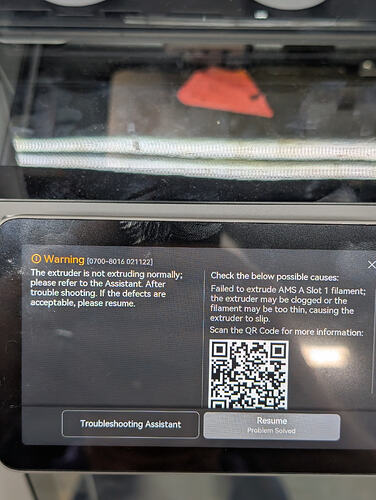

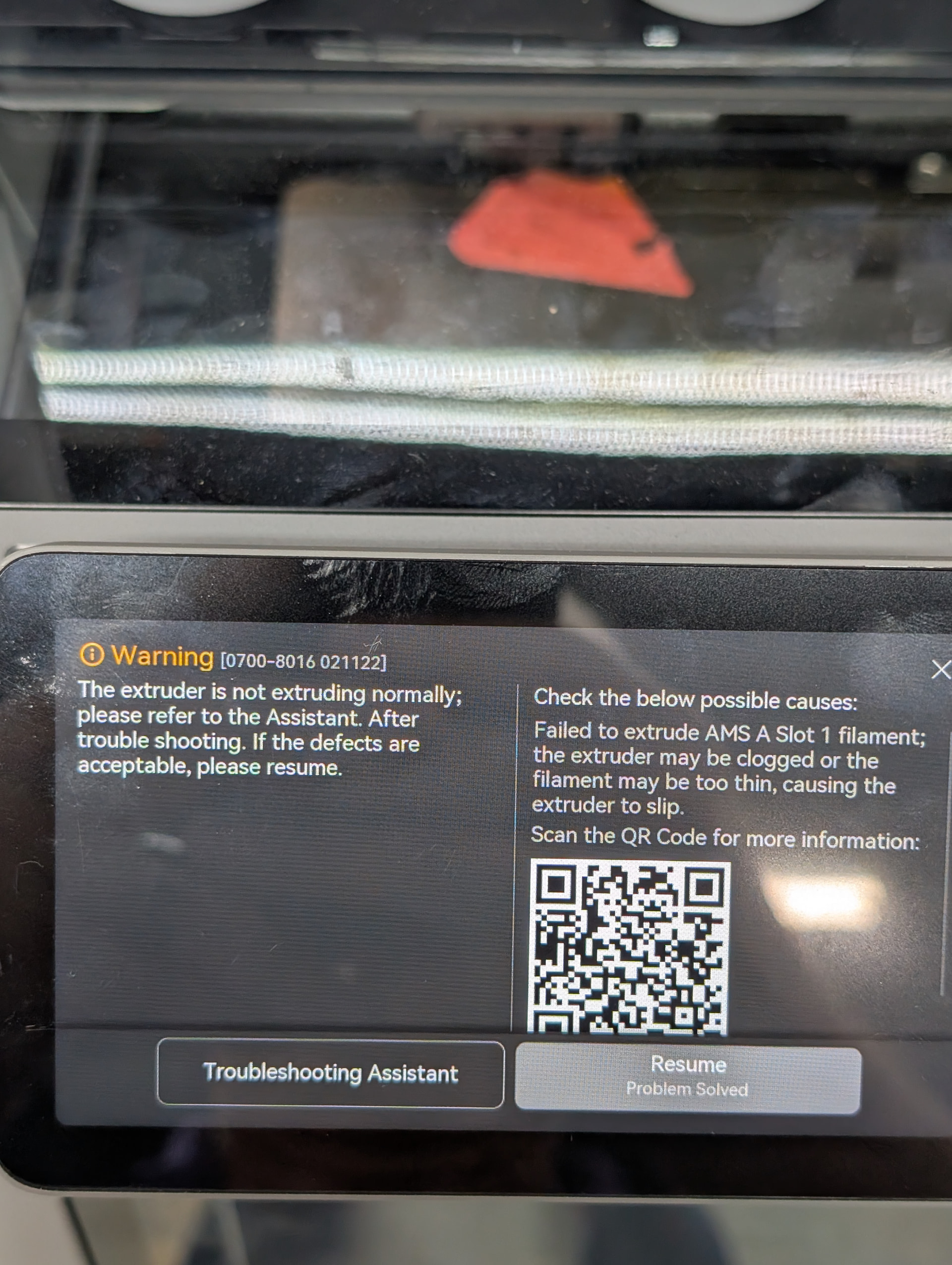

I just got my printer like 3 weeks ago, just abl able to use it like one week, after that is been error and more error similar to your situation,that was the first error extruding abnormally,and after that is has not been printing, been sending message and message
we replaced sensor left eddy sensor, teh right filament sensor the extruder cover and the machine still give an irregular extrusion error and stops the print
Mine starting throwing a feed error today. Fully disassembled from tip to spool. No clogs, debris, all tubes seated fully etc etc. The extruder just simply refused to pick up the filament unless I take the AMS off, use the single spool on the back and push the filament gently. Its like the filament isn’t making it to the teeth or the teeth aren’t grabbing it unless its pushed on.
