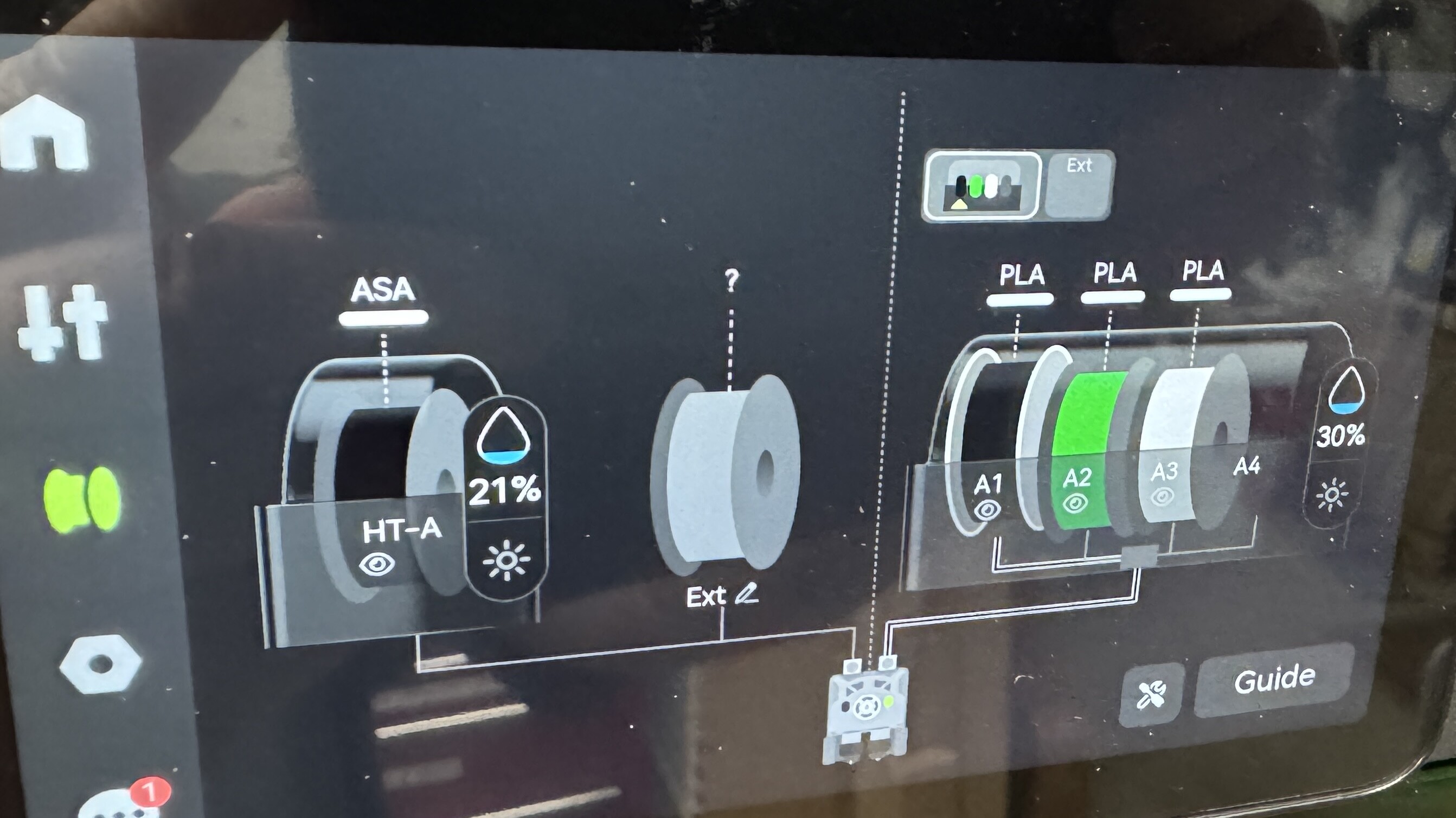

How do you unload Filament on H2D with AMS PRO2?
It only has
Edit
Load
Re-Read
Does Re-read mean unload here?
If “Unload” is not there that means that filament you are clicking on is not currently loaded into the hot end.
What maximit said. Also the re-read is just for reading the rfid tag.
It’s so weird. I never seen Un-load option.
ummmmm…
If you hit the “load” button and wait for it to finish, the “unload” buttons will magically appear, I promise. :joy:
But on a more serious note. You should not see “unload” in regular operation of the AMS as all of loading/unloading is done automatically, thats the A in the AMS. The only time you should see it is if you are loading/unloading non AMS compatible filaments like TPU, PA etc from external spool manually or you hit “stop” mid print.

So we loaded the TPU and it’s not letting me unload it
If its unloaded but still shows it there: Click Reset on the H2d Screen and then click Confirm.
Ran into this problem with the external spool today. Tried everything else, nothing was working. Power cycled the printer and the Unload button finally showed up.
Same issue. Power cycling did the trick. Thanks for the suggestion.
“The only time you should see it is if you are loading/unloading non AMS compatible filaments” how does this make sense to you? If i want to switch out a type/colour i just don’t get an unload button unless bambu thinks i should?

Thanks for this. I’m brand new to 3D printers and Bambu and during my first print I got an error saying there was too much resistance in the PTFE tube and I needed to shorten it, but figured it wasn’t safe to just pull it out and that there had to be an unload feature.
The trick was opening the edit menu on the filament bay that needed unload and the option was there.
Okay but I’m too daft as a newbie to figure out what that means.
“Edit menu”? Is that a settings menu?
“Filament Bay”? Where? On the printed screens the only options I see for the ams2 is refill/setup/drying.
If I select the indicated spool of the ams on the printer screen it highlights , but there are no options to do anything. The wrench again deselects that spool.
So I’m stuck trying to solve to problem of getting the ams2 to fully retract the filament that is in the PTFE tube so I can “untwist” it a bit to lower the friction. Ugh
Update after Bambu Support got back to me. At some point there were options for the spool that showed up on the printer display. They suspect that as the printer still hand a paused print job going , this the spool options were not displayed.
So if need be - cancel all print jobs to make sure the printer is idle. Then the spool should have an unload option that will bring the filament all the way back into the AMS. So if you get a filament feed warning during a print job, there isn’t much you can do about it even if you pause because the printer won’t allow you to spool the filament back to unravel the PTFE tubes , for example.
