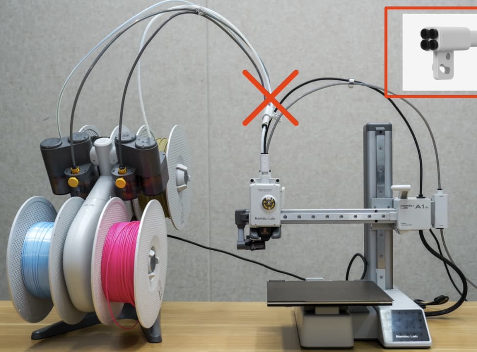

I’m a little confused about something. I was planning to do this…
… so that I would not have to totally discard my AMS Lite but I see from the big red X That Bambu does not want this done, predicting “loading failures”. Why?
Now, I KNOW that I can’t use both the Lite and another AMS at the same time, but my thinking was, use the 4-to-1 PTFE adapter with the 4 AMS Lite tubes plugged into it, and when I want to use the Lite, turn off the system, unplug the control cable for the new filament buffer (and the new AMS) from the printer, plug in the cable from the Lite, and plug the output tube from the 4-to-1 PTFE adapter into the toolhead and turn the printer back on. The AMS Lite should work normally. Since the 4-in-1 adapter simply passively funnels four tubes to one outlet it should work just like all the adapters you can print to plumb another filament source into one of the PTFE tubes. My reasoning is that when either AMS setup is connected to the printer the other is disconnected and inert and the printer would not even know the other AMS existed. Why will this not work?
Another possibility I see, unplug ONE PTFE tube from the Lite from the toolhead, plug the tube from the new filament buffer in that open port, and swap the control cables. Will THAT work?
I just don’t want to turn my AMS Lite into an expensive doorstop.
Bambu Lab have stated why you need the new buffer and why you can’t mix the AMS Lite with any of the other AMS units.
The A series has a buffer in the print head and those gears do the work the AMS itself does.
The new buffer balances the AMS, AMS 2 Pro and AMS HT so it doesn’t damage the A1 print head.
The software connected to the firmware requires you choose between AMS Lite OR the any one ir more if AMS, AMS 2 Pro and AMS HT.
You can’t combine them or risk damaging the print head and more.
This is far more than pushing filament into a PTFE tube.
Now all the warnings are out of the way.
You could toggle between two different setups, just not at the same time.
You would need to unplug bus cables and things will get complicated.
Why do you think two different setups into a single printer would be good?
