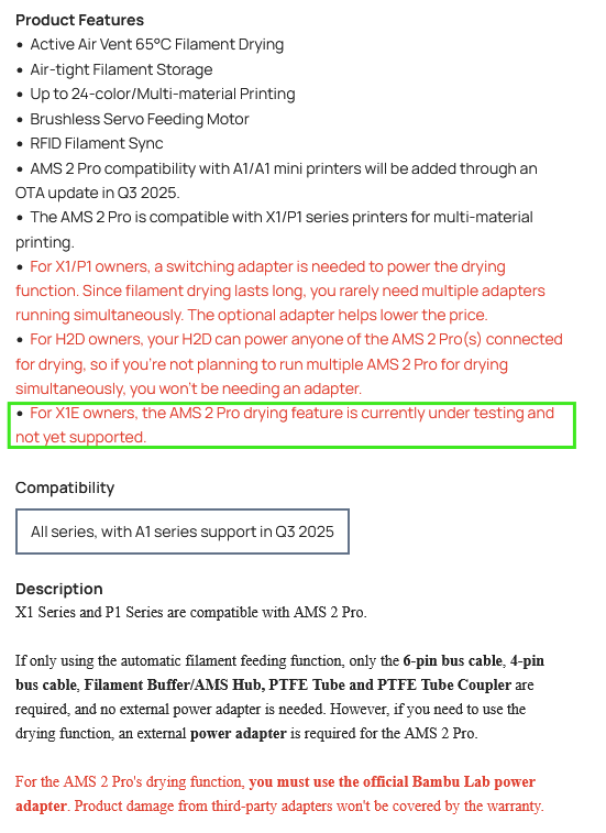

Is it just the drying feature that isn’t working with the X1E?
TL;DR: It would appear so. :slightly_frowning_face::frowning_with_open_mouth: Speaking as an early 2023 P1P customer, I feel your pain.

I just got an official reply from Bambu Lab Support regarding AMS 2 Pro compatibility with the X1E.
They confirmed that the new firmware for the X1E — the one that should include AMS 2 Pro support — has been postponed to Q4 due to ongoing testing and other issues.
So for now, AMS 2 Pro is still not fully supported on the X1E, but it’s planned for one of the upcoming OTA releases later this year.
Hope that clears things up a bit.
— Wlad
