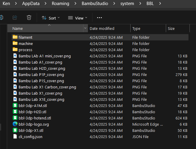

Mine is stored a little differently. Could be I’m on Windows 11 but I don’t know for sure. Here’s a screen grab of a portion of File Explorer.

You´re correct. TY.
I already updated it.
Note that System/BBL/Filament relates to the System Filaments… in the user folder, you can find your Custom ones.

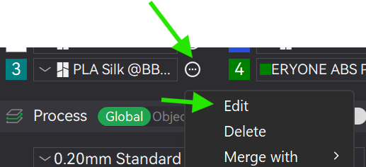

Take the example.
Press the filament three dots icon, choose Edit from the menu:
You can notice in the name that the filament settings relate to the project .3mf file, i.e. Sphere.3mf.
If you want to save it as a custom filament and not as a project filament, you press the save button, rename it if and as you wish, and then press the OK button. It will be saved in your custom filament presets.
Now you still have the option to save the project or not:
  • If you save the project, it will replace the Project Filament with your Custom Filament in the .3mf file.
  • Otherwise, the Filament Settings were added to your User Filament Presets (Custom filaments), and the .3mf continues to include a Project Filament, even if identical.
