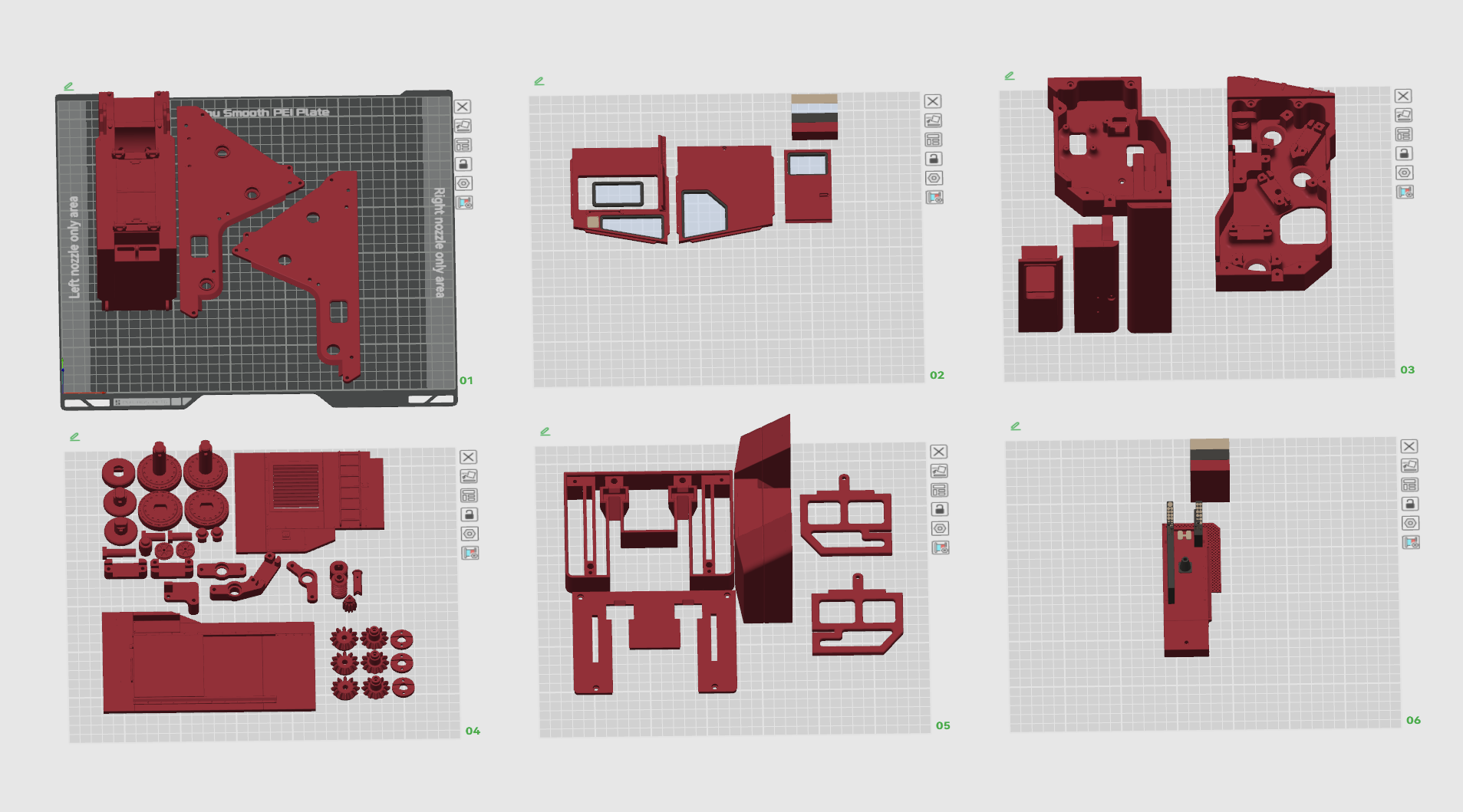

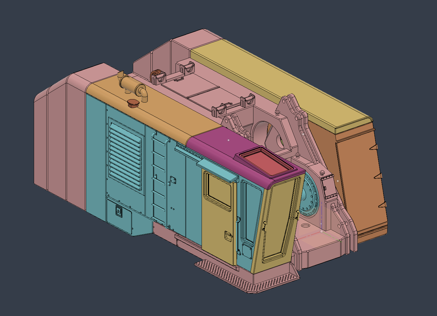

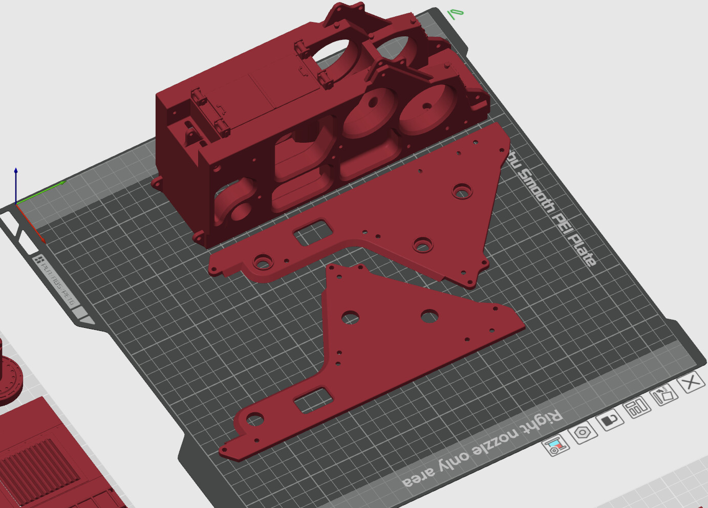

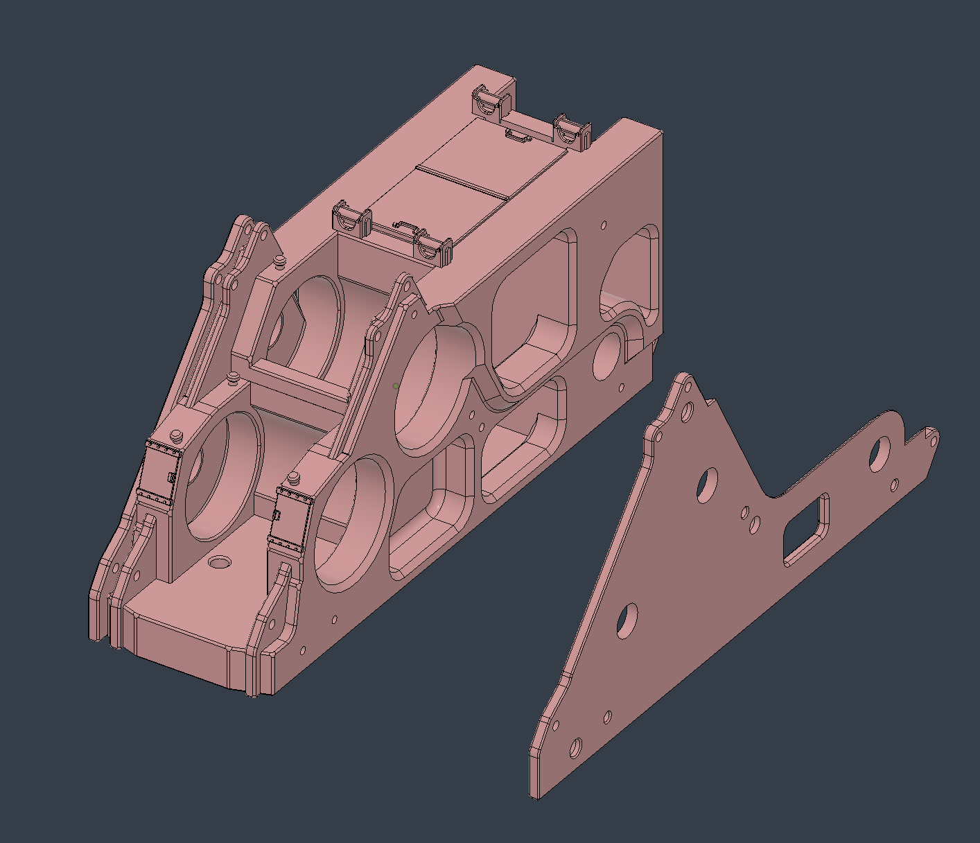

Here’s a model I’m working on, along with a shot of the plates as they’re shaping up.I work to avoid using supports at all, as I want as much as I can to print from the bed up, having a solid foundation. I try and avoid steep overhangs that’d require supports.
There’s a number of things, like on the counter weight. I broke it up in a way that I could get clean looking surfaces, especially on the chamfered top edges. I wanted to assemble it in a way that it could be filled with ballast, but also be strong, but also be easy to print, but also be easy to assemble. It’s all of those things.

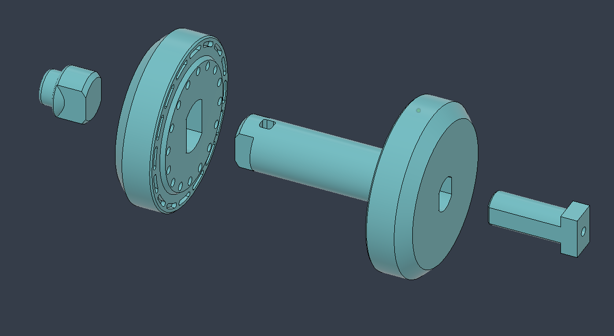

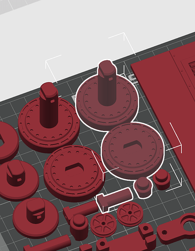

This is one of the hoist drums. I’ve actually seen people 3d print objects like this as a whole, and ugh. Why?! I broke it up into 4 piece.
the other area I wanted to mention on is with the main frame of the body. I broke it into 3 pieces, with these two outer plates being laid flat. I did this because it’s a crane, and we’re going to be attaching a heavy boom onto this thing. Having that flat orientation for the side walls, it gives me the strength I need. The main frame prints from the bottom up and works and looks great this way. If I tried to turn the whole thing on it’s side, that’d be a mess to try and print. If I kept it as a whole printed straight up, then the force of the boom would be pulling against the layer lines
Hopefully this all makes sense. :sweat_smile: Pardon my ramblings here everyone, I just. I think about this stuff a lot, haha.

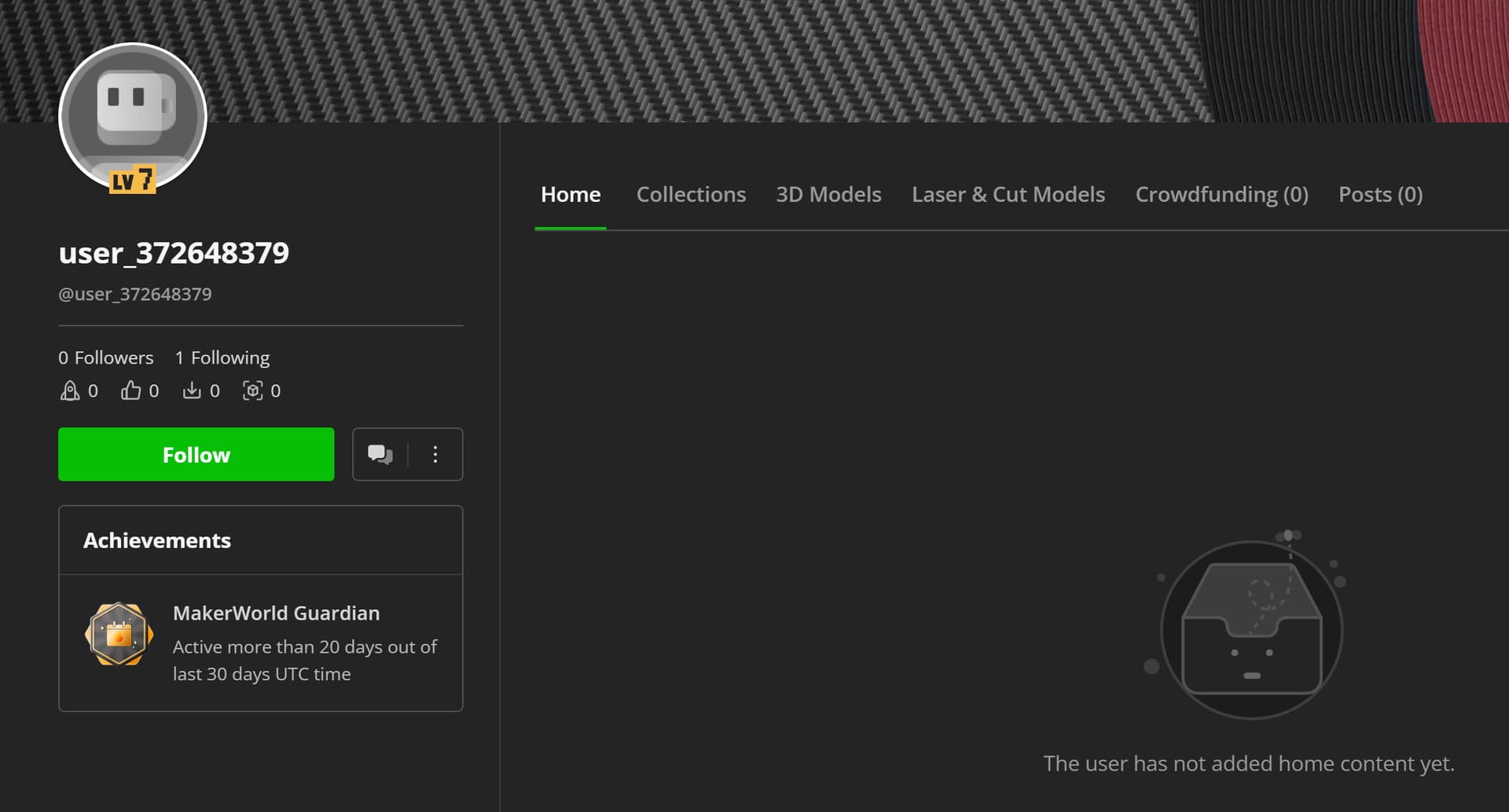

Since you are new to the forum, I would just like to give you a piece of advice:
You can view other people’s profiles, both in the forum and in MakerWorld, to get a rough idea of how long someone has been active and how much they contribute to the community. It’s just a tiny point of reference, something you should do before you start throwing around phrases like that. :+1:
As an example, just to show you, anyone can see your profile, which is empty:
Of course, whether a profile is full or empty does not make an opinion more or less valid, but you can see how long someone has been active and contributing to the community. Just to give you something to think about. :+1:
