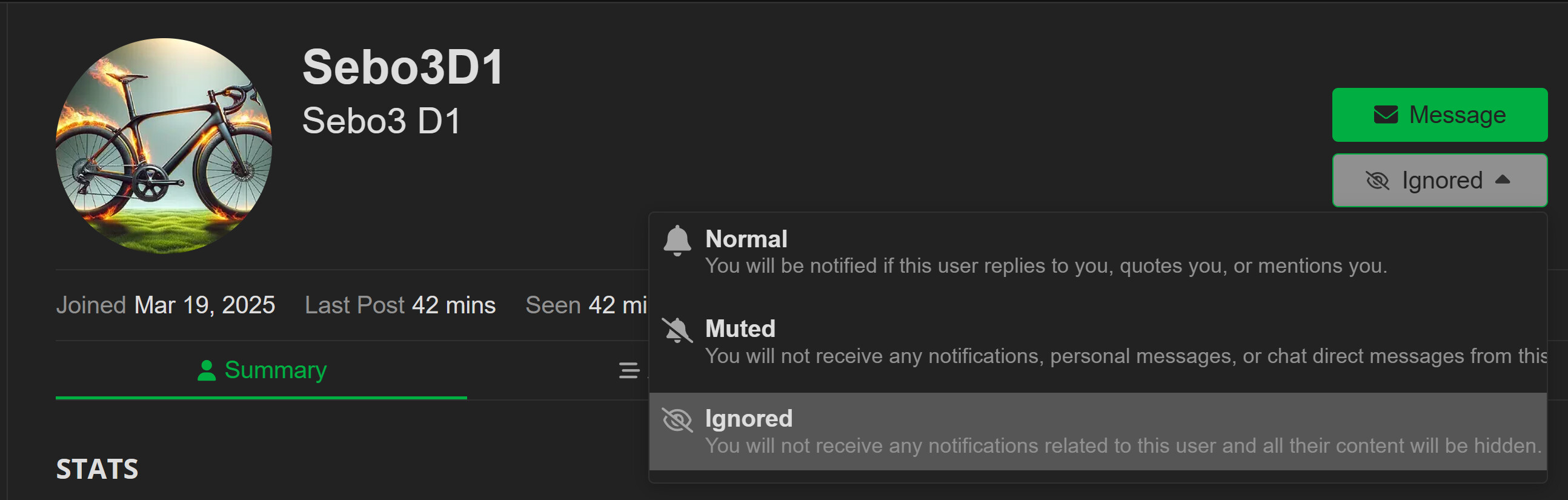

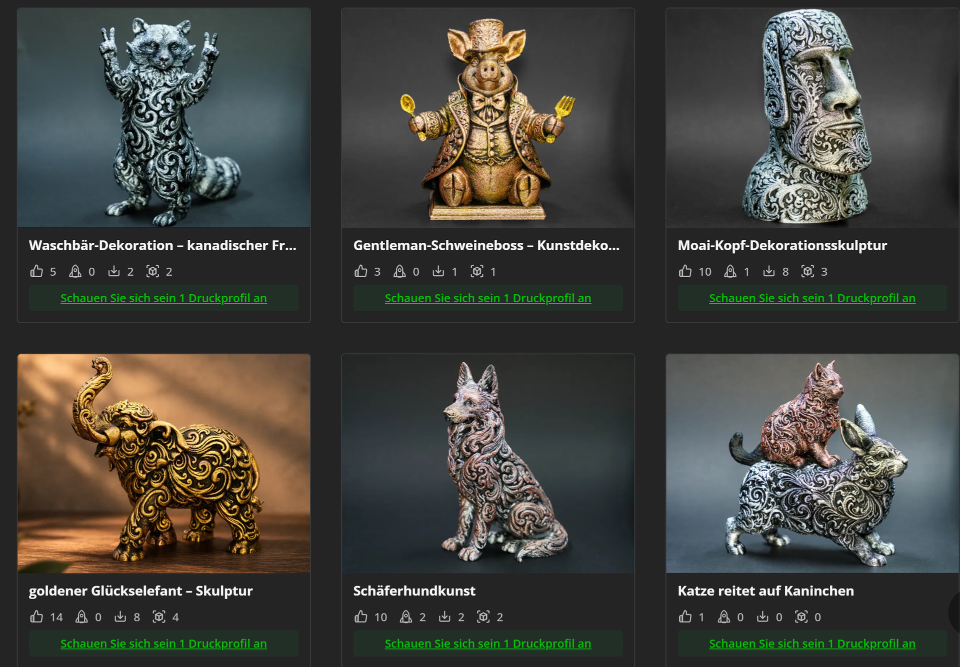

Strong words from someone who’s flooding Makerworld with AI slop. I went ahead and blocked your Makerworld account too.
