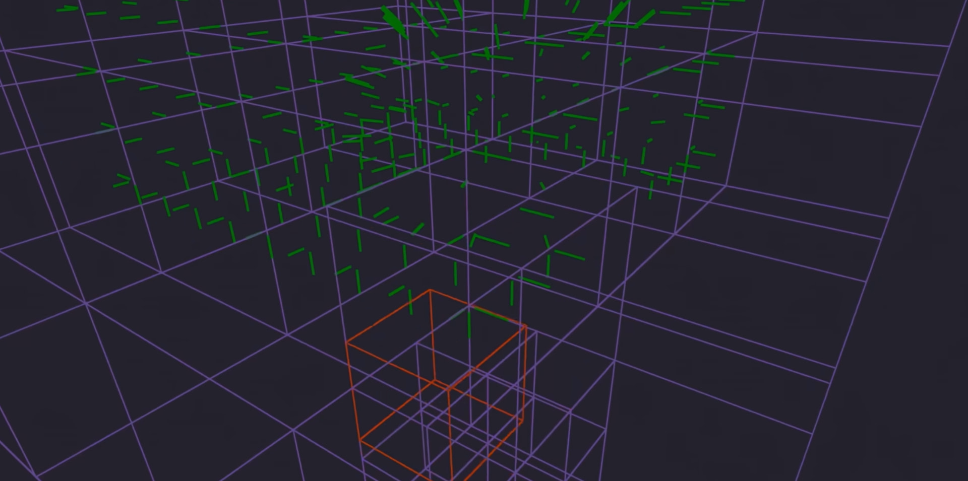

This is the section where the G-code was scanned virtually. No printing is involved in the first step. The video starts exactly at this point - timestamp.

Unfortunately, it doesn’t explain how the measurement or calculation was performed. It seems to me to be a mathematical estimate? Does anyone know how it was measured? I can’t find any information about it. I’d really like to know.
As far as I know, no one has ever measured it with such precision as the research team did. This is because there wasn’t any software available that could measure it; they had to program it themselves.
Edit: or how they describe it.
This study investigated the geometric and volumetric accuracy of G-code generated by five commonly used slicing software packages: PrusaSlicer, Cura, Simplify3D, Slic3r, and Fusion. The comparison was made between reconstructed models derived from the G-code and the original STL files.
A custom Python-based pipeline was developed to extract point clouds from the G-code, apply geometric corrections, and compare them with the reference meshes. This allowed for precise assessment of slicing-induced deviations independently of printer hardware. The discussion below addresses the validity of the registration method, the repeatability of slicing outputs, the accuracy of the slicers across multiple models, and the implications for clinical use and process validation.
This also explains quite well why no printer was used in the first step, in order to rule out factors such as filament and shrinkage.

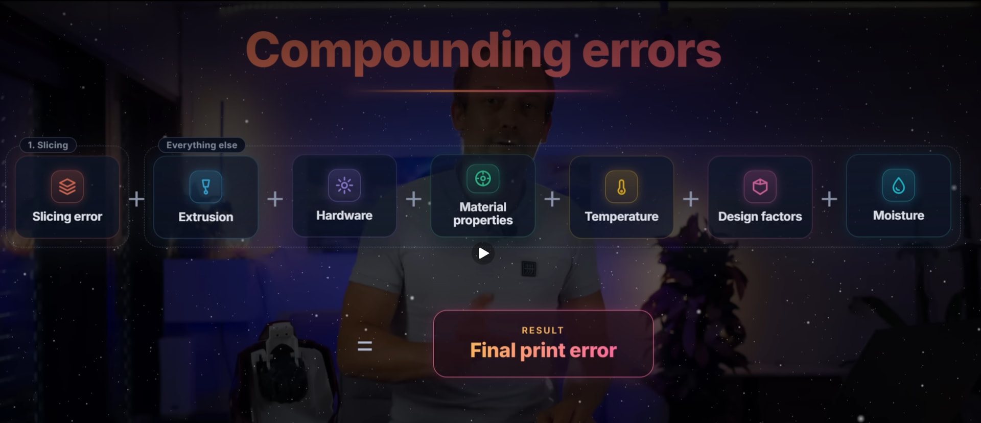

I’ve mainly chalked up the tolerance discrepancy to everything after “slicing error.”
But I always suspected that there’s more to it than the 6 usual suspects. Going from a computationally generated screen render to a part that you hold in your hand means the first step - translating that model to machine speak (gcode) - isn’t so straight-forward. Meshes speak 3 dimensionally and have the benefit of producing curved shapes as smooth as your graphics card can render it. Printers speak line-plotter-y which is an entirely different thing. Yes, that’s a scientific word now.
