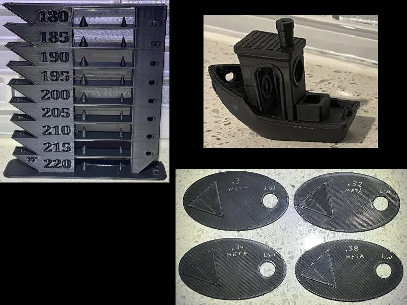

1. Order.
What sequence do you actually run?
My understanding is: temperature (temp tower) → Flow Dynamics / Pressure Advance → Flow Ratio → Max Volumetric Speed → then the process settings (walls, infill, speed).
Is that the right order, and is anything missing before or after?
2. Stop criterion per step.
This is the part I never find documented: how do you decide a step is “good enough” to move on?
- On a temp tower — do you pick the lowest temp with clean layer bonding, or something else?
- On Flow Ratio — what exactly are you looking at on the print?
- On MVS — how do you read the failure point?
