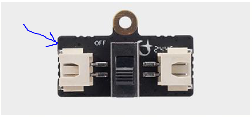

If you’re designing a new Cyberbrick design that uses the 7.4V battery, then, IMO, it would be better if you use the ‘off’ side of the power switch for the battery connection.
The way the slider switch is wired, the ‘off’ side connector ‘+’ pin is connected to the center pin of the slider and the other connector is wired to the switch pin opposite the mounting screw.
With the battery connected to the ‘off’ side of the switch, the switch will operate normally, connecting the battery to the core when switched on. However, when switched off, the battery is NOW connected to the used pin on the switch. If you connect your charging cable to that side of the switch, the charger will ONLY be connected to the battery when the switch is off…

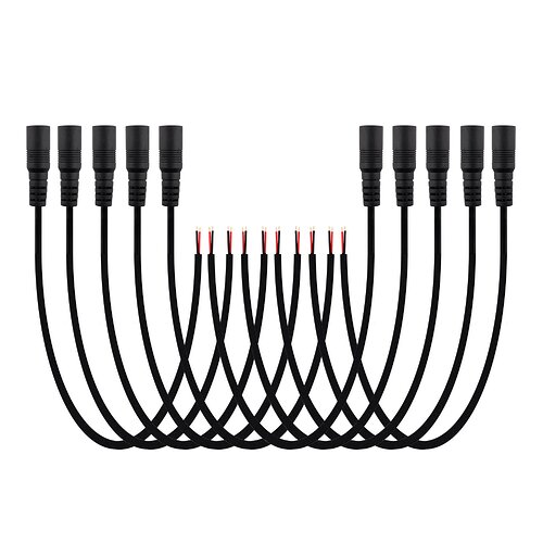

I mount this type of cable inside my units:

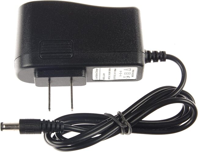

And use this charger to charge them:

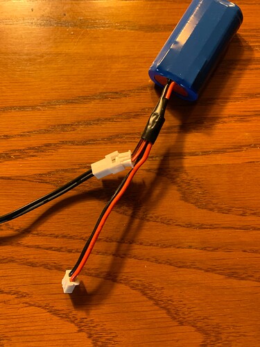

It has been awhile, this battery has been sitting on my workbench for 2 months waiting for me to feel up to solder on the plug. For the train project I decided to splice in a XH2.53 male connector so that all I needed to do was plug in the charger that came with the kit, while the locomotive power switch is turned off. Don’t need to unplug the battery from the on/off switch, which is pretty hard to get at.
