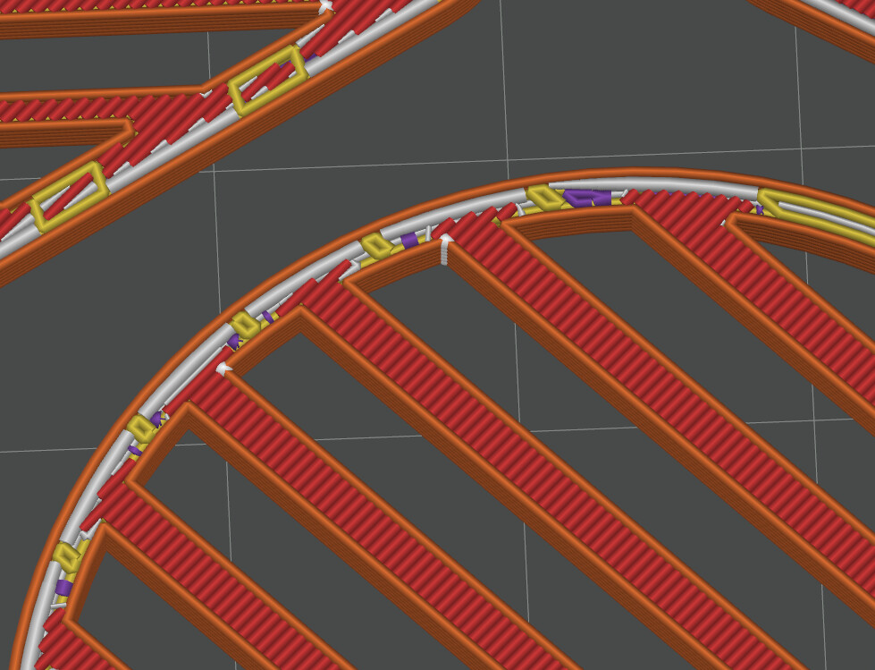

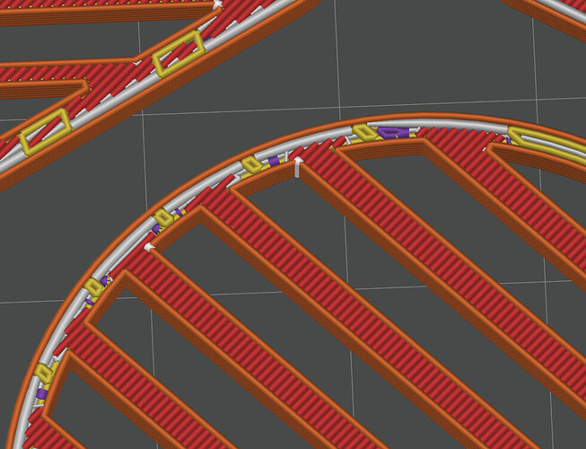

How to config Top surface not close?
i need top surface like
but in studio close top surface like
need disable option ?

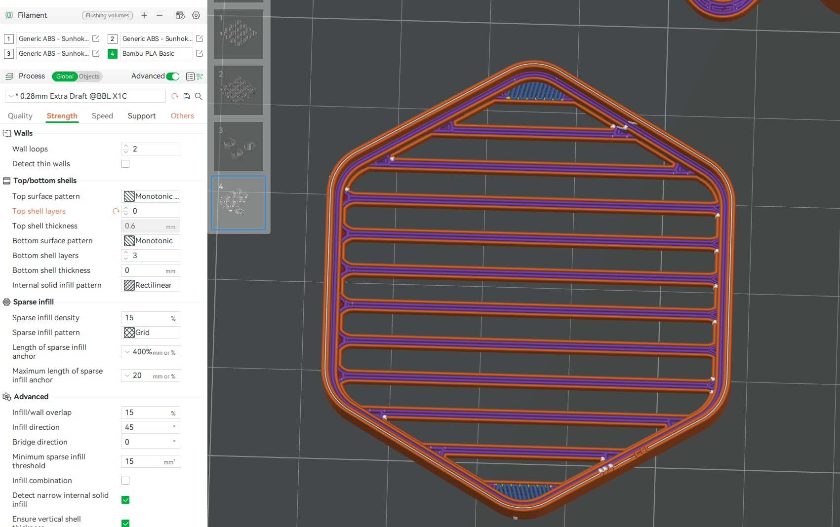

Maybe setting “Top shell layers” to “0” works.

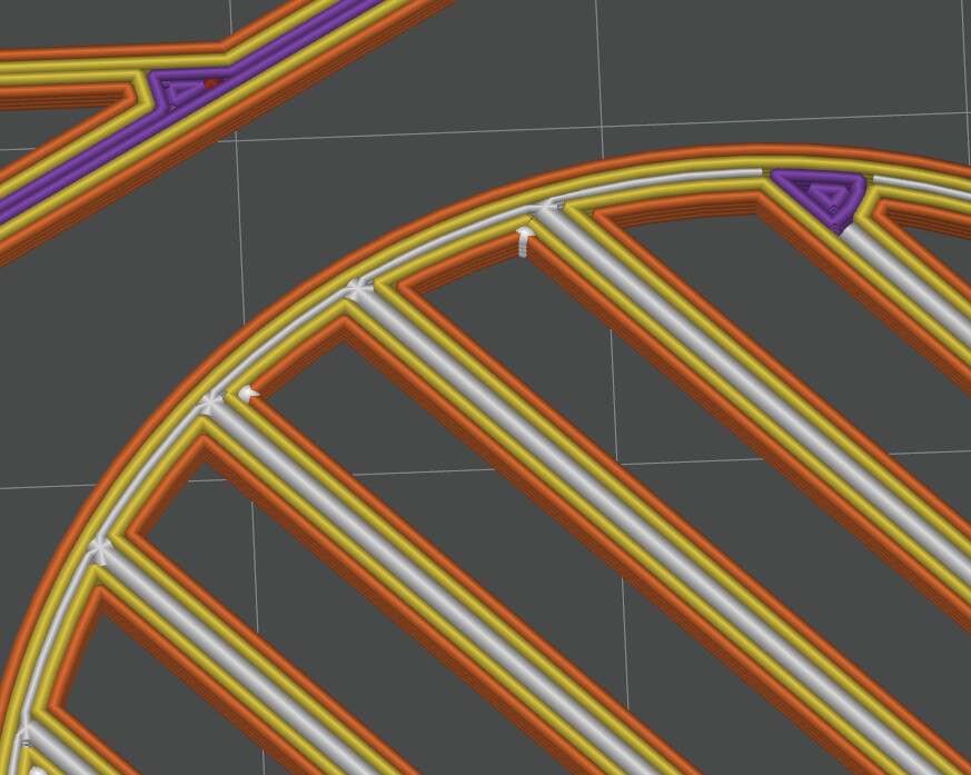

i try it ok need layer = 0
