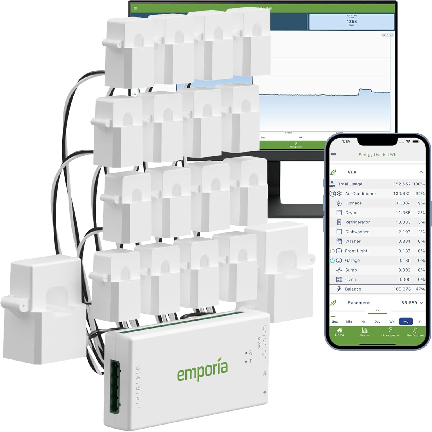

I had the printer plugged into a watt meter (I installed a dedicated circuit, so there were no other loads) and watched it the entire time. I personally would not leave it un attended due to the 15A rating on the watt meter. Ive done a couple of prints and verified the reading. I also have installed at my home a energy monitor on my main panel with individual current transducers where i can monitor current usage on certain circuits from my phone. I get similar results from the energy monitor readings. The watt meter is more accurate on small loads verified with my quality fluke multi meter.

Cheap home energy monitor. That is UL certified.
