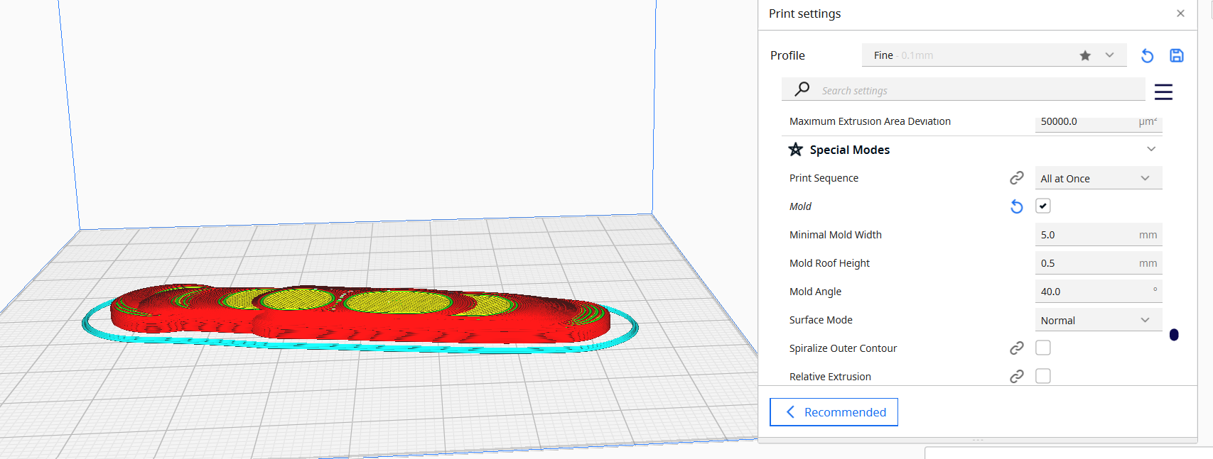

How to enable mold mode in BS(like cura)
I would like to use mold mode like Cura to create concrete molds out of TPU filament but cant find the settings. vase mode makes the mold too flimsy. Cura doesn’t like to talk to P1S

I just ran a trial with a simple shape and an old installation of Cura (5.5).
After slicing for a mold in Cura, I could save the gcode file to my drive and then just drag and drop it into Studio.
Maybe worth a shot…
