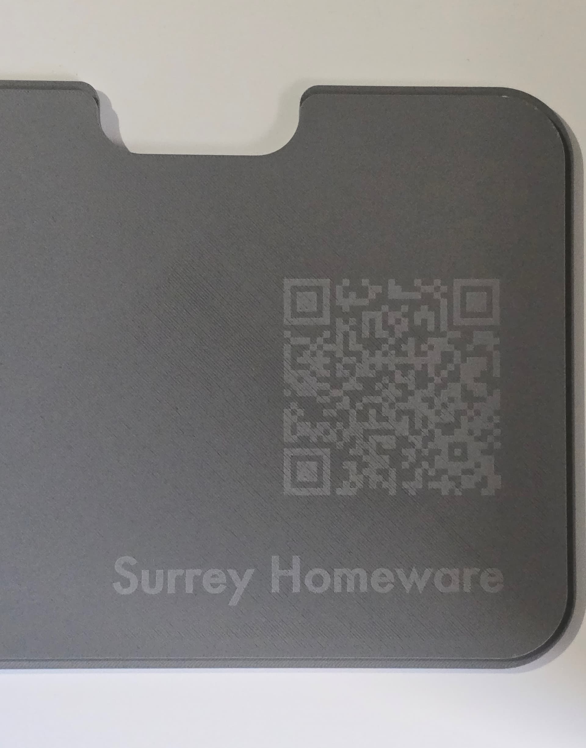

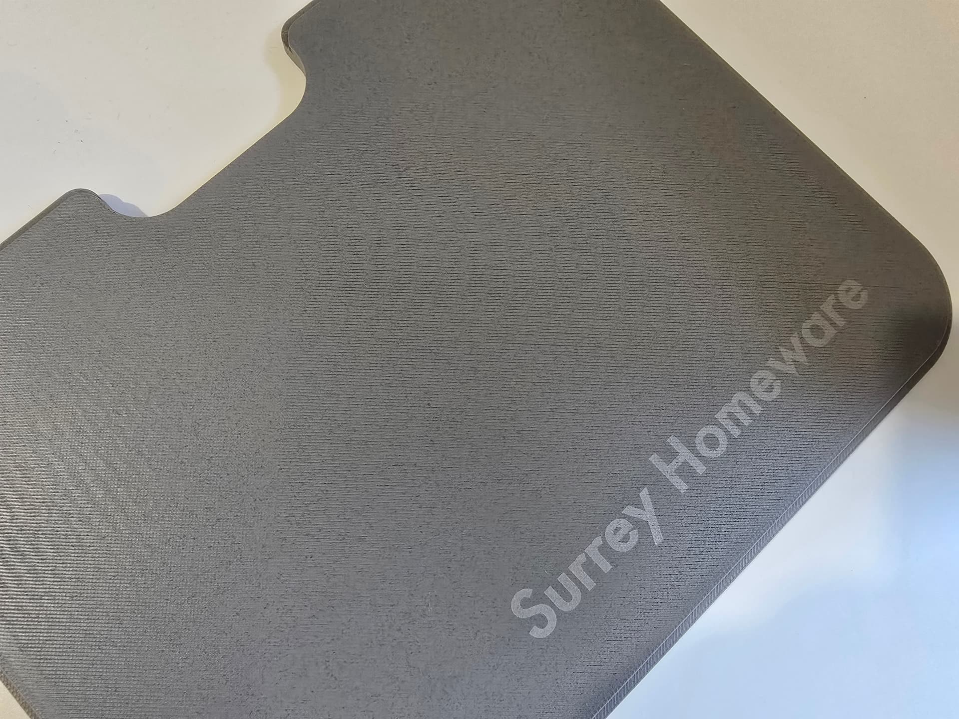

No one is talking about it, but you can directly engrave your PLA prints with your H2 laser module. It’s a fun way to add professional-looking branding, labels, or even QR codes to a print. Laser engraving is quick, so it only adds a minute or so to your production time, and the results can look a lot clear than 3d-printed text at small sizes.
The feature to engrave PLA prints is buried in Bambu Suite and is a little tricky to figure out the first time. Here’s what worked for me:

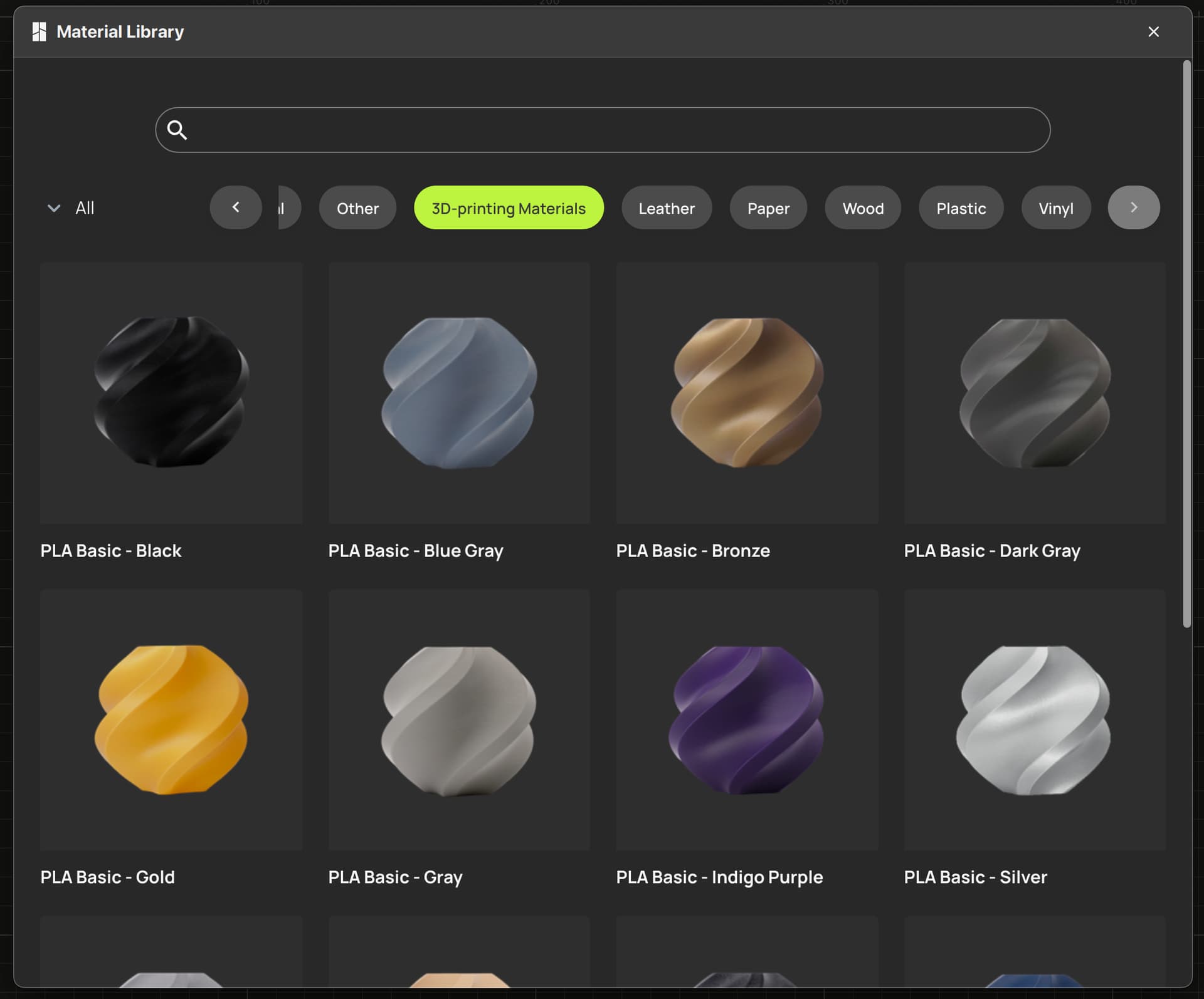

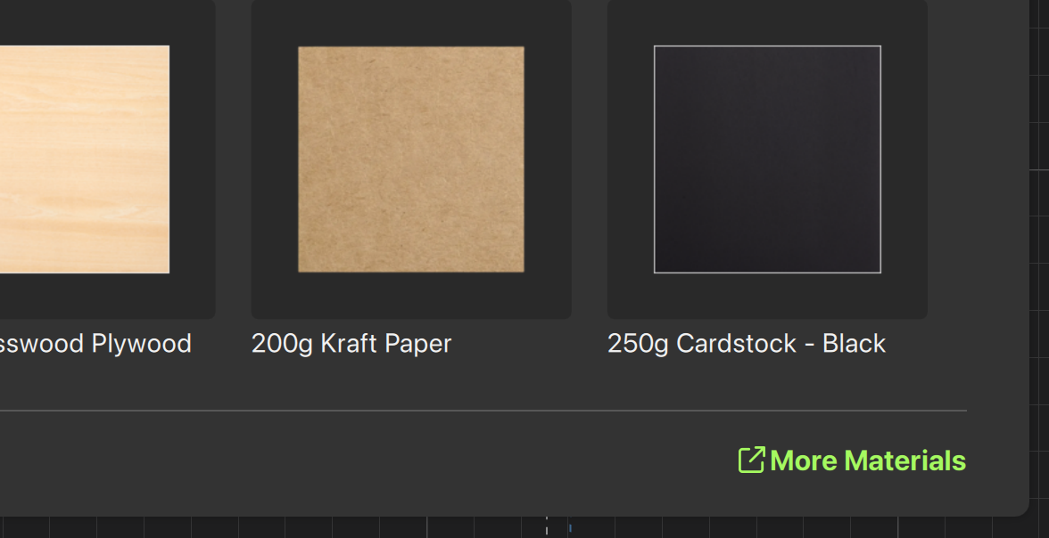

  1. When choosing the cutting material for your project, click on the “More materials” link at the bottom of the list:
From there, click the “3D-printing materials” button, and you will be shown a list of PLA colors that are supported.
This part is really important. You can only engrave the colors listed here (more or less). Because of the wavelength of the blue laser, some colors just won’t engrave at all. So try all you want, but you are never going to be able to engrave white PLA.
Choose the profile that matches your print’s filament. If you don’t want to experiment, use the exact matching Bambu filament for your print.
Of course you can try engraving other brands of PLA with different coloring, but you may have to try a few different pre-sets in the list to find the one that works the best for your material. For example, Bambu provides three different “gray” material pre-set that each use wildly different laser power settings. The “PLA Matte - Ash Gray” worked great for me on a Sunlu gray print, while the “PLA Basic - Gray” didn’t do anything at all.

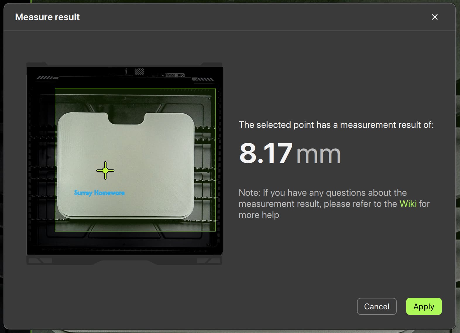

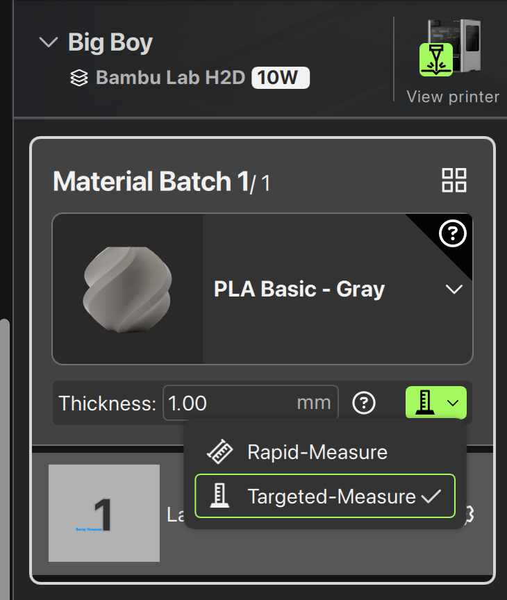

  1. You absolutely must, must, must measure your part’s height to focus the laser!
If you just click “make”, your machine will assume that your PLA part is 1mm thick, so the laser won’t be focused and you won’t even be engraving in the correct spot.
In “Prepare” tab, you need to use the “Targeted-Measure” tool to measure the exact height of the place you want to engrave. To do this, first put your part right in the middle of the cutting area. The machine can only measure in the middle area:
Next, click “Targeted-Measure” in the measure dropdown:
Then, choose the actual spot that you plan to engrave, and the machine will measure it for you. This will work best with flat surfaces.
Also, notice that the preview of the part will shift up or down significantly after you measure because the preview compensates for camera perspective. So make sure to reposition your engraving objects after the height is set! Otherwise, your engravings will end up too high or too low on the part.

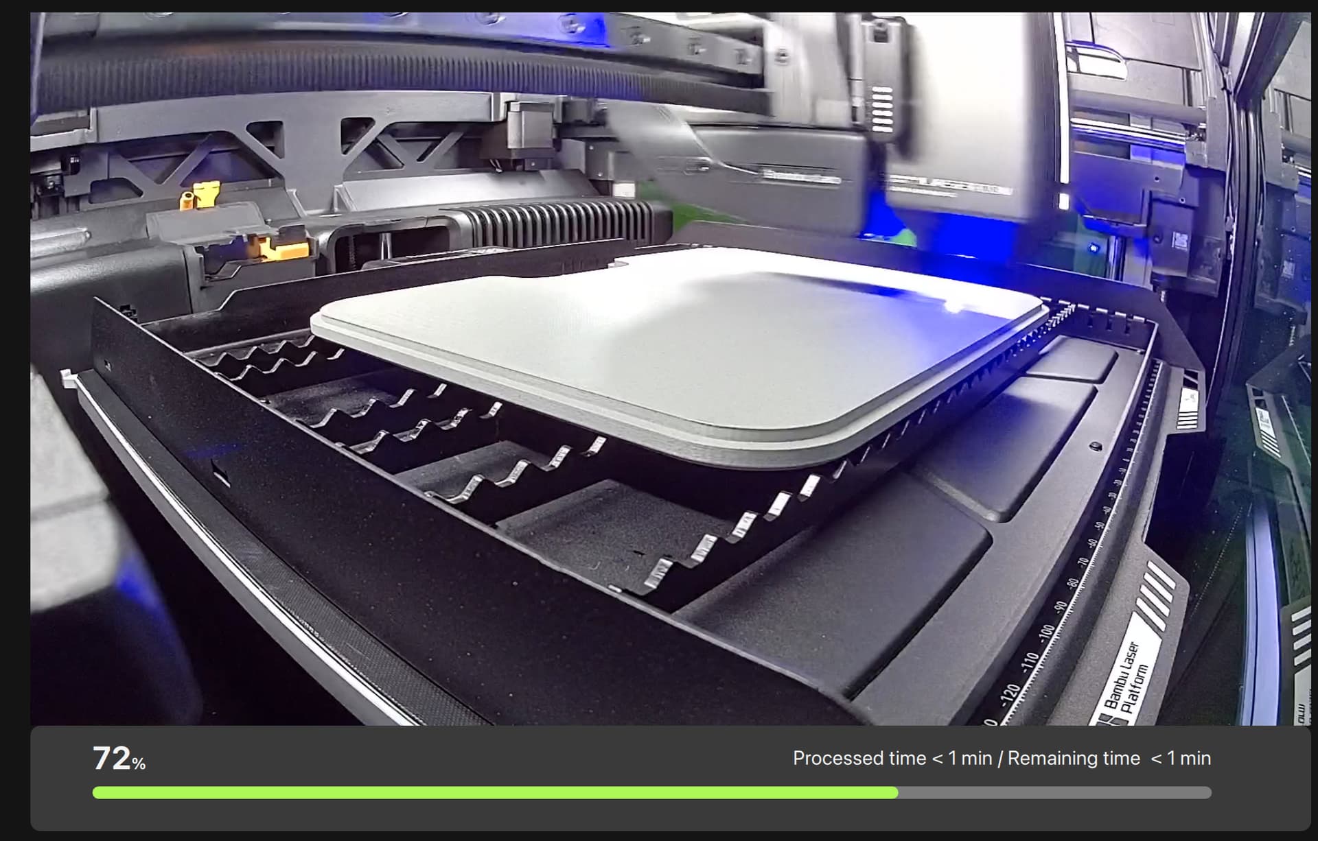

Finally, click “Make” and see what you get!

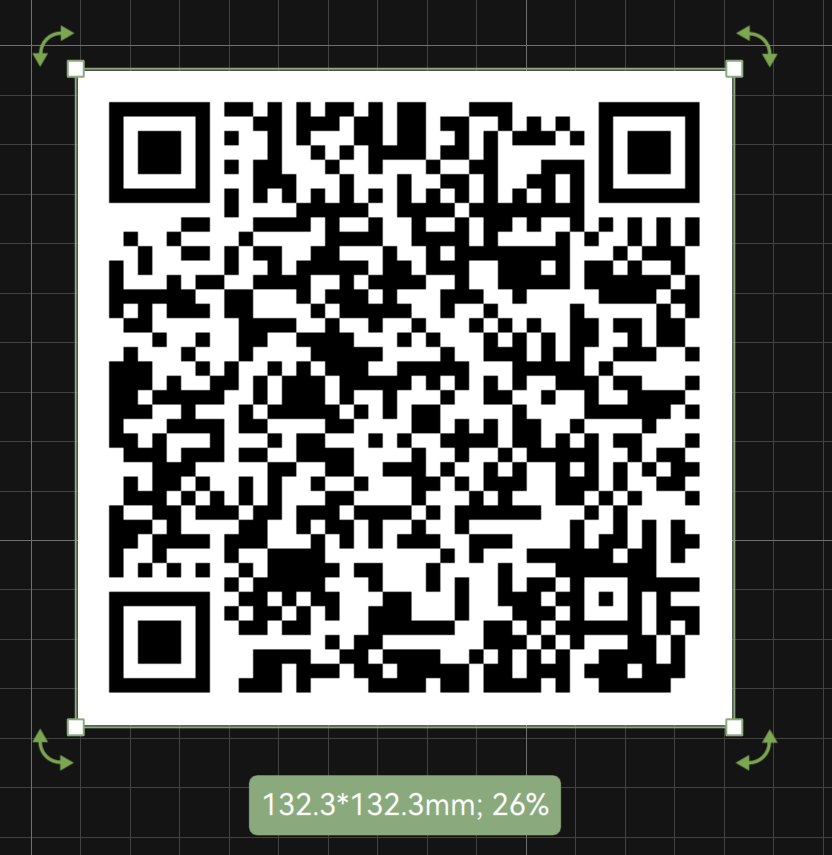

You can even use a QR code generator website to create an SVG image of a QR code and engrave that and get a scannable code:
It might take a few tries to find the right settings. But once you dial it in, you can get some great results.

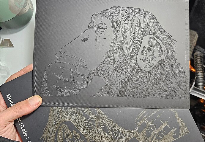

Very cool! Just a heads up, since you posted a qr code, if its for mass production, it may be smarter to just etch a build plate for automatic transfer onto prints This wouldnt make for a smooth surface like yours, though. Yours look pretty amazing
So cool! I wanted to try this but I completely forgot! You have to tell me which settings worked best for me to do it without ruining a plate :slight_smile:
I honestly cant remember, but it was a preset(possibly the dog tag one, but dont quote me on that). I dont think I changed any settings. It was done with the 40w
Engraving the plate is a really neat idea - thanks for sharing!

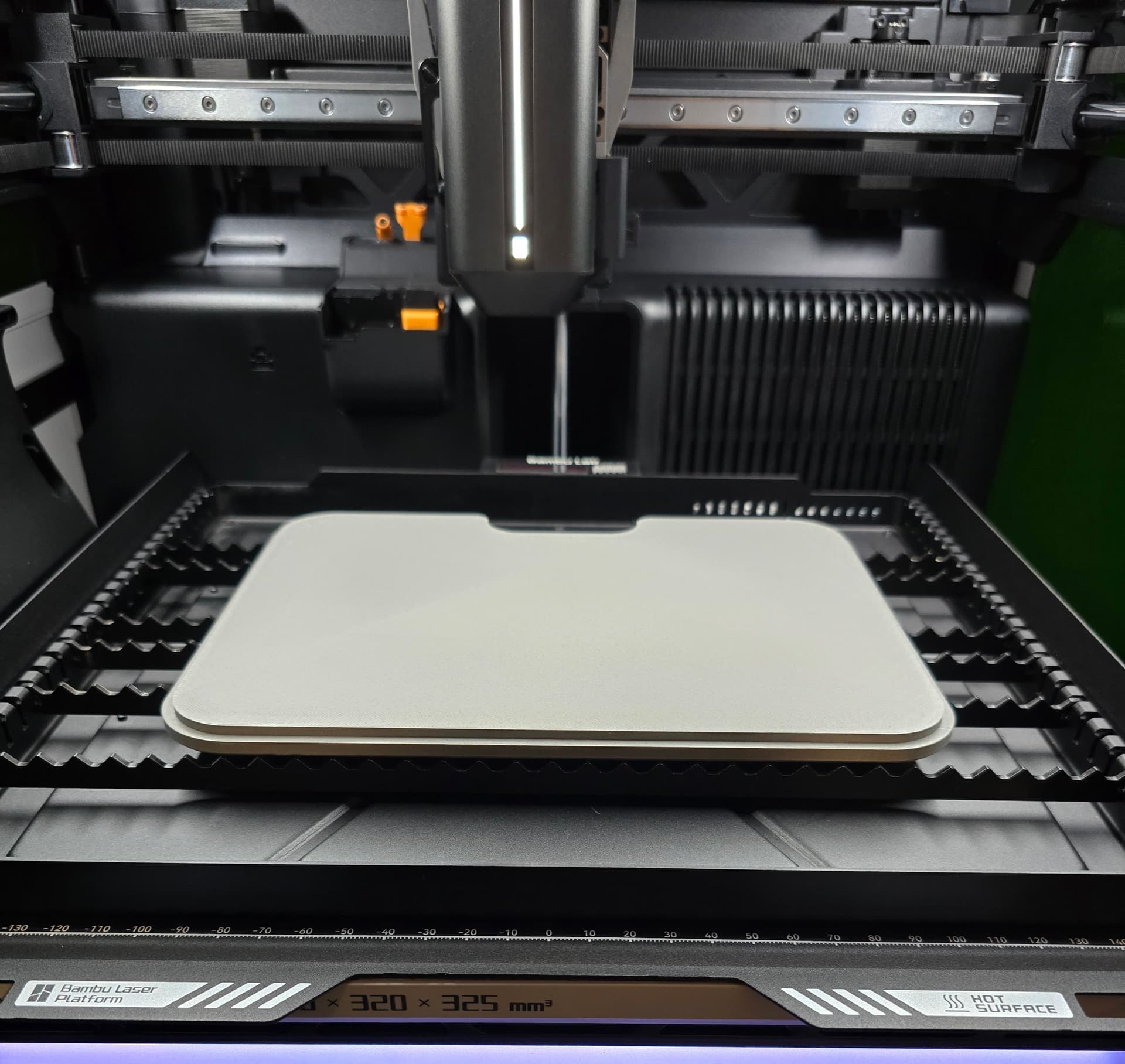

From direct experience, this is not true. it takes several minutes to switch from print to laser mode in the following order:
remove print plate
add laser plate
mount laser module
connect cable for laser
connect air line
route air line on cable chain
calibrate laser
load workpiece
launch software for bambu suite
prepare job
send to machine
wait for machine to prompt for button hold
run job
mandatory 30s exhaust purge.
No matter how fast your workflow is, there’s nothing that speeds up the recalibration on laser mount, sending the job to the machine, and the cooldown.
While it is viable, it is not fast.
Fair enough. I was assuming you’d do a batch of engraving at once so you’d be spreading out the switchover time. But in the worst case of engraving only one part, it could add 10-20 minutes to your production and an extra step that you might not want to do.

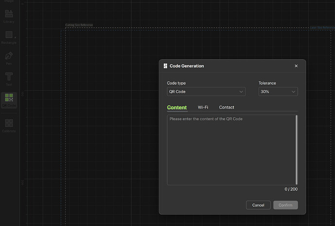

by the way, just a quick note, you can actually create QR codes directly in Bambu Suite, no need to go to an external website :slight_smile:
