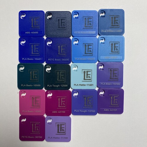

How to engrave your PLA prints with your H2 laser module

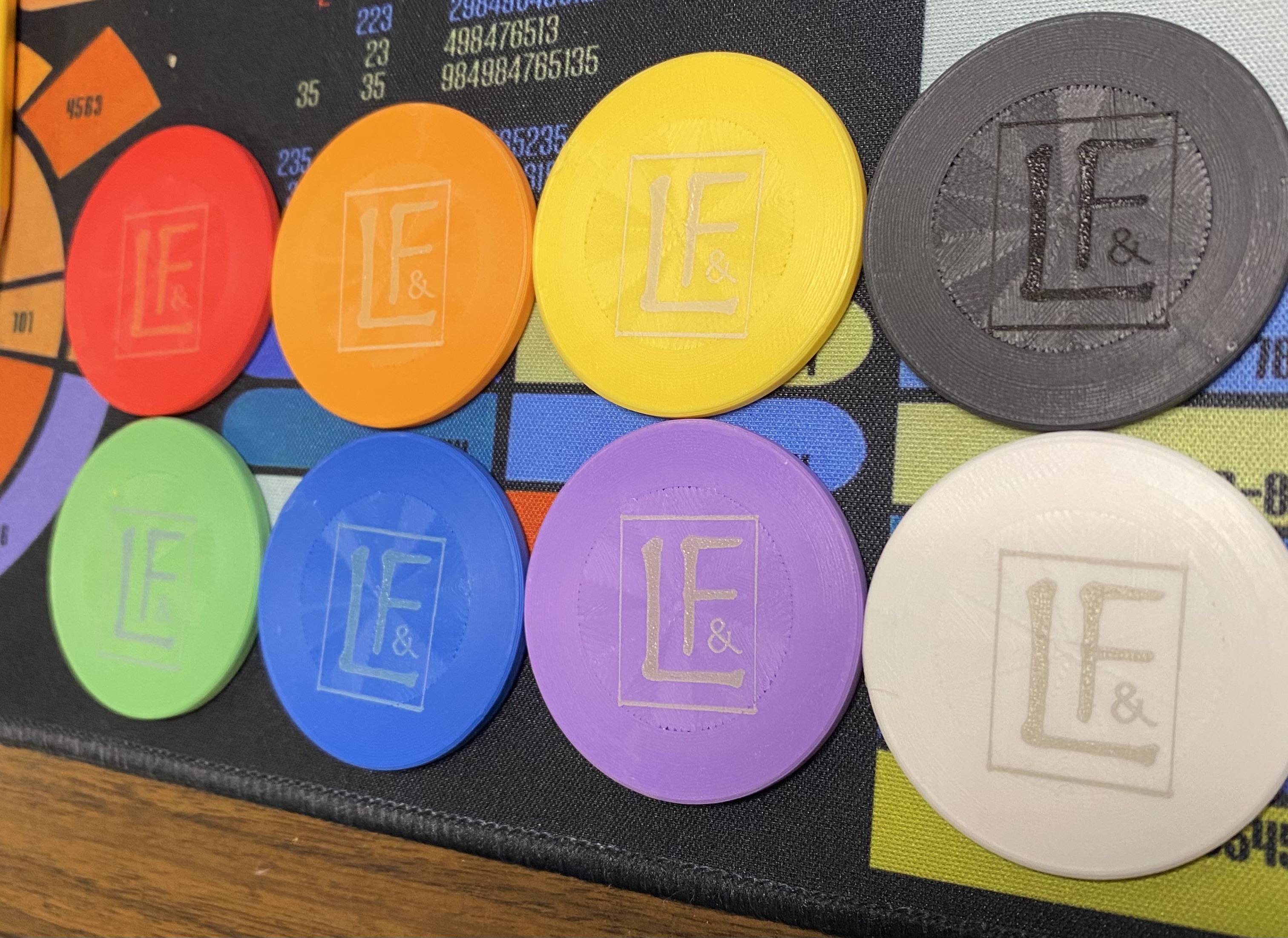

Do you have any pics of how the UV laser did?

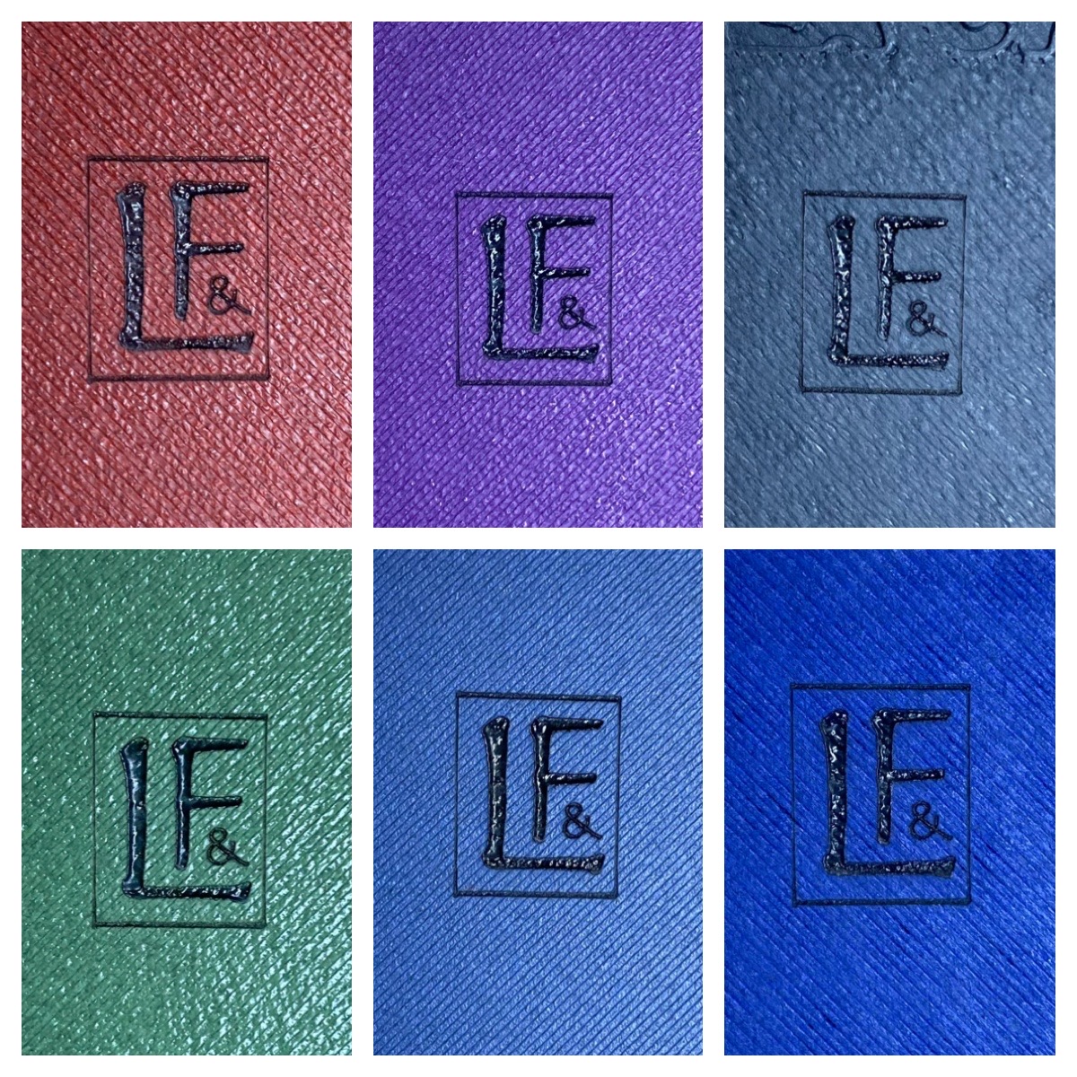

The pokerchips are BL PLA Matte.
The PC is a mix of BL and Polymaker.

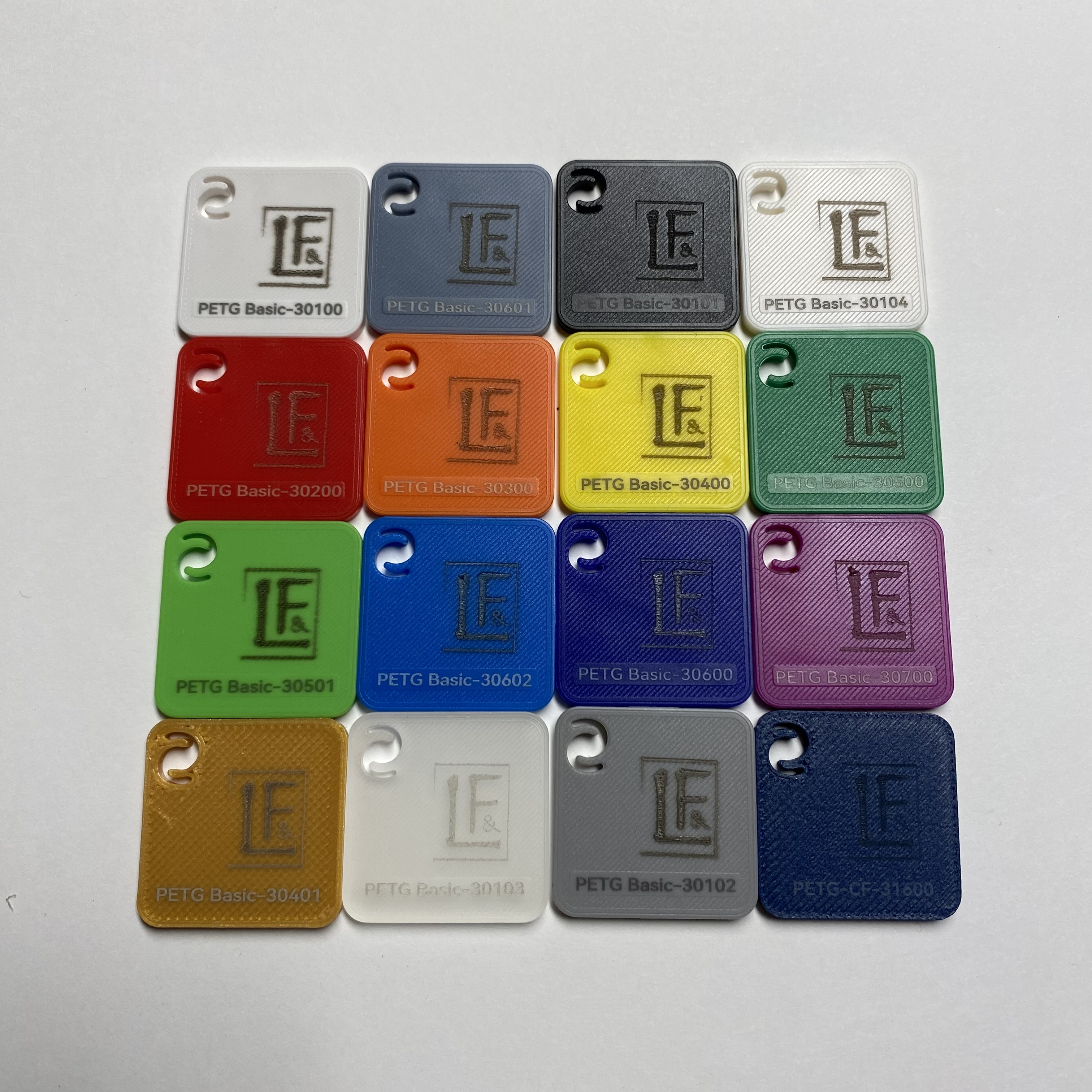

These are PETG and the unmarked are PLA-CF, all BL.

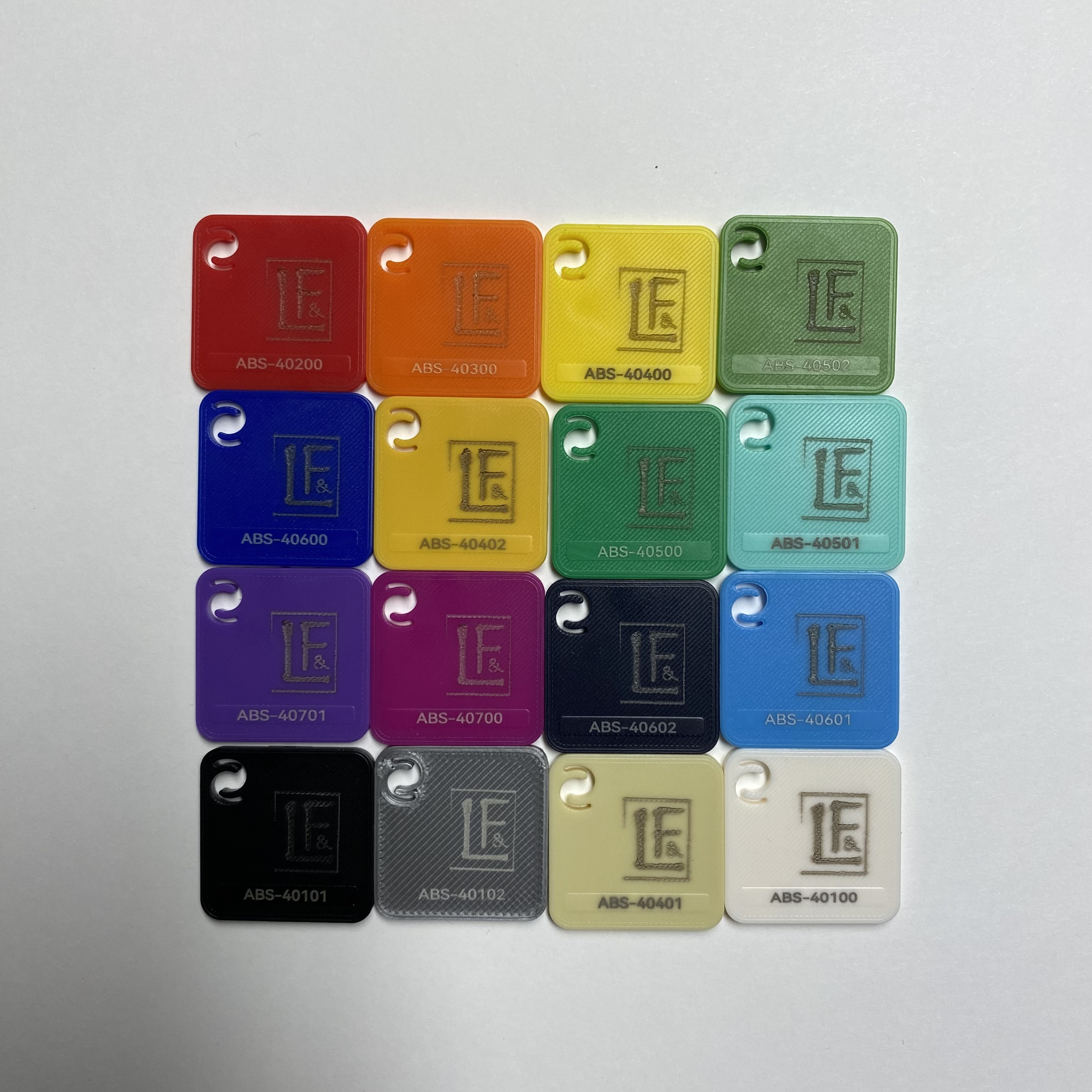

Here’s TPU, Tinmorry brand.
Sweet, thank you for sharing!

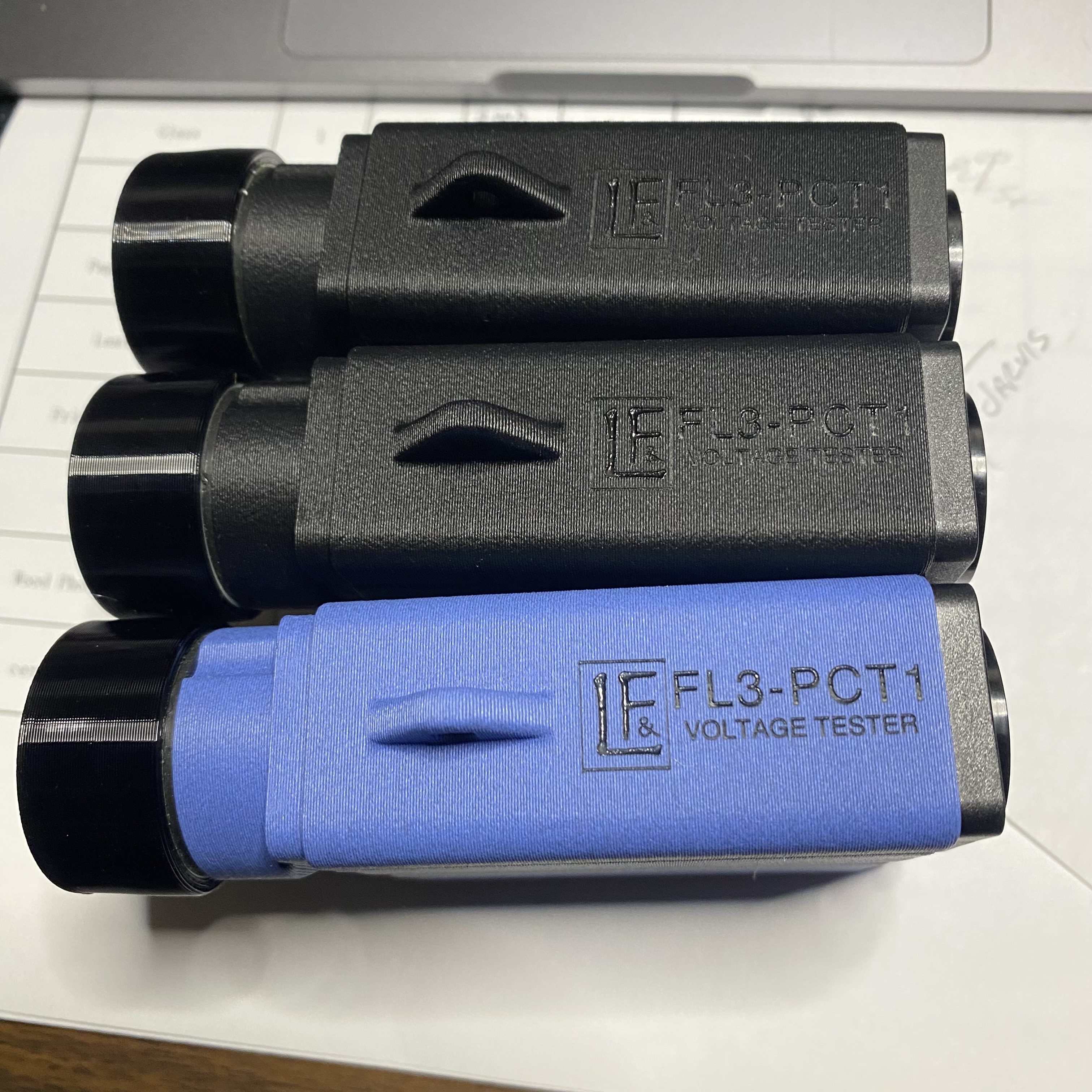

Note that all of the above were done with the same settings and basically became the baseline settings.
All this was done back in Dec 24/Jan25 when I first got the ComMarker Omni 1 and I wanted to make sure that I could indeed mark all colors and all the types of filament that I was currently using, especially the ones for the items that I was selling.
One of the things I’ve since, for my setup, is that for large engravings, I had to orient the fume extraction opposite the direction of engraving, otherwise it pulled the dust over the part and it settled in the newly engraved areas.
Probably not an issue for the H2D as it’s an enclosed environment and the directionality of fume extraction not as extreme in an open system.
