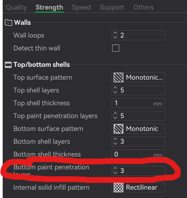

Colors in Bambu studio are done by “painting”. Default settings for 0.2mm profile enforce 3 layers colour penetration - change that to 1 and you will get what you intended without code changes
