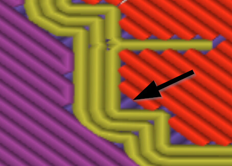

How to get slicer to not add unnecessary loops below a void?
Screenshot 2024-11-12 at 7.54.47 PM
Screenshot 2024-11-12 at 7.54.55 PM
In the first image, there is a portion of a layer where the slicer has decided to put wall loops around that portion. In the second image, you can see the next layer where there is a void in the same location.
There doesn’t seem to be any good reason to put loops there. It just gets covered up anyway. Is there a way to get the slicer to not do this and just make that lower layer continuous?

Thanks for the reply. I’m actually using Arachne. I’m attaching more of the model.

I don’t want to fill the hole. The hole is fine. I just want the lower layer to be entirely rectilinear instead of having superfluous walls in it. This may improve a little bit how the light passes through the filament.

I set the infill to 100% rectilinear, the top and bottom shell thicknesses to zero, and the wall loops to zero. This eliminated those internal walls. For some reason that I can’t figure out, there’s still a wall around the exterior of every layer.
I found an option on the Quality page for applying one wall to the top layer. Turning that off eliminated the walls entirely. The next thing I noticed is that some parts were sparse infill and some were solid infill, which had a different shape. I changed the “Minimum sparse infill threshold” setting to zero, and now everything is 100% sparse infill (which is set to rectilinear at 100%).
