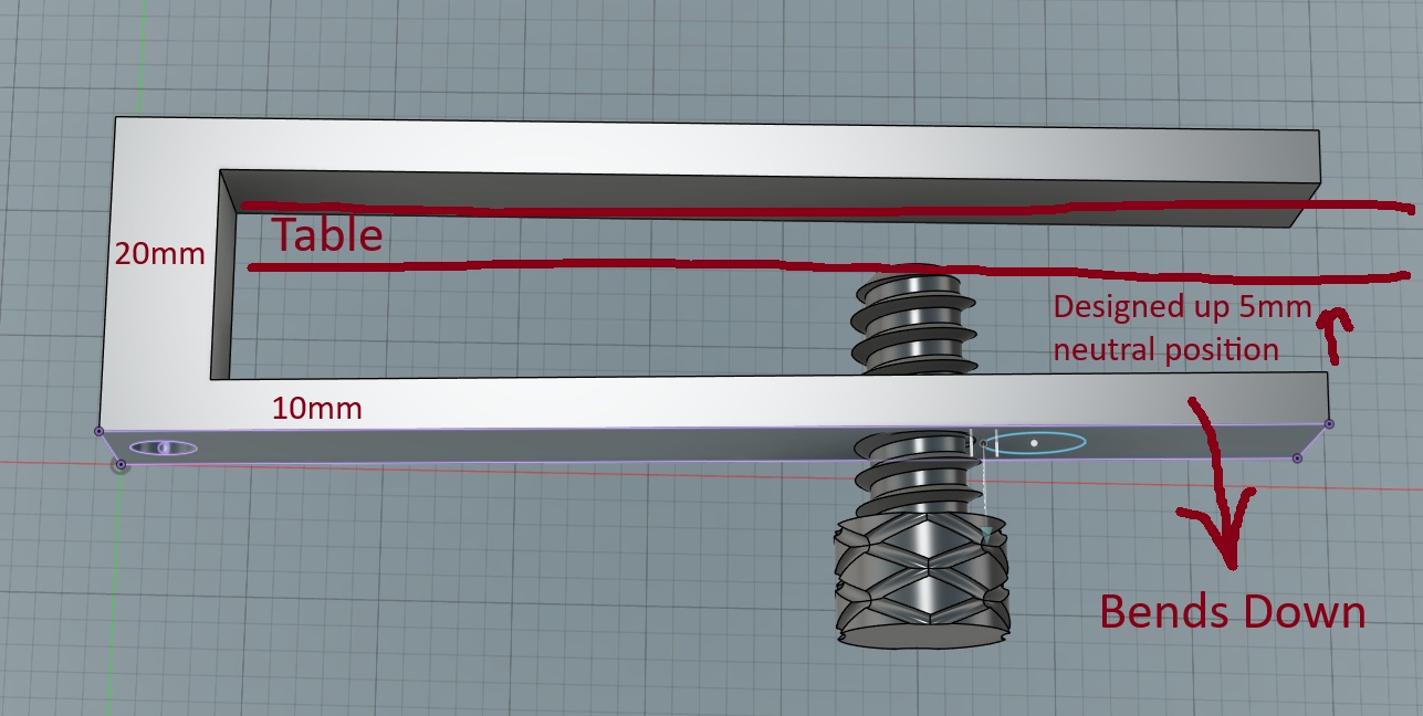

This is a U bracket that fits on a plastic table, which has a desk lamp that sits in the hole on the left and swings around. The bracket that came with it won’t fit on the edge of the table which is plastic and oddly shaped.
I printed this in PLA with the 0.20 Strong profile and 0.4mm nozzle. It works OK, but cannot be tightened effectively. The bottom plate bends down way too easily.
My question is how best to make this stiffer. Obviously I can just make it thicker on the bottom and the left side (the 20mm and 10mm sections), but is there some magic in the four billion combinations of slicer settings that would be worth trying first?
One thing I did (and I can do more of) is design the bottom angled up a bit (it takes a 5mm up now that you can see relative to the red axis under it). I can do more, but it’s just so springy now…
I think the issue is more the plate itself than the corner, though it may be some of each. Are there infills that increase stiffness? There are hundreds of “what infill is strongest” but they seem to be related more about crush strength, which may not be the same as being flexible (or not).

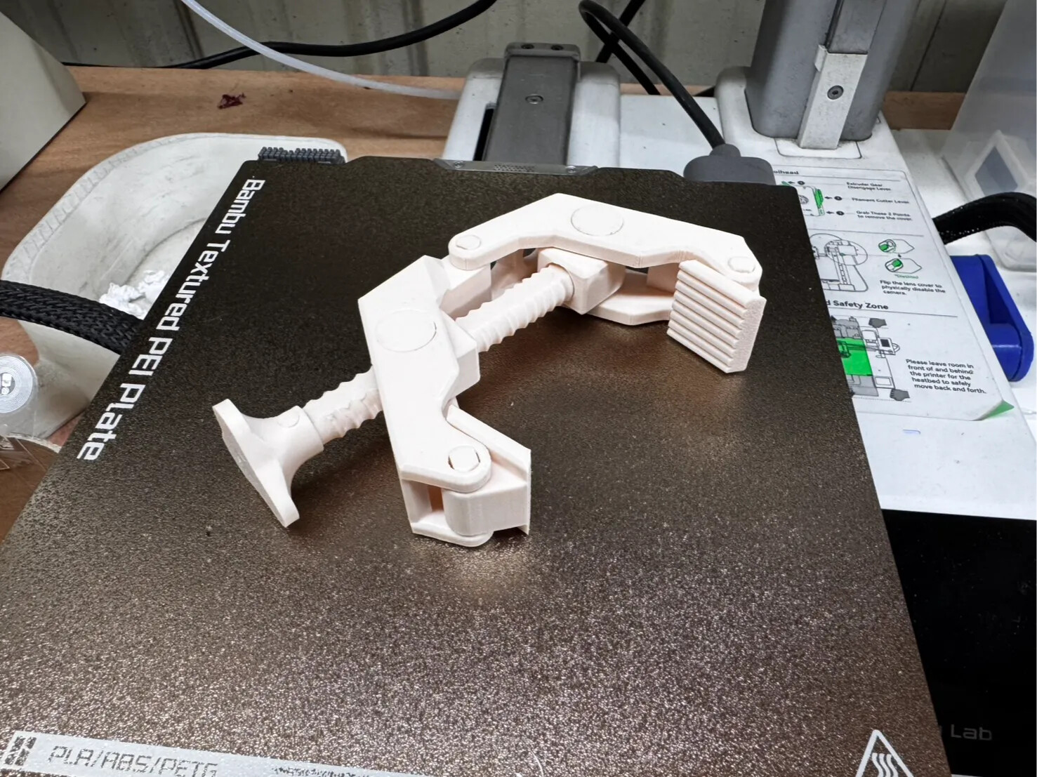

I don’t see a way to make it significantly stronger. The problem is simple, even uber thick plastic stretched out over a span will always bend. Depending on how much force you need to resist, the only option is to go thicker and thicker.
On a different note, changing how the clamping force is distributed, you can increase the gripping force substantially, but the design will get bulkier. For example, this design (just for reference, I don’t think it fits your need), can take a lot of clamping force before the arm begins to flex. This is the type of mechanism that might be best to explore.
Super Clamp on MakerWorld

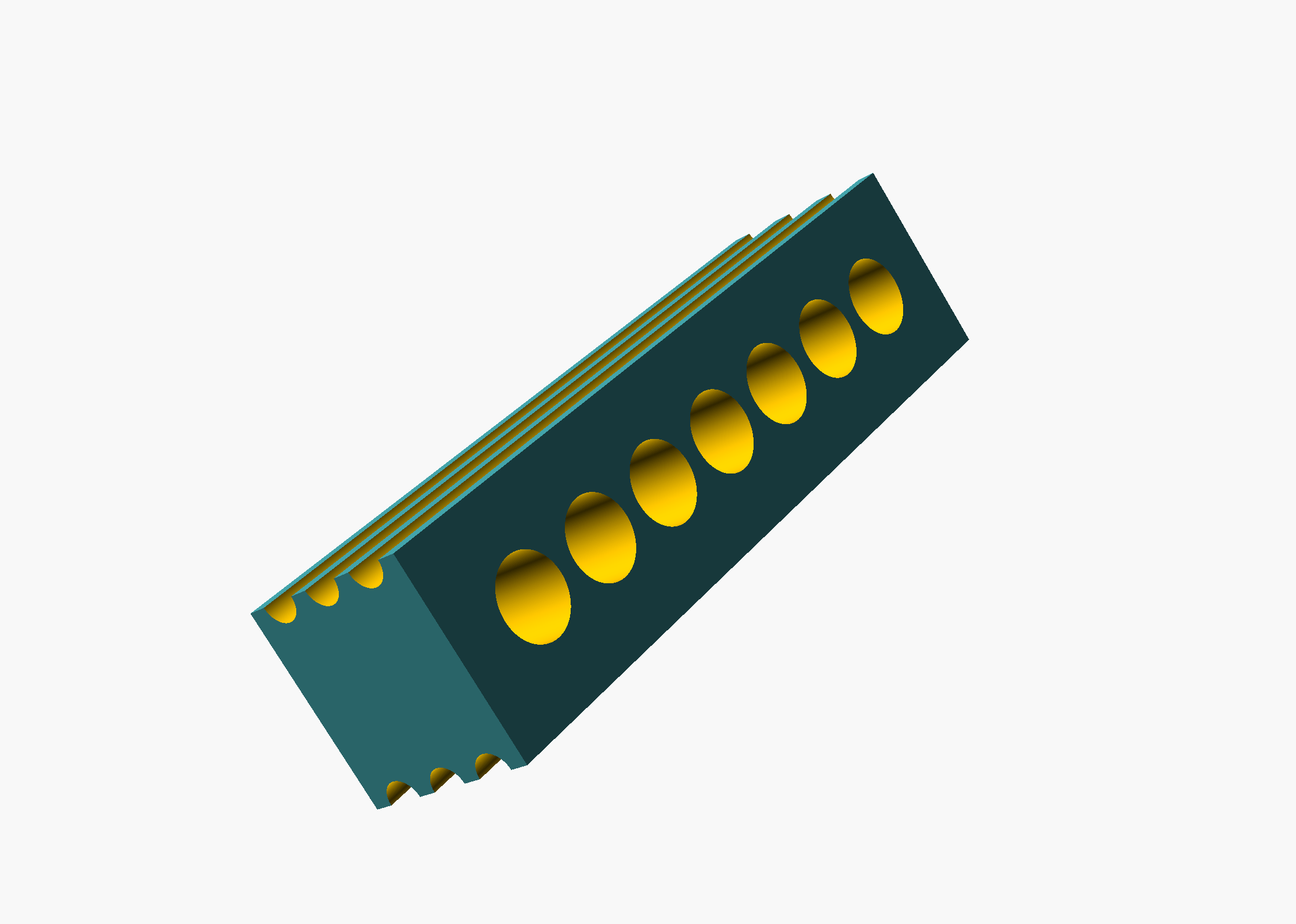

Add some boolean cylinders into the surfaces, small diameter ones that you can add, say, five or more across the top and bottom rectangles on both the top and bottom surfaces. These bring the sort of benefits that corrugated iron sheets gain.
Maybe remove some material in the middle. Imagine taking a cylinder through the side walls of half the thickness, think Swiss cheese. This adds strength in the same way bridges gain strength from girders and trusses.

The holes (Swiss cheese) add walls which aid in both compression and expansion when being stressed. It adds strength and lots of it when applied correctly.
It also forces infill to bind around the holes, adding more strength.
Adding cylinders that run the length of the top and bottom surfaces (think corrugated metal), which are cut out from those surfaces adds strength. You boolean them at the centre mark of the cylinder, half outside the surface, half inside.
You have likely seen this effect in cardboard boxes (the better ones have this as their internal walls, some biscuits (cookies) are packed with them as tubes surrounding the tasty goodness. If like me you have walked on corrugated metal, you understand the benefits.
Update
A quick and (very) dirty mockup of an extreme, but, basic example.
Remember, this aims to improve a basic set of rectangle rather than a whole design that offers differences in where the forces are exerted.

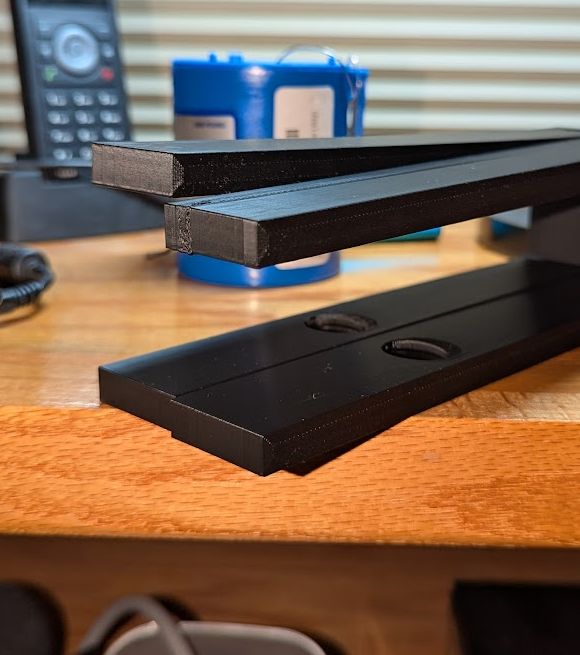

So… I’ve got stuff to do this morning but the reprint with new infill and some softening of the rectangular corners printed. To my un-calibrated fingers I do not sense a difference however there is a wrinkle in trying to tell.
The original was mounted over night (so maybe 16 hours total) stretched a bit. It is now permanently stretched, clearly it doesn’t behave in an elastic fashion (I guess it is, well, plastic).
Here is the original (left) and new (right). They would have been identical shape when printed, the new is 166g vs 111g so the infill added a lot of mass, but the original has been now distorted enough I am not sure there is a meaningful way I can measure its stiffness to compare. Not to mention I don’t have any good tools to do so. Maybe hang a known weight from each and compare change in opening size?
But it’s clear plastic in this design is not a good way to clamp, it’s stiffness is not only poor but really inelastic.
It does give me some indication of where the bend is – the back sides (old in background in this shot, new in front, bases precisely aligned) shows it has been bent on the back side and/or bottom corner. The actual arms sticking out, if I lay a straightedge along them, shows a very slight rounding on the old, but not nearly enough to account for the displacement – that’s coming from the “U” itself opening up.
That’s not to say that is where the flexibility is coming when I tighten, but that’s where the long term failure to maintain that shape is originating, which kind of makes sense given the leverage the long arms have. Which likely means modifications (e.g. as recent posts) to make the arms stiffer will just exacerbate the long term distortion in the “U” and it would need to be a lot larger/strong/different also.

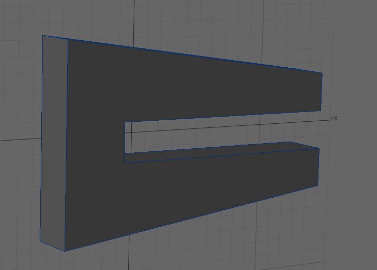

PLA is the wrong plastic for this. You need a plastic with a higher glass transition temp, stiffness and lower viscoelasticity. PEEK or PC or PA6-CF/GF or ABS-CF/GF. In that order.
You also want a shape kind of like this:
And if you aren’t limited by the space where this goes, make it much, much thicker.
Goes without saying, 100% infill. Wall count won’t matter.
Also, since the part will be under tension, you could “print in” some compressive force to compensate a bit. I exaggerated the idea so it’s clear in this picture. Make the open end a little narrower than the closed end.
