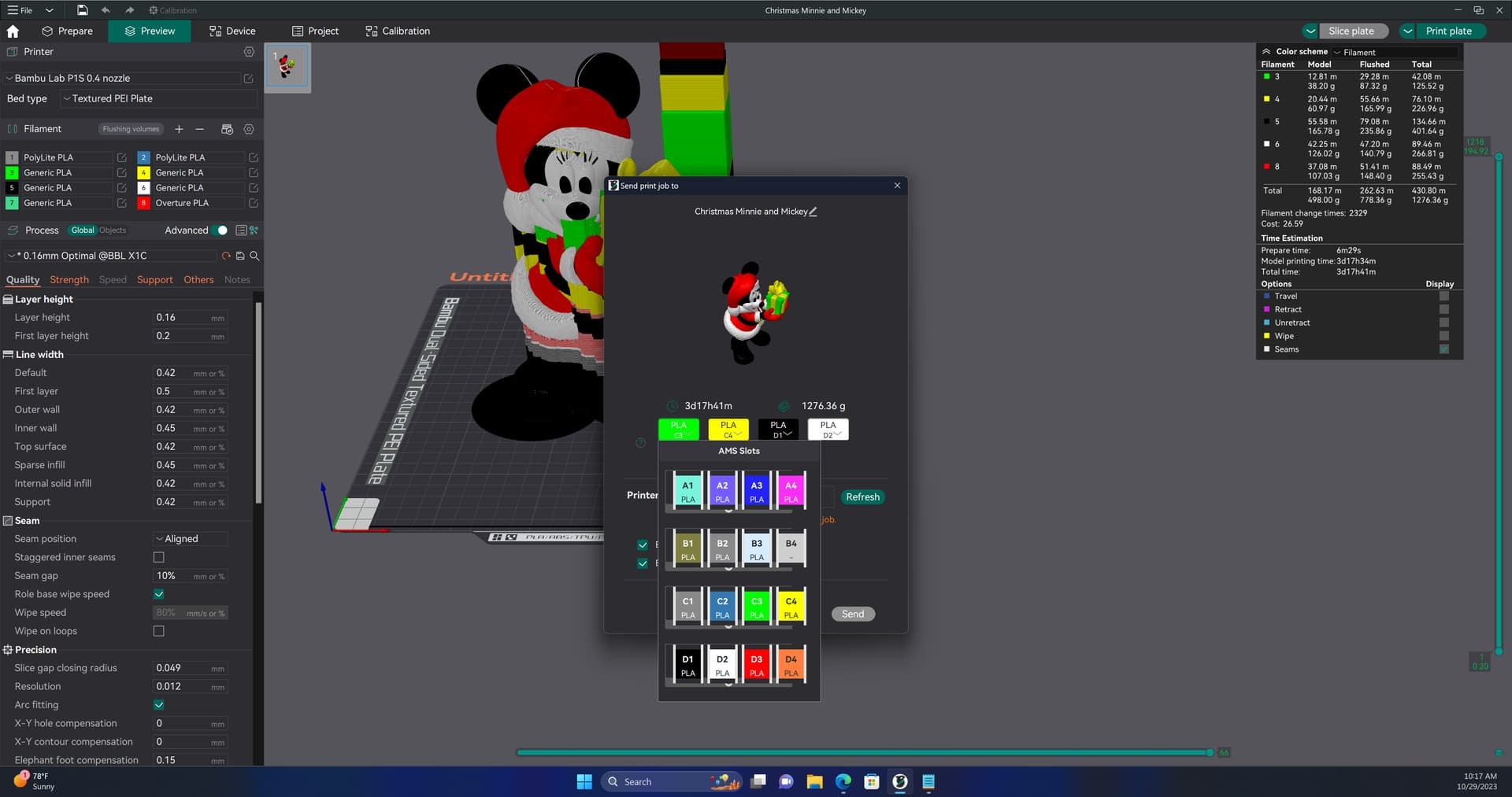

When importing a model from Makerworld with color, the colors are preset in whatever AMS slot the designer selected. I usually have to move around my filament to match the designers choices.
Is there a way to import a model and then change the color? Meaning, if a model has 3 colors, AMS 1,2 and 3. Can I change the orange from AMS slot 3 to AMS slot 1 and keep the model colors? It seems when I change filament like that in BS, the model loses all color, and I would be forced to repaint.
Reason for the ask is one model has 8 AMS slots and only uses 3 colors. The colors are in slots 1, 5, 6. I don’t have a 5 and 6 so I want to move them to slot 3 and 4.
Look at these and see if it helps make sense
You can “rewire” digitally what spool it pulls from in the AMS, you’ll need to repaint the model if you want to change certain places that are the same colors that the MakerWorld author marked as the same though
Ref: P2S with AMS 2 Pro with Generic PETG
