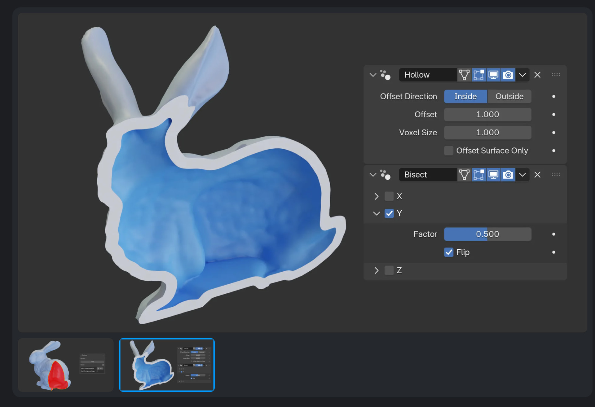

Just a quick tip: Try this toolbox for Blender that’s designed specifically for this purpose.
Unfortunately, Meshmixer is pretty outdated when it comes to repairing 3D models - it reaches its limits very quickly and offers very few options. That’s why I recommend switching straight to the professional Swiss Army knife for this kind of thing.
It can also repair models that Meshmixer can’t handle.
Another difference is this: The tool I’ve linked to can repair the model in various ways. Meshmixer, on the other hand, reinterprets the model - although they call this process ‘repairing’. Sometimes, you just want a proper repair rather than an interpretation. It’s not that one way is worse than the other; you just need to be aware of it.
That’s why I personally stopped using Meshmixer - it’s nice for casual users, but as soon as you have models with real defects, which unfortunately happen very often with 3D scans, you simply need professional tools. Which, by the way, doesn’t mean they’re harder to use - it only takes a few clicks, too.
