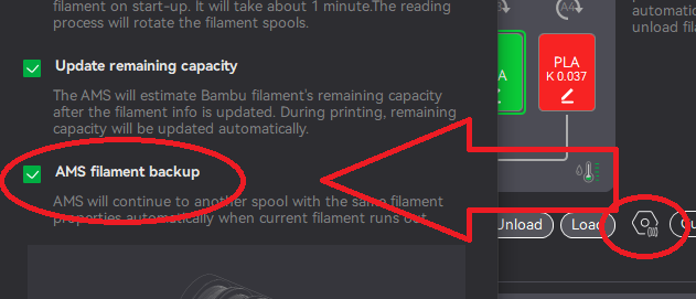

As I understand it, needs to know a) its on (auto refill) and b) understrand all the slot \ failament types and whats the “backup slot” etc, so cant really do it “mid print”.
Some thinking ahead, I guess turn it on now ASAP and should work in future, if it not a full on jam … and you cut the filament and it hits the run out sensor, and all the filaments are configured to be the SAME and the AMS things the SLOTS are the same at the time you “Sent it”- in theory should work.

Setting is here if you didnt know

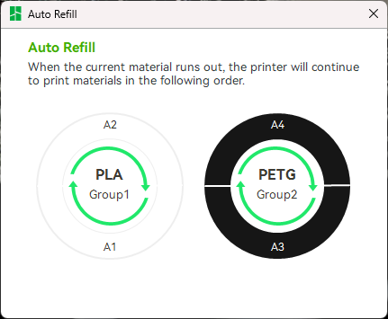

You have to configure this in the slicer at print start.
In the below example the same filament is in slot 1 and 2, and 3 and 4.
When slot 1 is running empty it will continue to slot 2, same for slot 3 switching over to slot 4.
