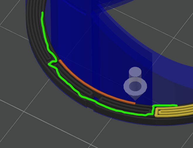

Finally i’ve managed to print almost as i was willing. solution was inspired by [user_3026326371] but still there is a question left…
as you suggested, i’ve created in fusion 360 body inside the other body, which allowed me after parts separation in bambu studio set only walls for outer body and only infill for inner body.
This gave me results as on picture. the only thing i’m struggling with is that the inner wall if external body is not printed in continuous way and i’m not sure how to adjust it.
Even though the orange line is a part of outer body it is printed separated separately…
anyway, i’ve changed my idea a little, so luckly i’m not going to be very worried if solution for that won’t be find. i suspec that if that inner wall would be thicker it would be printed continously…
thanks for all help!
