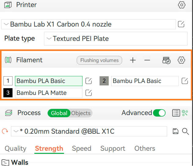

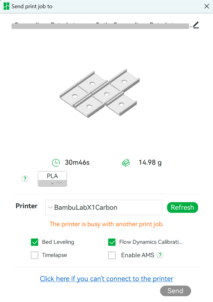

Hi, I have a X1 Carbon with AMS attached.
In the past I just printed with AMS without any problems.
Now I wanted to print using an external spool with BambuLab TPU 95A HF.
But I don’t know how!?!

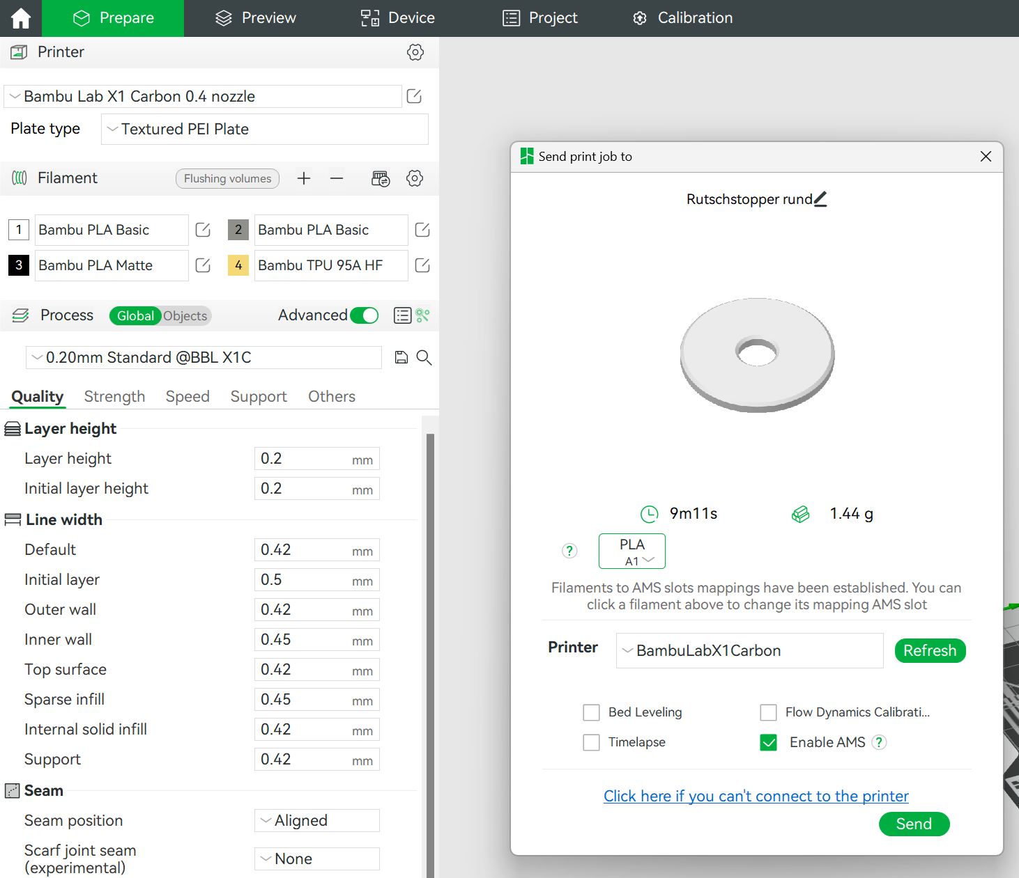

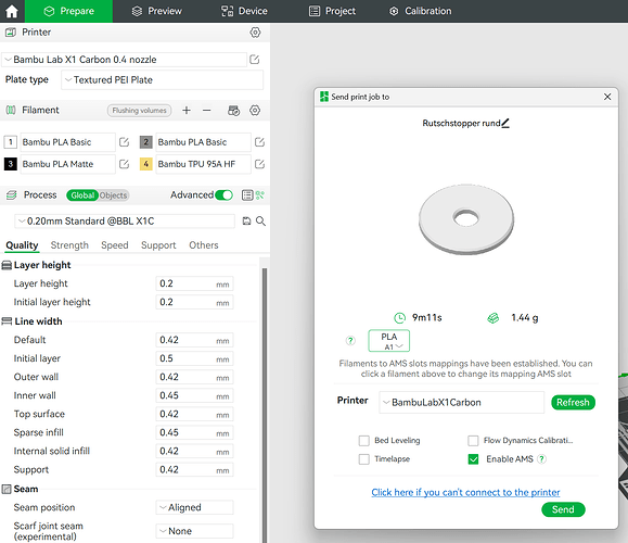

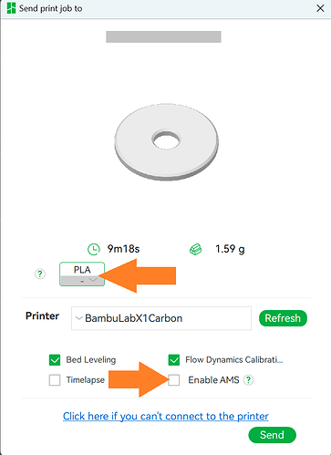

In the ‘Prepare’-section I just see the AMS settings:

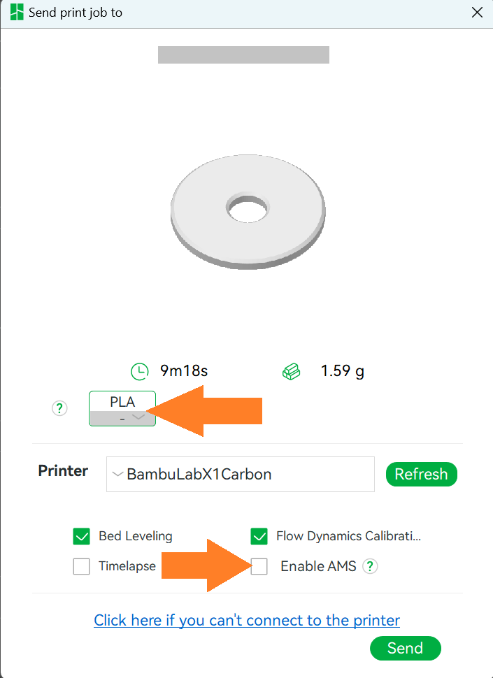

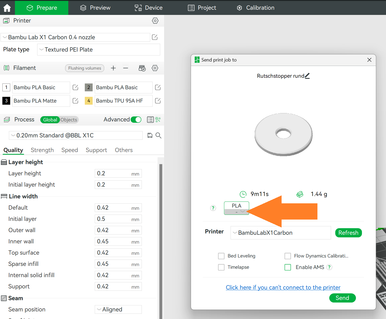

I already disabled AMS but the dropdown box to change filament is inactive.
So how please do I print with an external spool?
Why it is so complicated in BambuStudio?

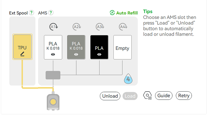

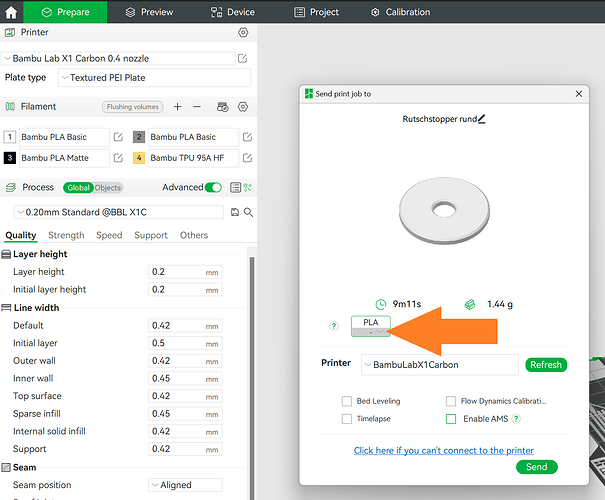

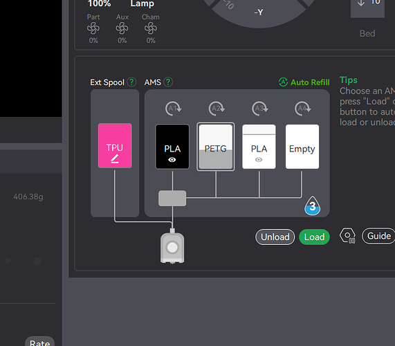

Even though the filament is shown as “4” it is still external. The external spool will always be the last number regardless of how many you have in the AMS.
As you can see the filament is PLA and not TPU. I cannot change it since the dropdown box is disabled.

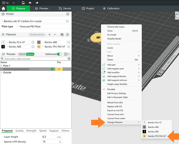

It seems in your 2nd screenshot you chose the TPU filament somehow - but the screenshot is cut on the left side.
Do I have to choose the filament under the prepare tab? If yes where do I have to choose it?
Short version
At that screen, just press Send and it will work.
Longer version(with explanation)
Uncheck the Enable AMS option, then ignore the Filament selection.
For reasons I cannot comprehend, this is the correct process.
When you choose Send it will automatically print to the external spool and you are responsible for making sure it matches the one you chose in the slicer.
The matching options underneath each Filament are ONLY used for the AMS choices.
This has confused and caught me out more than once and I often use the external spool for TPU printing.

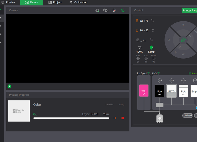

I doubt that this works if I just hit ‘Send’ since the material, as you can see on my screenshot is set to ‘PLA’ and this is used for printing I guess. On the homescreen of the printers display I see a white print object, but in the ‘Device’ section of Bambu Studio I gave the TPU a yellowish tint.
Anyway I did it, I pressed ‘Send’ and the printer moves very fast across the buildplate. I believe that the printer ‘thinks’ it is (still) PLA on the external spool.
As I know for TPU the printspeed is much slower.

I still miss that last piece of the puzzle:
→ Where please do I choose the filament (in the slicer as you said)?

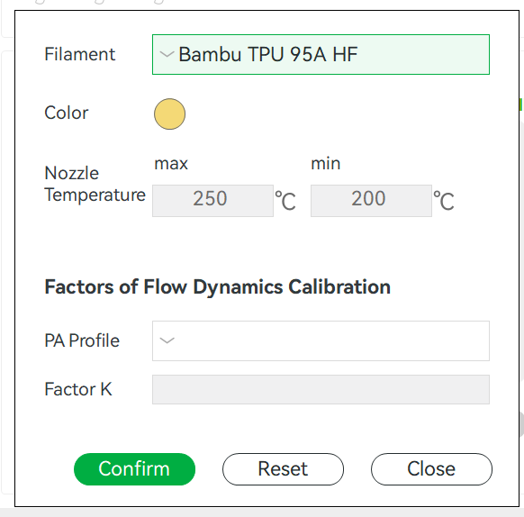

I think it’s done on the 2nd screenshot from @johnfcooley. But this screenshot is cut on the left so I cannot clearly see.
You never said you hadn’t selected the material like you would have done when using the material.

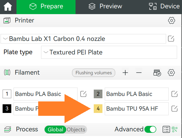

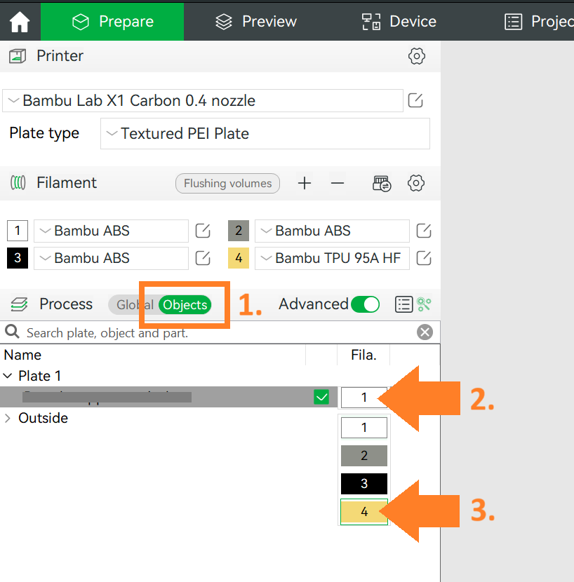

That is also easy, by pressing the number of the filament when you have selected the object it will be assigned the filament you have in that number slot, you don’t have to deal with that weird drop down.
Either way, pressing send would have got you printing as I said previously.

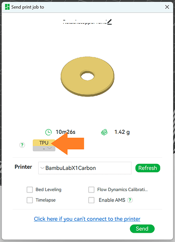

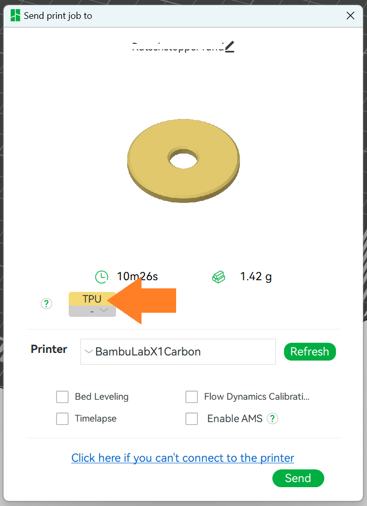

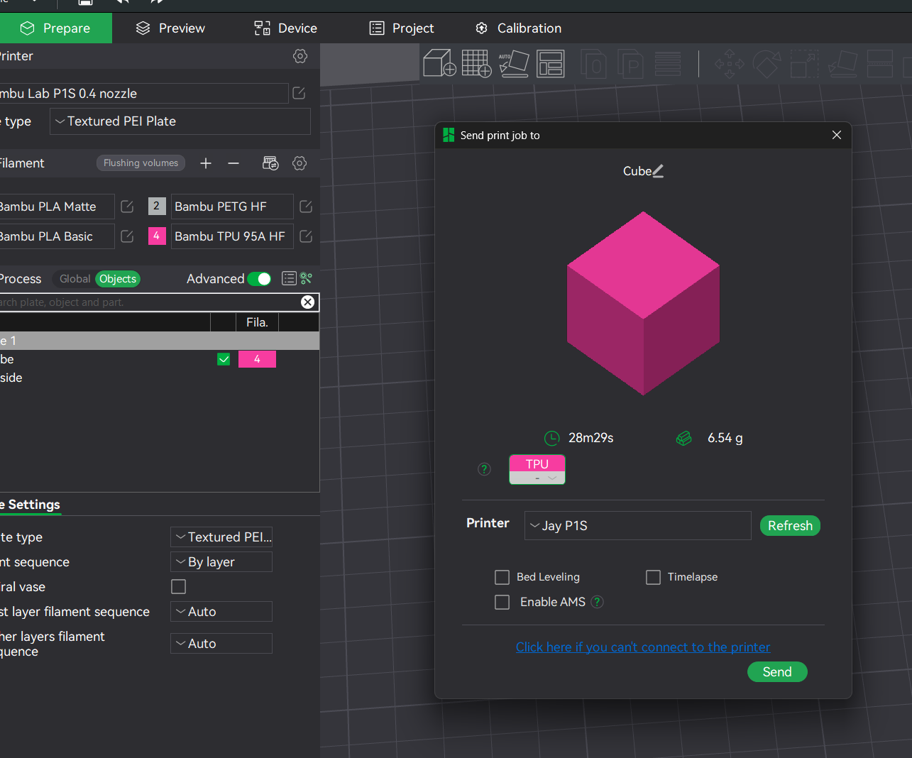

In my case on the viewport in the ‘Prepare’ tab I selected the object I wanted to print (from external spool) and then pressed ‘4’ on the keyboard to get my TPU filament selected for that object.
The object gets the yellowish tint and in the ‘Print plate’ dialog the TPU material is selected - great:
