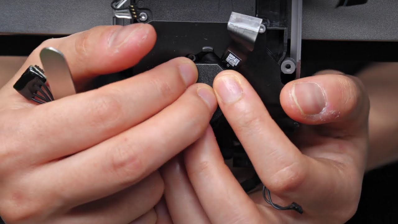

Yes, but those instructions do not include the other end of the FPC cable… it runs thru the toolhead and connects to the back of the extruder…
I was able to get it connected with a lot of fine hemostats and tweezers…

No pictures, but I did find videos how to on the toolhead disassembly (the link Bambu support sends does not provide enough detail or it just includes removal of the part cooling fan)
The parts to replace are these two cables: Toolhead Sensor FPC Cable | Bambu Lab US Store
It is really one cable, split into two and then broken out.
I will say that removing the X axis from the H2D is worth doing, it will reduce your frustration since to replace the cable (which includes the FPC and hall sensors), you can do it here…
How to remove X-axis (if you find yourself struggling with access to the toolhead:
Toolhead disassembly/assembly videos:
and
I will note that after replacing these cables, the printer is running fine.

So, there are two issues here… you need to mount the cable to the back of the Extruder plate… (the cable has adhesive and you will need to remove the part cooling fan and the circuit boards on the back to disconnect the extruder and filament selector motor cables, pull the extruder plate with the extruder stepper motor and then remove the cable and replace it…
I actually removed the entire X axis to work on it, I could not fit and maneuver inside the cabinet…
My cable looked undamaged as well, but since replacing it I have had zero issues.

You only have to remove the board right under the part cooling fan and the Extruder plate where the stepper motors mount… but you have to take a lot of screws out to get there…
