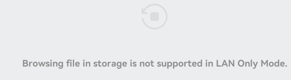

I was under the impression that by default, print jobs did not get saved to the SD card, I thought it was an option I had to select to save the print job to the SD card. I don’t recall seeing any print jobs on my X1C’s SD card.
If you’re a curious type, in LAN mode, you can connect over FTPS [note: not SFTP] over tcp/990
username “bblp”
password is the accesscode from LAN mode
You can build an automation to go in and nuke dirs.
