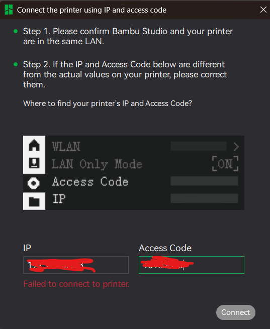

When I try to send a plate, it asks me for the IP, when I put in the IP which I have double checked and tried multiple times, it tells me that it is unable to connect to the printer. I have verified that they are on the same Wifi. Now I disabled and enabled LAN only mode and it is giving me an error saying printer is already bound when I try to send a print.

I have this same exact issue. I wish I knew what the fix was.

Sadly still haven’t found a solution, tried changing the access code and disconnecting and reconnecting the printer to Wi-Fi but nothing worked.
