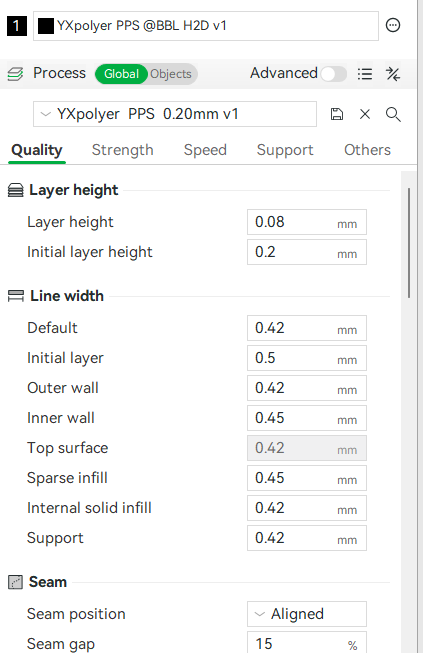

How to toggle-on "Advanced" in filament and process profiles?
I’ve enabled developer mode, and that didn’t help.
The “Advanced” switch doesn’t budge when I click on it either.
It must be something obvious that I’m overlooking. What is it?
Answering my own question: I have to disable developer mode in order for the advanced settings to get enabled. Apparently they can’t both be enabled at the same time. Makes no sense to me. Go figure.
If you have developer mode on, you automatically have advanced on.
Strangely, the advanced toggles get greyed out in developer mode.

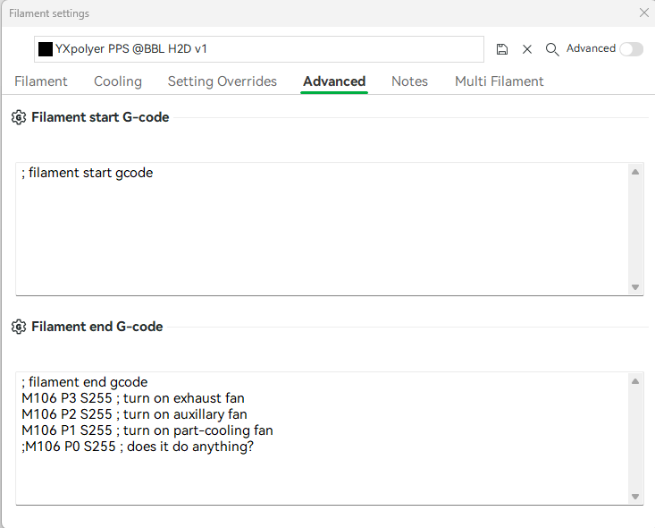

Can you confirm whether my filament end gcode (OP screenshot) is correct? It doesn’t seem to execute. I want it to turn on all the fans when the print is finished to speed up the cooldown and thereby speed up the print release from the Glacier plate.
scratch that. Looks like I should have put it here instead:
I just wanted to mention that.
If you would use multi material (support for instance), your 1st solution would give weird results.
