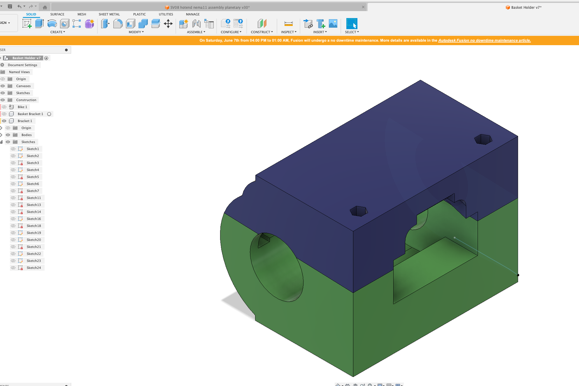

I’ve never really tried them with F360 - but just did a quick test
This test model in F360
Screenshot 2025-06-07 at 11.15.31
File export as obj.

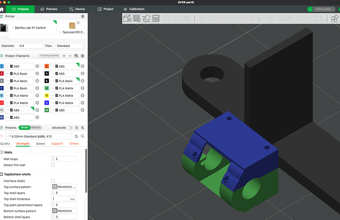

Added into BS - it came up with this screen
Screenshot 2025-06-07 at 11.14.21
And seems to be coloured correctly in BS
