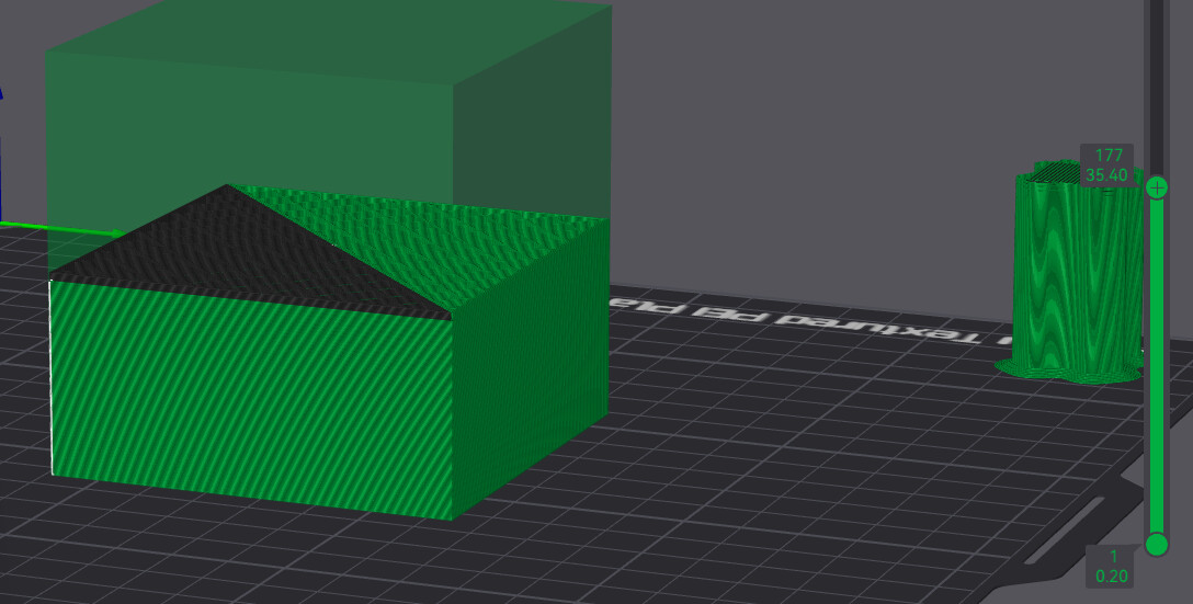

After you slice the model, use the layer bar on the right to get to the layer you want & right click on it to bring up the Menu & click ‘Add Pause’.
You will have to right click Add Pause at each layer change.

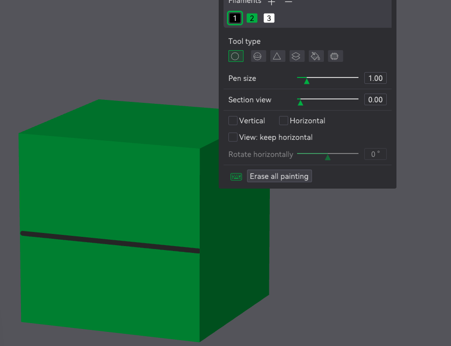

What I did was import the design into studio and left the colors intact. At that point I was unable to add a Pause when right clicking the layer bar and I could only select 2 other settings (not able to check what those settings were because Im at work).
Then I deleted all the colors and sliced the whole thing in just 1 color. With that, I WAS able to add a pause. I guess that will stop the print at a certain layer at let me change filament at that point.
Not sure if that is the way to go, but I’m going to give it a try later today.
With multi colour prints you have the option to delete the change colour (filament) instruction that way you can then add a pause option at the same layer
