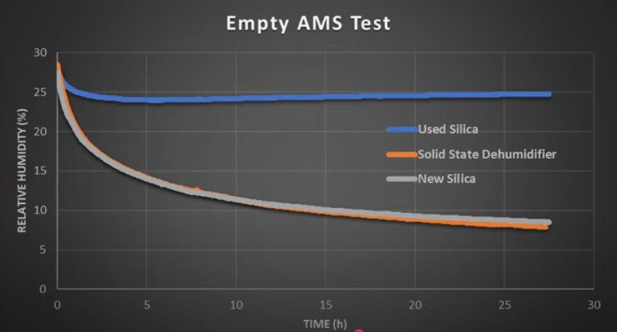

However, I would argue that it is a non-issue. Given time (e.g. 24 hours), the relative humidity (RH) in the AMS reaches equilibrium, e.g., the AMS, the filament and the desiccant all reach the same temperature, the filament has given up all the humidity that it can, and the desiccant has absorbed as much as it can (at that temperature). So the proximity of the hygrometer to desiccant does not make a difference if the humidity in the chamber has reached equilibrium.

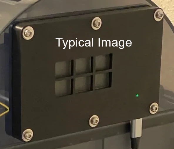

I built my own using SHT-41 sensors and a tiny ESP32-C6 with display. The SHT-4x sensors are as accurate as you get these days.
Actual RH inside the AMS is now measuring 17% RH at 25 °C after a few days of stabilzing and plenty of desiccant all over inside the AMS.
