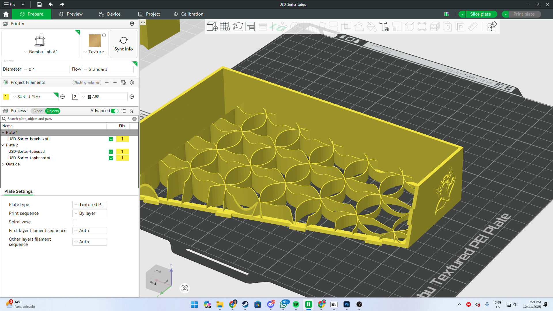

I cant print objects. it shows a little transparent

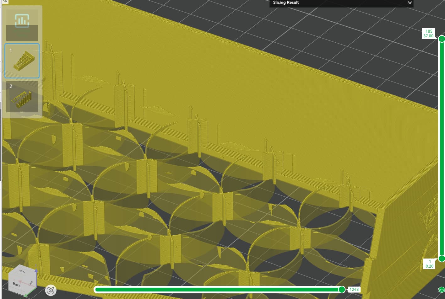

Hello sorry for my enlgish, i have a problem, when i push the preview button previous to print, some parts of my model are transparent, i printed and they didnt print. so could you help me to make that parts printables?

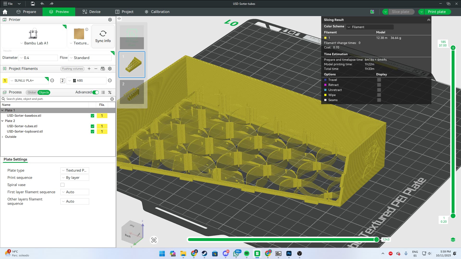

These photos show the problem. i put the object (Not mine) on the plate and then the software renderize transparent and they dont existe in the print. how could i fix that?
thanks.
those lines are maybe too thin to be printed? Use the measure tool, how thick does it say?
There is a minimum line width and features under it get ignored
Another thing to try is Arachne wall generator, which provides a smaller minimum line width
