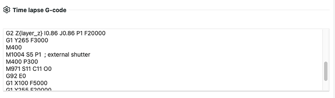

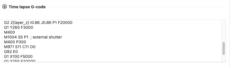

You could delete the timelapse section of gcode from the printer profile.
That should do it.
I have not tested it personally.
- Edit the printer
- Navigate to the GCODE section
- Scroll down to timelapse
- Delete (you may wish to save the GCODE block in case you wish to restore it.)
